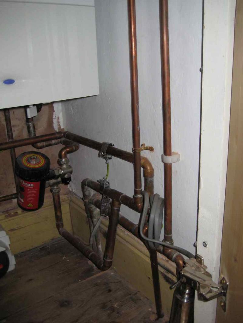

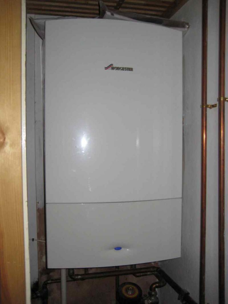

As promised here are the pics. It all works fine. Flow rate in the bath is greater than with my old gravity feed - only disadvantage is the 30 sec wait for hot at the kitchen tap and that the leccy shower is prone to scalding or freezing if anyone touches another tap/flushes. Will get a thermostatic mixer shower soon.
Boiler:

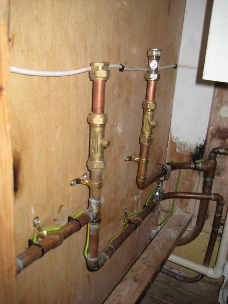

Shower feed:
CH pipes to loft:

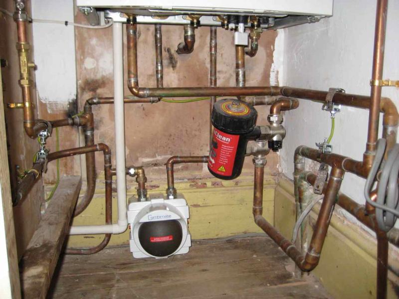

Magnatec and Combimate:
The install went fine (ok they looked to the sky a few times when I kept asking for neat pipework in the cupboard!), but getting the combimate fitted took a further 3 months and two engineers (neither of whom had ever seen one). Not all bad though as I didn't get charged for it in the end as a "sorry".
His quote looked cheaper than the others. A good price and I was happy to pay less and do the pipe clips and supplementary bonding - it seems they don't come as standard.....

Given that it's always more difficult to alter an existing system, I would rate it 3/10 for neatness, and 1/10 if you had to clip the pipes. :eek:
Now who do I know in Leicester, that I've just upset. :(

I don't want to alarm you but that wiring featured in pic2 and 3 which is wraped around the heating pipes is simply not safe and you need to move it ASAP.
J you're such a perfectionist :rolleyes:
It's worth at least 2/10 :LOL:
Oops perhaps I live a bit to close to comment :eek:
