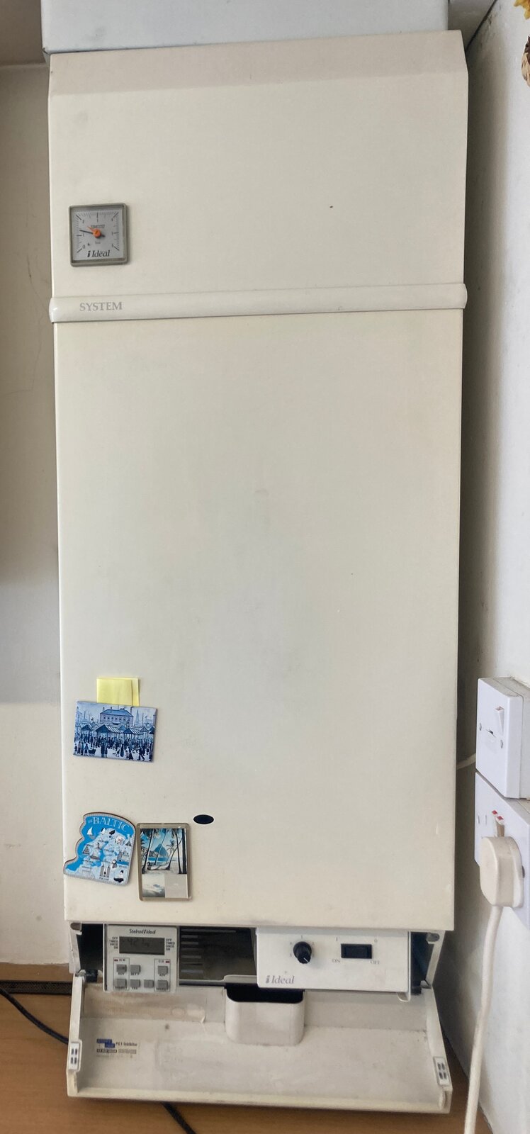

The heating at my 94 year old neighbours bungalow is going to be changed later this year ... in the meantime it seems the only way to get heat to the radiators is to latch the actuator on the three way valve.
Q1. Is it likely I could find and fix whatever is causing it not to work of its own accord.
Thank you
Ray

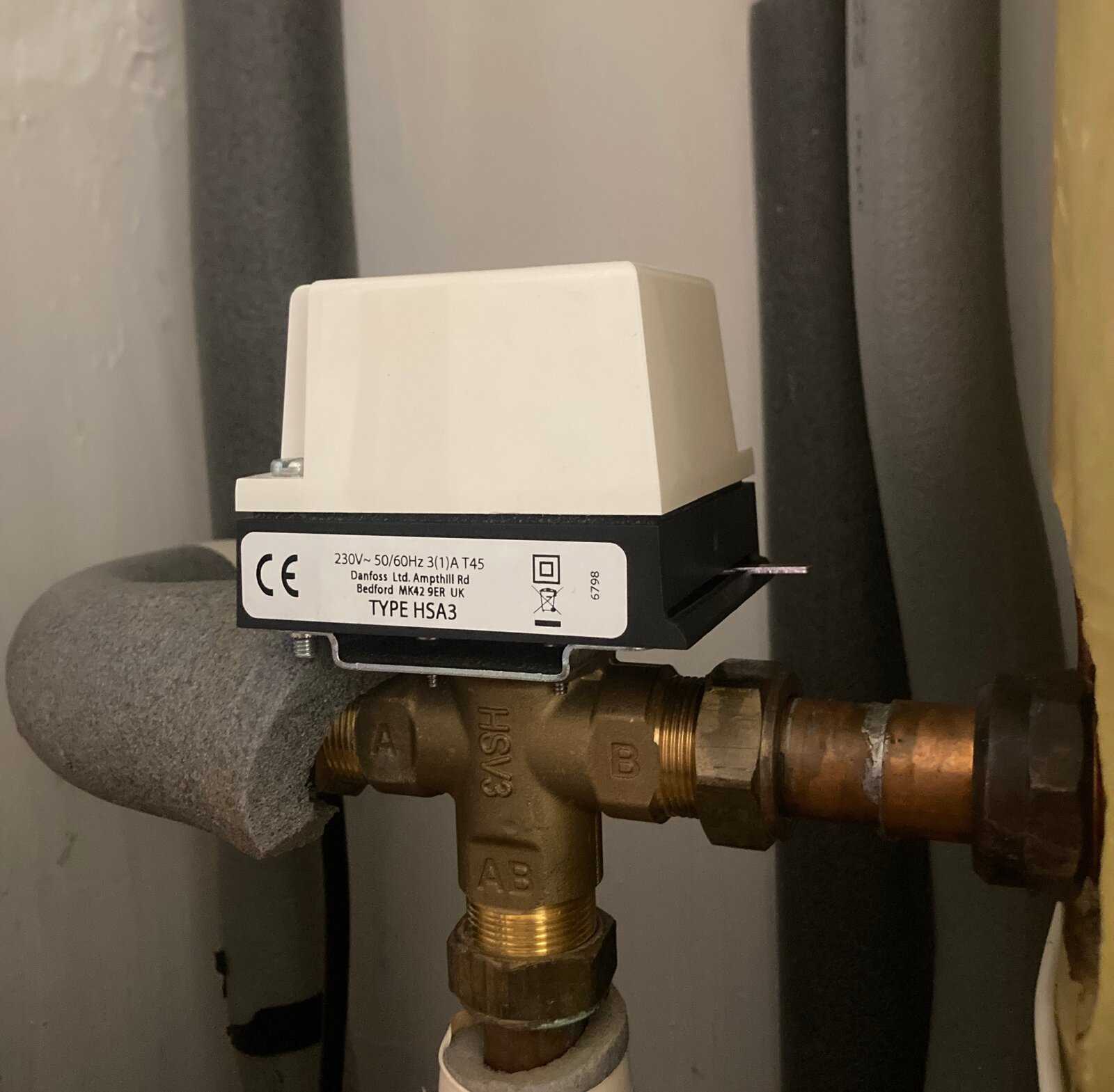

Latching the valve alone wouldn't fire the boiler. Does the boiler fire up under a demand for domestic hot water from programmer and cylinder thermostat , I assume it does ?
The most likely problem is a failed motor in the 3 port valve,although it could be other things.

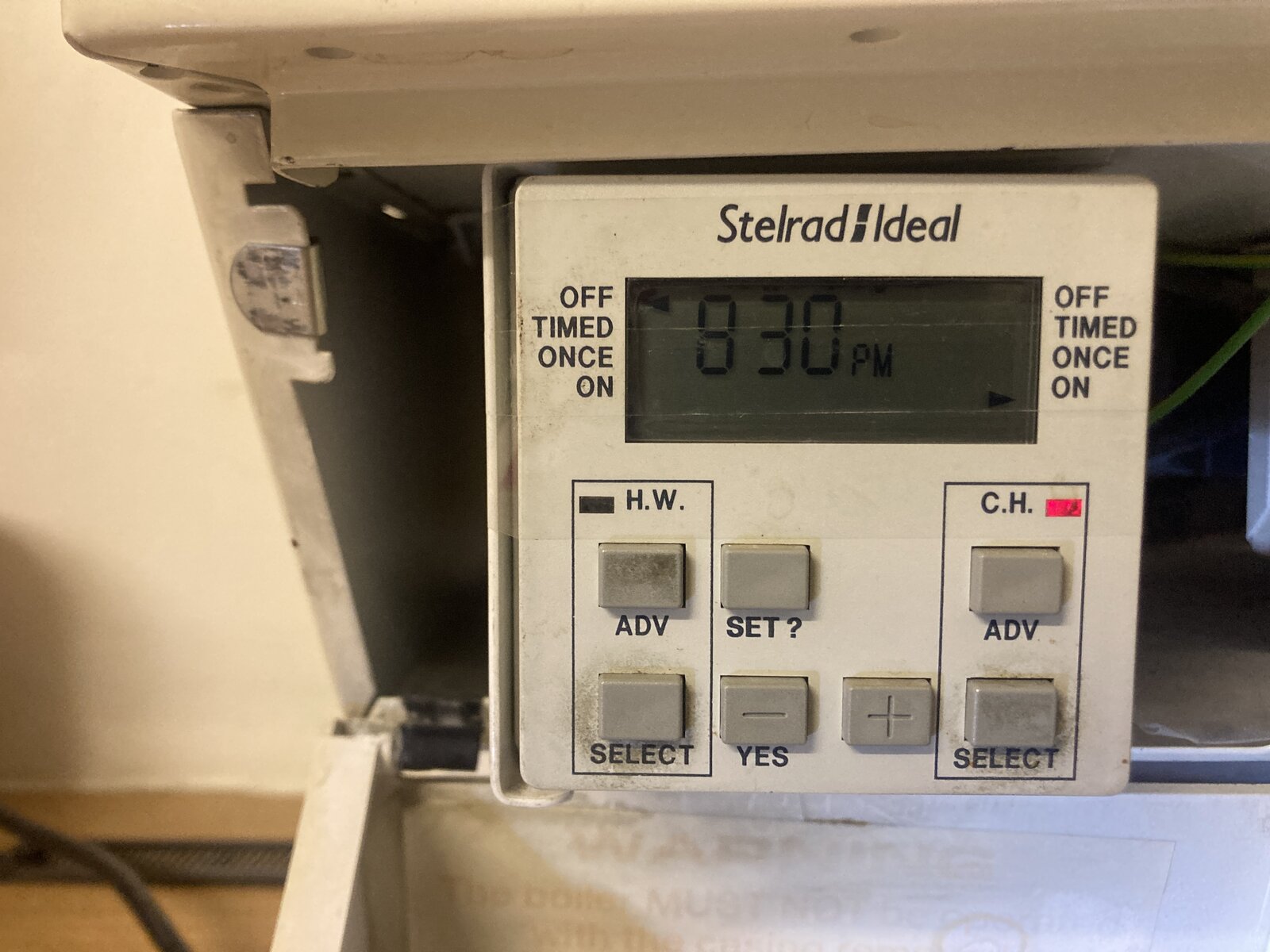

If programmer is set for central heating only,and thermostat calling for heat,does boiler fire up and radiators heat up ,or not ??
It was all stood on timed - turned the HW to OFF and the CH to ON and the boiler lit up - turned the room stat down the boiler stopped - turned it back up and the boiler started - just like you would expect !

If the actuator is manually latched open ,the boiler shouldn't fire up when only c/ heating is selected. So something is amiss.
As it's working,in a fashion, I suppose it's ok until the upgrade is done.
Just to be sure, Are you saying ,with the valve not manually latched open ,the boiler will not fire up for central heating ?
If that's so, it sounds like the motor isn't working in the valve ,and it's microswitch is also being activated manually ( when it normally wouldn't be),when the valve is latched open.

Yes ,latched open = you manually move the lever ,hook it over and lock it in place.
At that position ,the gate is then open to both ports ( in other words ,water flows to hot water cylinder and also to radiators).
When it is not latched open, the water can only flow to the cylinder.
