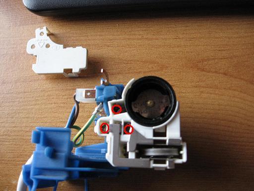

I did a bit of reading up on them, and decided to take the relay off, and test it. I've attached a photo. The 3 red circles are where it plugs onto the compressor part, you can see also the 3 holes on the cover (top-left) that was removed from the main body of the relay.
I understand that this is a solid-state type relay. Can these be tested with a multimeter?
Also, is the disk-type object inserted at the bottom-right part of the thermal overload circuit?
