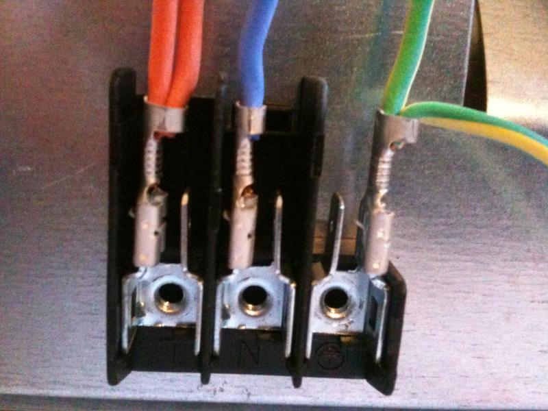

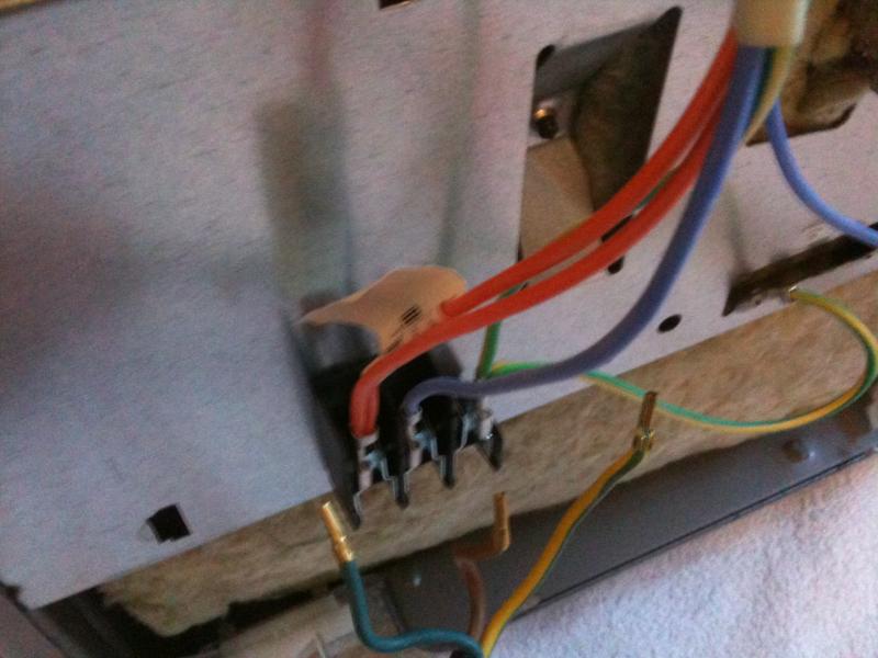

Trying to install new oven. Have removed the connecting wire from my old oven and I'm trying to connect to the new one.
Have taken the back of the new Zanussi and cannot physically find where I am supposed to connect the three wires to on the new connection. Three screws remove from the box but can't for the life of me find where the wires are supposed to go in order to screw back in and connect!
I've uploaded two pictures. In my old oven the three wires slid up behind the connection which enabled me to insert the screws and tighten up. There seems to be nowhere on the Zanussi for the wires to slide into!

Is this a single oven, being fitted on a 13amp plug.
I cant make out your pictures, the incoming mains (if not on a 13a plug) should be twin & earth & connected by nuts & washers on a terminal post or 2 flat plates where you clamp the wires.
Not sure if I get this, but have you taken out the 3 terminal screws from the right hand pic?
The supply wire clamps beneath them, if you have.

Yes its a single oven on a 13amp plug.
Terminal posts and flat plates? Is this something I can be from B&Q and competently do myself or do you suggest and electrician?

Yip, removed the three screws from the right hand picture. Going by my old Whirlpool I expected at that point to simply slide in the wires and then tighten up the screws and that would be me in business!
I really think I'm missing something here, either in my head or with a missing part! I can't see how the wires clamp beneath this part?
Sorry if I'm being daft here guys or asking daft questions here I just can't see how this is supposed to work. Thanks for your patience!
It looks like you need to strip about 20mm of insulation from the cable (after cutting the crimped brass legs off), twist the wire strands tightly together and secure them under the screw. Wind the wire clockwise under the screw so the screw holds them tightly....if you get my drift!

Make sure - no stray wire strands, and keep the insulation just clear of the bottom of the screw i.e minimum of exposed wire. The terminal block has plastic dividers to prevent cross connection but do get it neat!
