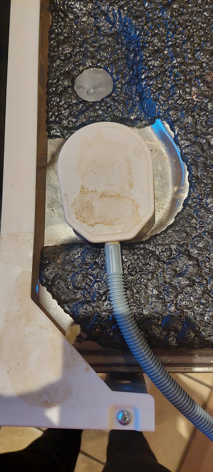

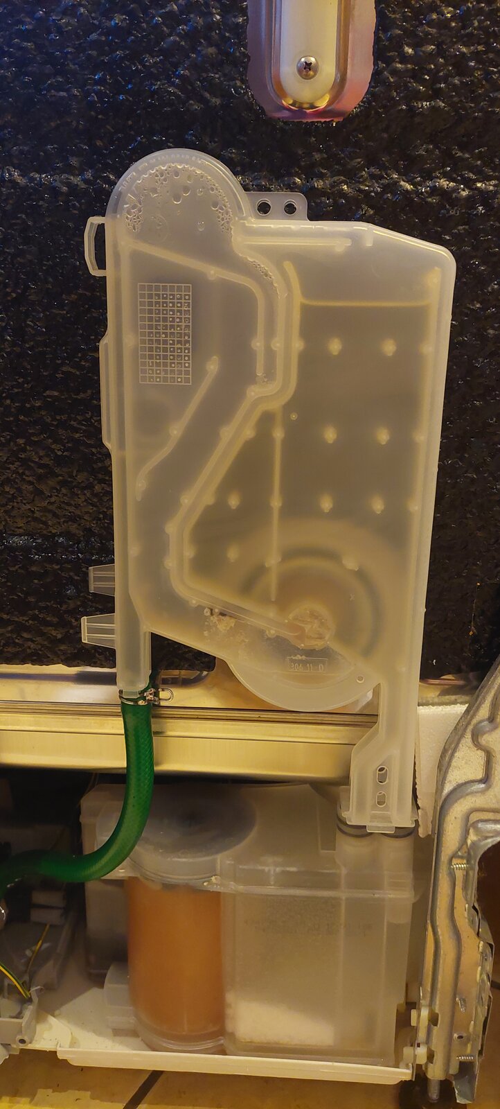

Hi,
My zanussi dishwasher has stopped cleaning dishes. Water is hot but a residue is getting left on dishes. I cleaner filter and spray arms but still not working. I pulled out the dishwasher and noticed that there is a grey hose connected to white thing on top of dishwasher but not connected to anything at other end. Can anyone help?
Residue is often down to lack of rinsing dishes before placing in DW.It’s not a waste disposal and pump slowly reduces food to a fine grit which is then left on dishes.
Had something similar on a 9 year old Whirlpool, found waste pipe almost completely blocked with what looked like washing tablet residue which was softish and easily removed after I took off the drain hose.
