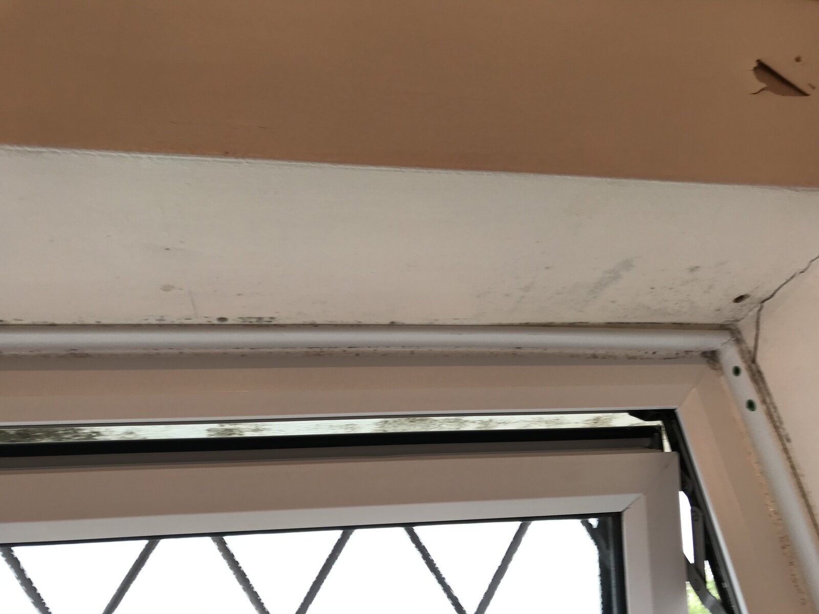

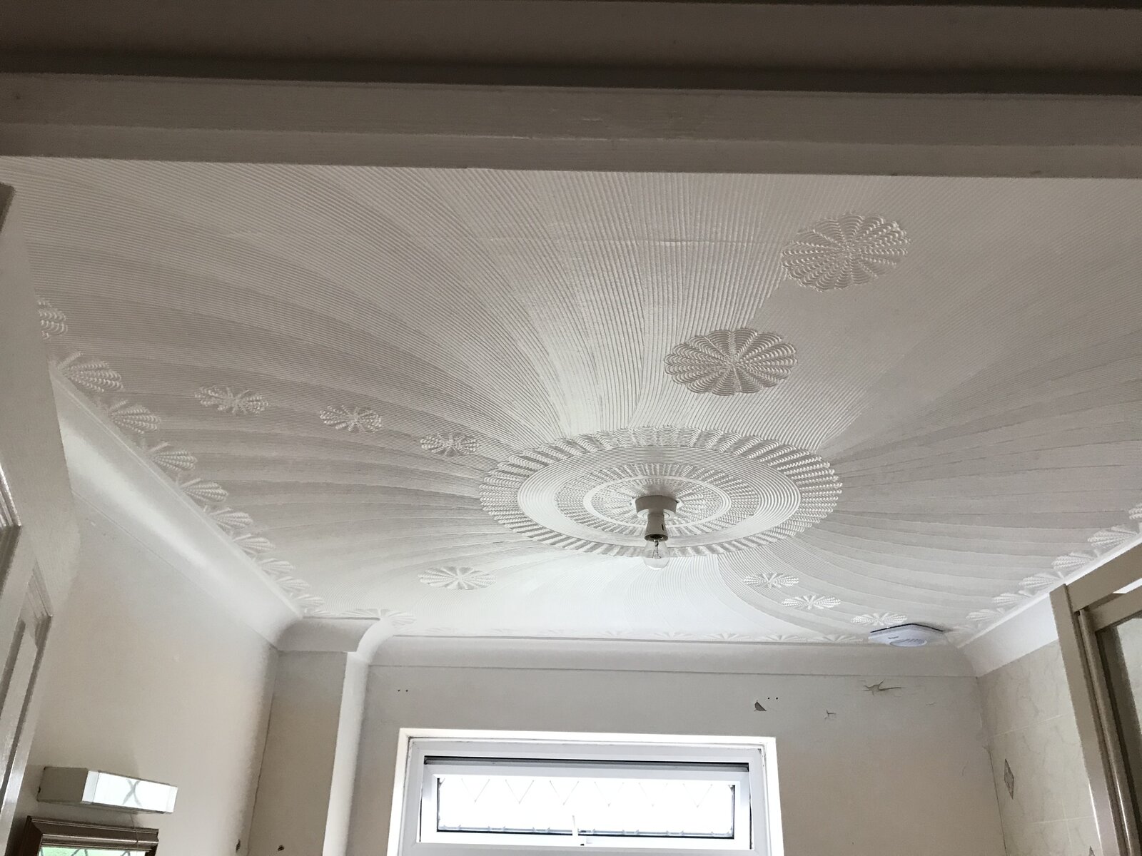

OK, let's see if I can manage this ...

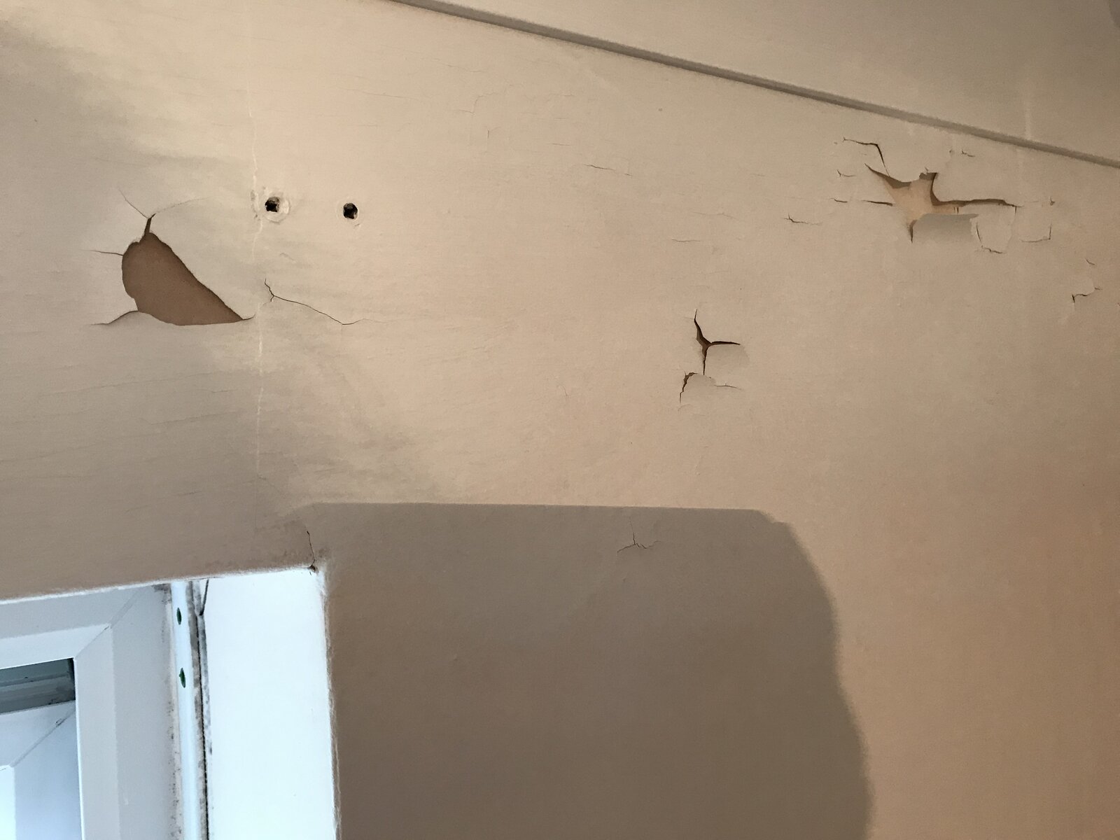

1. Area to the right of the window that had worst mould and is peeling badly.

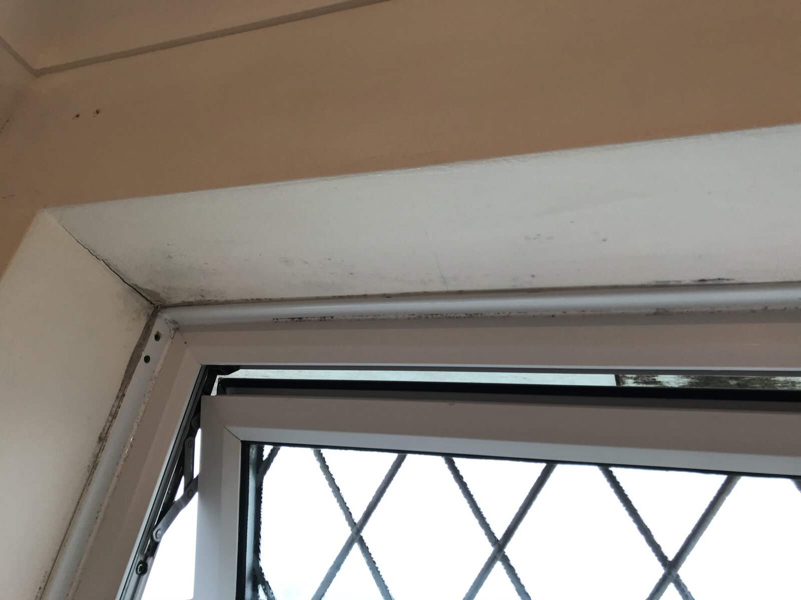

2. RHS of window reveal that has just had mould removed and nothing else as some making good needed.
3. LHS of window and same comment as in #2

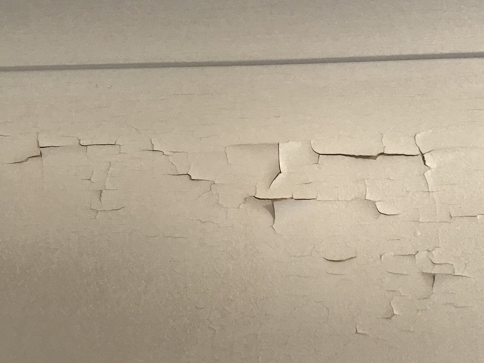

4. Peeling area at door end

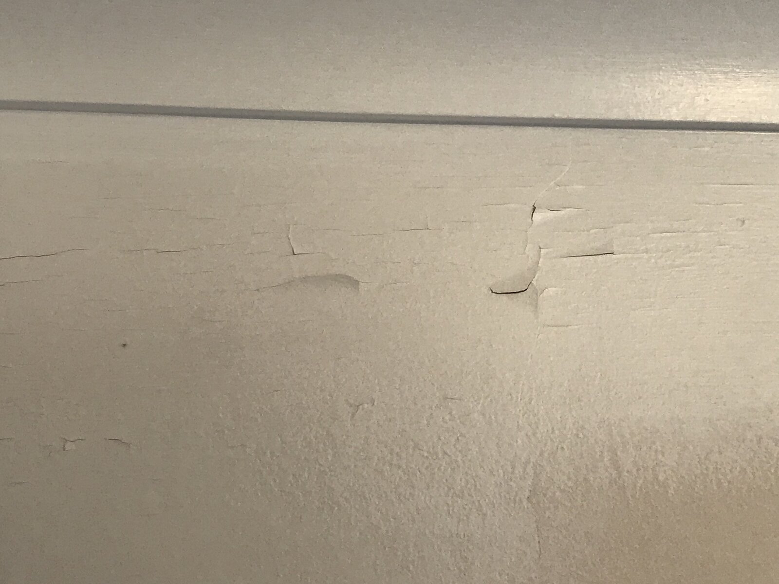

5. Ditto (above door)

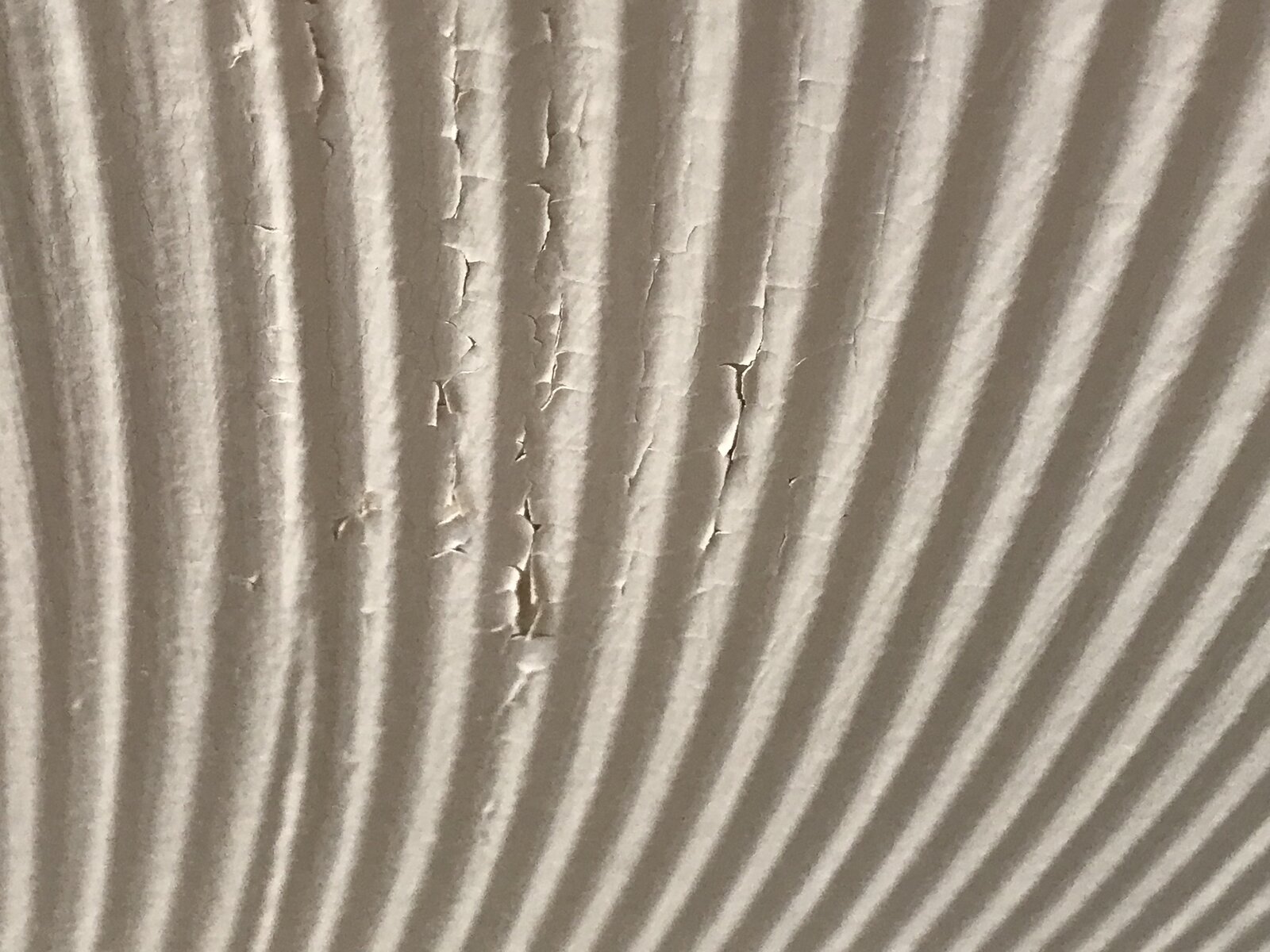

6. The start of the ceiling peel. Very small now but will only get worse over time I feel.
7. Below - what the ceiling looks like in full.
Hmm, looking at the pics I'd say the bare plaster never had a mist coat. Or it had pva which I'd never recomend for the reasons given above. The ceiling peeling could be Matt paint on top of silk, or again, pva.
The mold around the window could well be caused by a slight draft around the window frame, causing the frame walls to be very cold causing condensation. Those cracks can also cause a draft.
I must say though, artexed ceilings are not my thing but that's a beauty!

Thanks. Every room in the house has a similar pattern so that I need to preserve them for uniformity if nothing else.
The ceiling has the original emulsion from 1996 plus my double coat of BIN plus my double coat of Dulux Easycare bathroom emulsion. Although it looks obvious in the photos, you cannot see it with the naked eye - or hardly.
The window comment is very interesting as it's never hard closed; just pulled to.
So, I am in your hands for a how-to remedial course of action ...
