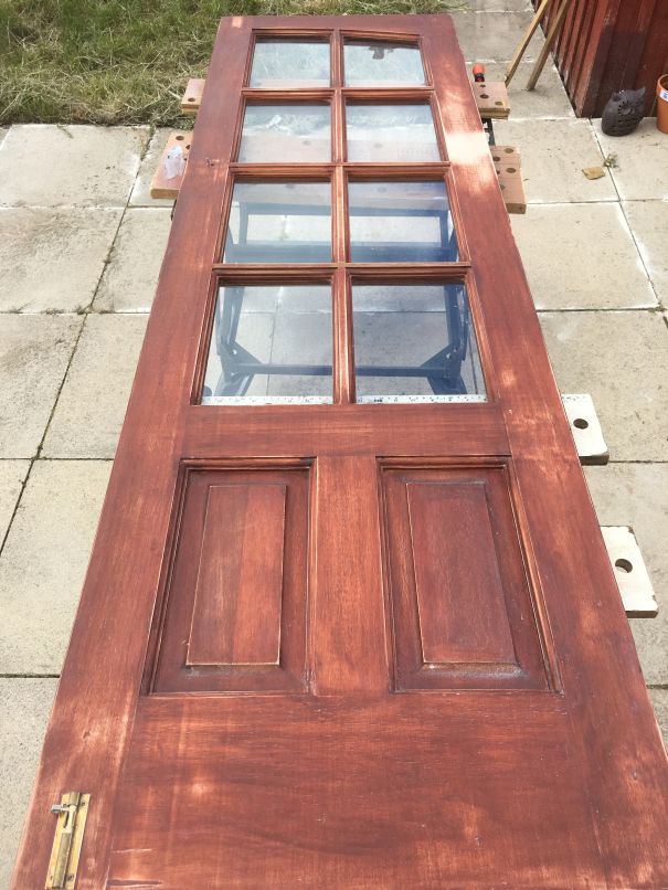

I am also going to be painting interior doors (two of). I'm guessing that the BIN is better than the 123 in this case also (since i don't want any of that dark colour to show through, plus the doors had previously been varnished which i may have missed some bits when removing).
Looks like i'll have to buy a 2.5L tin instead of a 1L.
Yes I'm speaking from experience. I knot all new wood with BIN, it dries quicker than patent knotting so it's more convenient. If the primer/undercoat is of decent quality, as in trade standard, then you'll have no problem with flashing. Definitely go with BIN for the doors, it hides dark colours better than the 123 which I've found to be quite poor in terms of obliterating dark colours.
