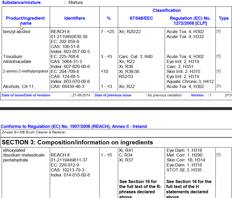

I was going to suggest Isopropyl alcohol which is dirt cheap but that Zinsser stuff is made up of Benzyl concentrate which can be had for about £20/2500ml. You may not fancy yourself as a chemist but I'd buy the base alcohol and try that too.

I have isopropol at home. I have used it to "pre" clean brushes in the past. They still needed cleaning with (my ever diminishing supply of) Dulux Trade Brush Cleaner and Renovator though.
I might try some Benzyl concentrate though. £20 for 2.5L aint to be sniffed at (if it works)
