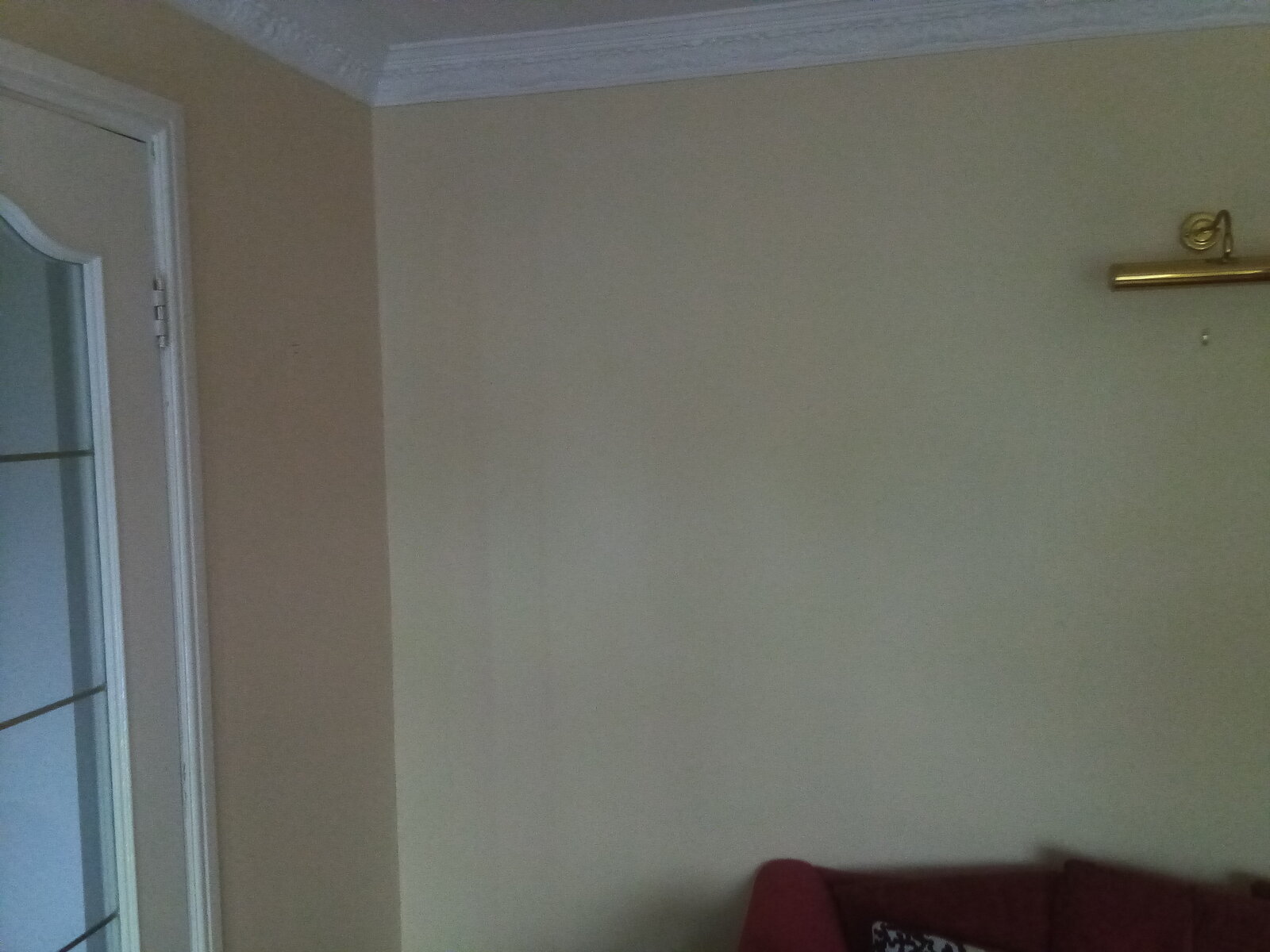

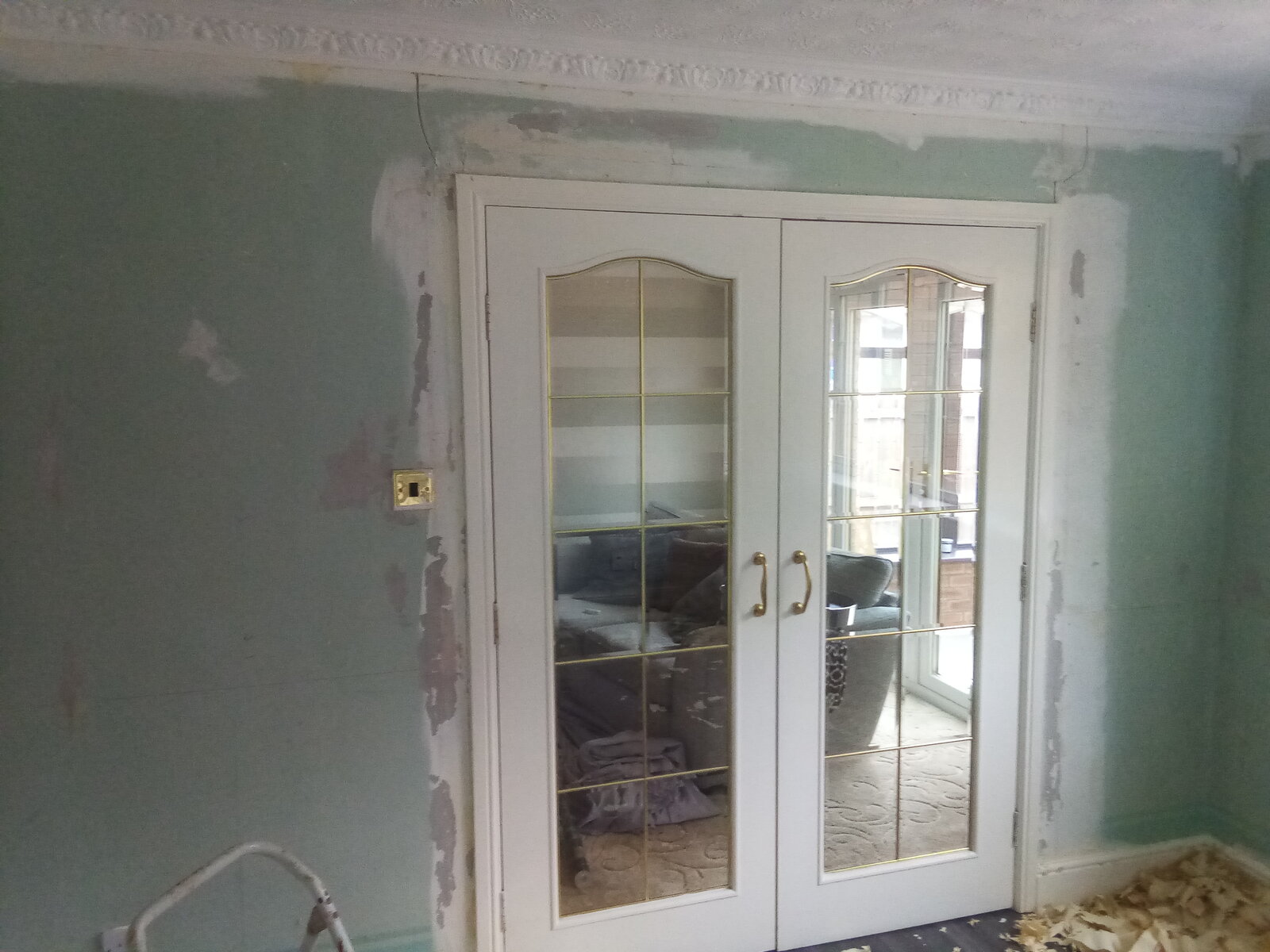

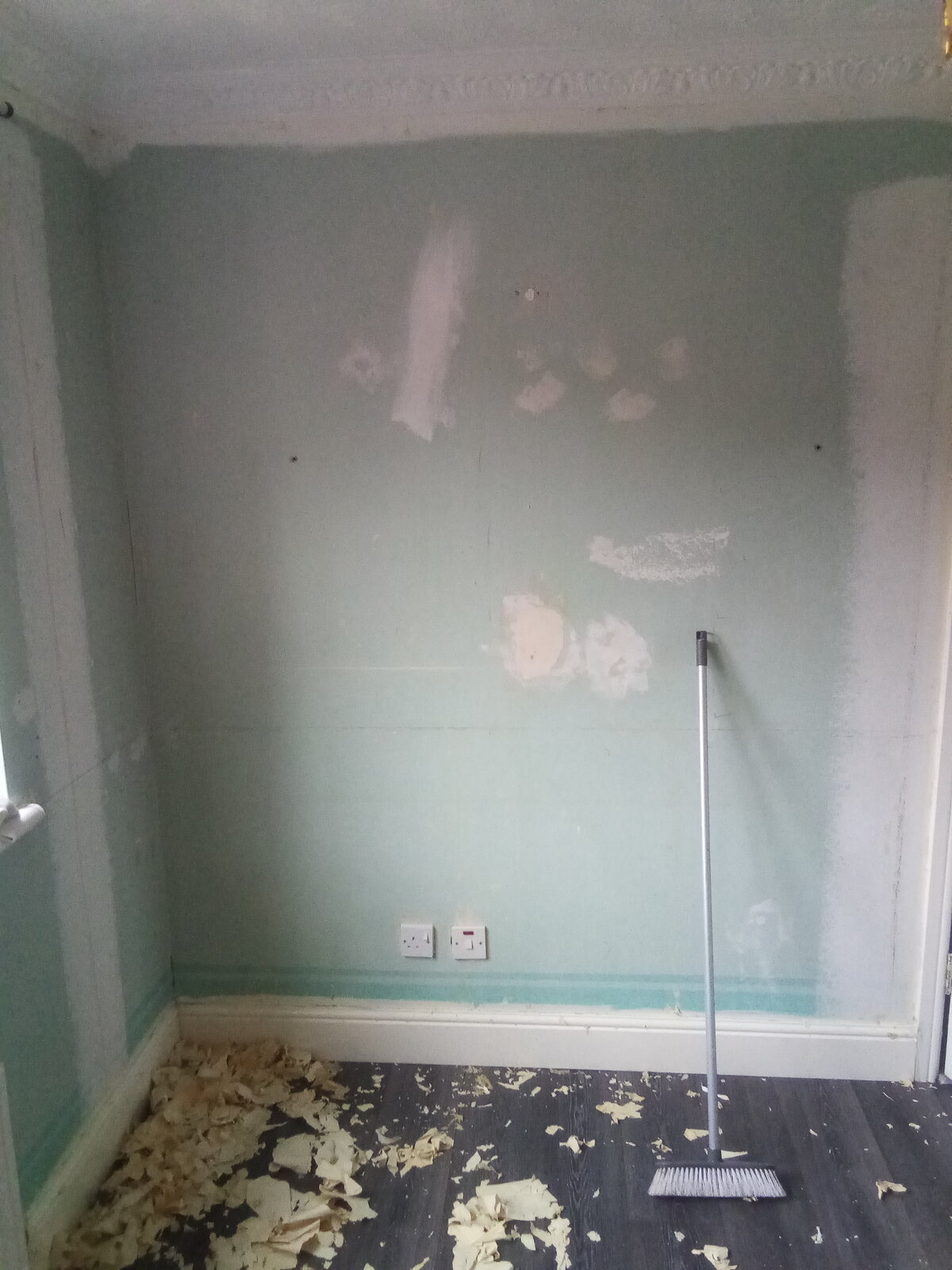

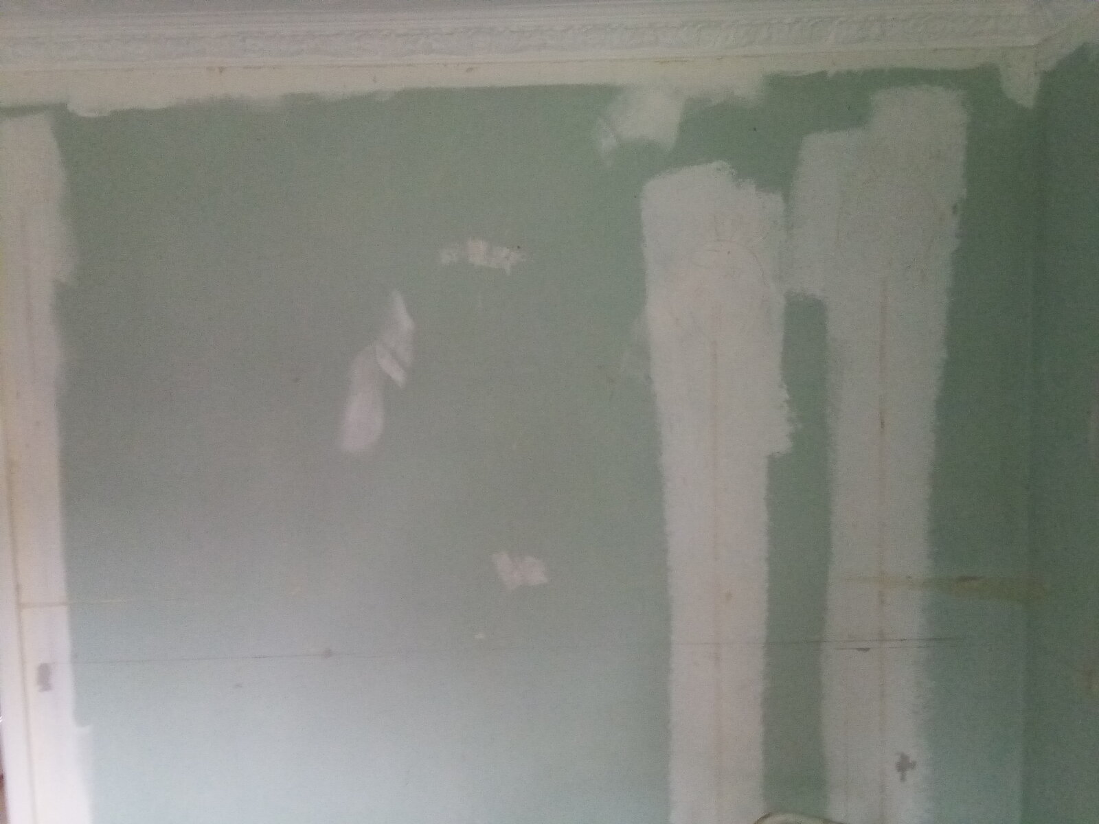

We have moved into a house where the walls are plasterboard.
They're in reasonably good condition but we have just removed wallpaper and are painting most of the walls (some will be wallpapered).
I prefer to "do it right" first time but also want to make sure I don't over do it.
I plan to use Bullseye 1-2-3 but realise this is fairly pricey stuff compared to normal No-Nonsense undercoat. Should we use Bullseye 1-2-3? There is a couple of Rennie Mackintosh type murals that have been on the wall historically by the looks of it.

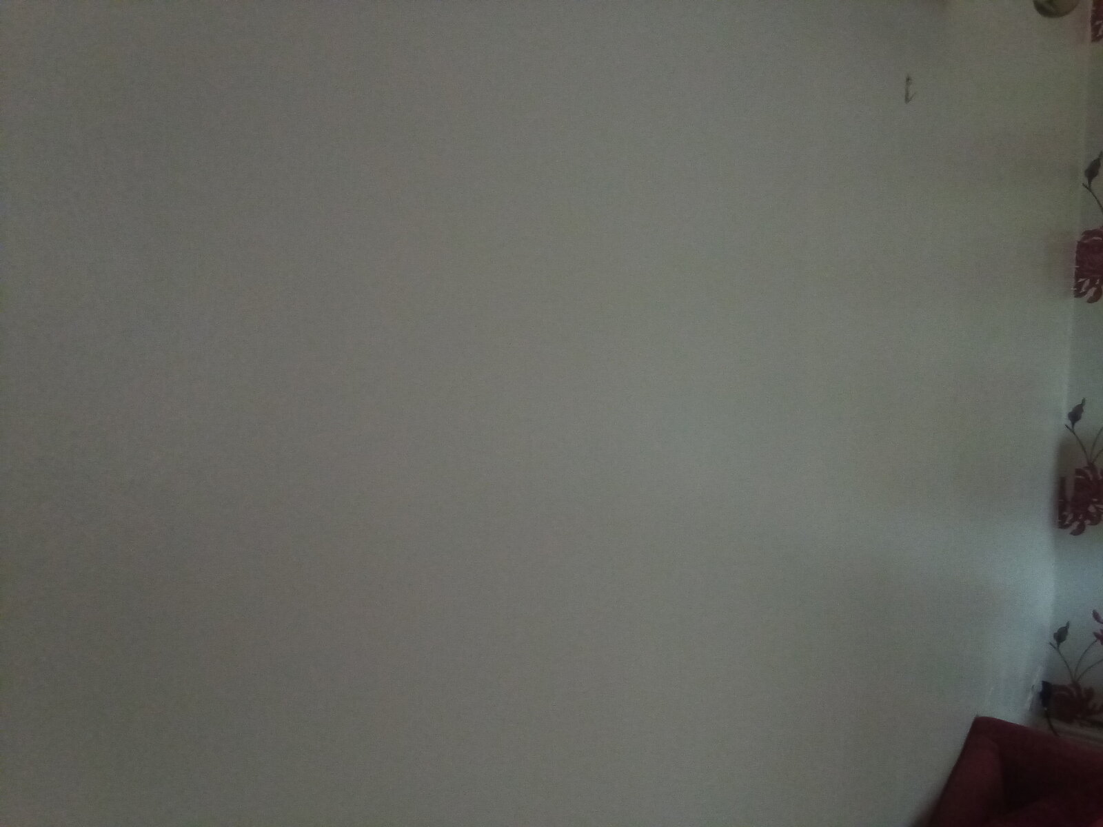

In addition, in the room where paint is still on the walls it has a bit of a sheen to it (maybe eggshell?). We're planning on painting this Matt. Do we just use primer/sealer on this too?

PVA splatters, I try to soak them for a couple of hours and then use a quality blade to scrape them off.
If you want a better quality finish on walls that were previously papered, then consider using lining paper. Walls that have ben papered tend to have residual glue. The glue tends to cause emulsions to craze. You could sand the paste away or use an enzyme based paste remover (eg Zinsser DIF).
Sanding away PVA drips often results in slight divots in the plaster. The PVA is "harder" than the surrounding area. I use Olfa blades. £30 for the tool but the blade quality is vastly superior to all of the other blades I have ever used. Once softened, even a cheap blade should suffice though.
With regards to painting over (waterbased) eggshell, a decent quality matt emulsion should be fine, with minimal prep (assuming that the old paint was relatively clean).

1- Yeh ....paint over ,from experience.....Using Silk especially. Will create unsightly ridges, and divets.
I had to do alot of work on these patches.
Light sanding.....Filled with light weight filler....sanded......Acrylic White emulsion.....then checked the condition again.....STILL LOOKED RUBBISH....sanded ...paint ..paint ...paint...lol
The plasterer musta done ceiling after walls. This is obviously wrong. Like painting! Always ceiling 1st.
My process, was over the top . Try soaking like post above says. But it was a difficult task.
