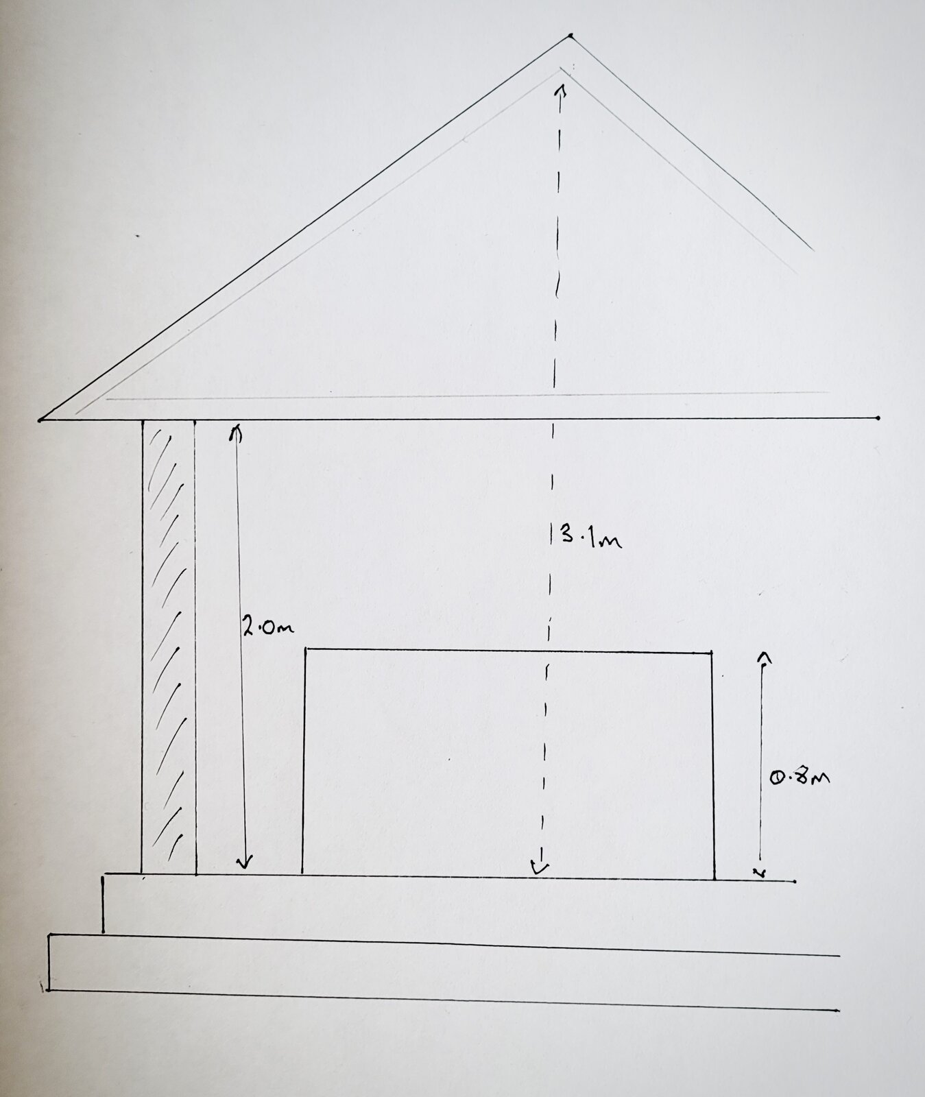

Would appreciate a little interpretation of the regulations, regarding BS761 and Section 701
This relates to a Hot Tub install.
Hot Tub on hard wired 32A RCD protected TT circuit.
The hot tub is on a deck with pitched tiled roof.
Adding an IP65 enclosure (with mcb) to feed a SMART socket for some lighting, (discussed in seperate thread)
No switches to be accessible to HotTub users.
I intend to site the enclosure in the open pitched roof space.
I had been intending to install 2m above any point above Hot Tub … so at apex of pitched rafters.
My question arises looking at this explanation of Section 701, the article shows on page 2 that the extent of zone is only to 2.25m from the floor, whereas I had understood it was 2m from top edge of Hot Tub.
If the diagram is right, then I can lower enclosure position to a position >2.25m. Making install physically easier.
Welcome advice on this.

701 applies to bathrooms. A hot tub is not a bath and the presence of a hot tub doesn't make the space into a bathroom.
A hot tub isn't a swimming pool either.
There are elements of both bathrooms and swimming pools in hot tub installations and some of the requirements for bathrooms and swimming pools could be used, but there is no section that specifically covers hot tub installations.
701 applies to bathrooms. A hot tub is not a bath and the presence of a hot tub doesn't make the space into a bathroom. ... A hot tub isn't a swimming pool either.
