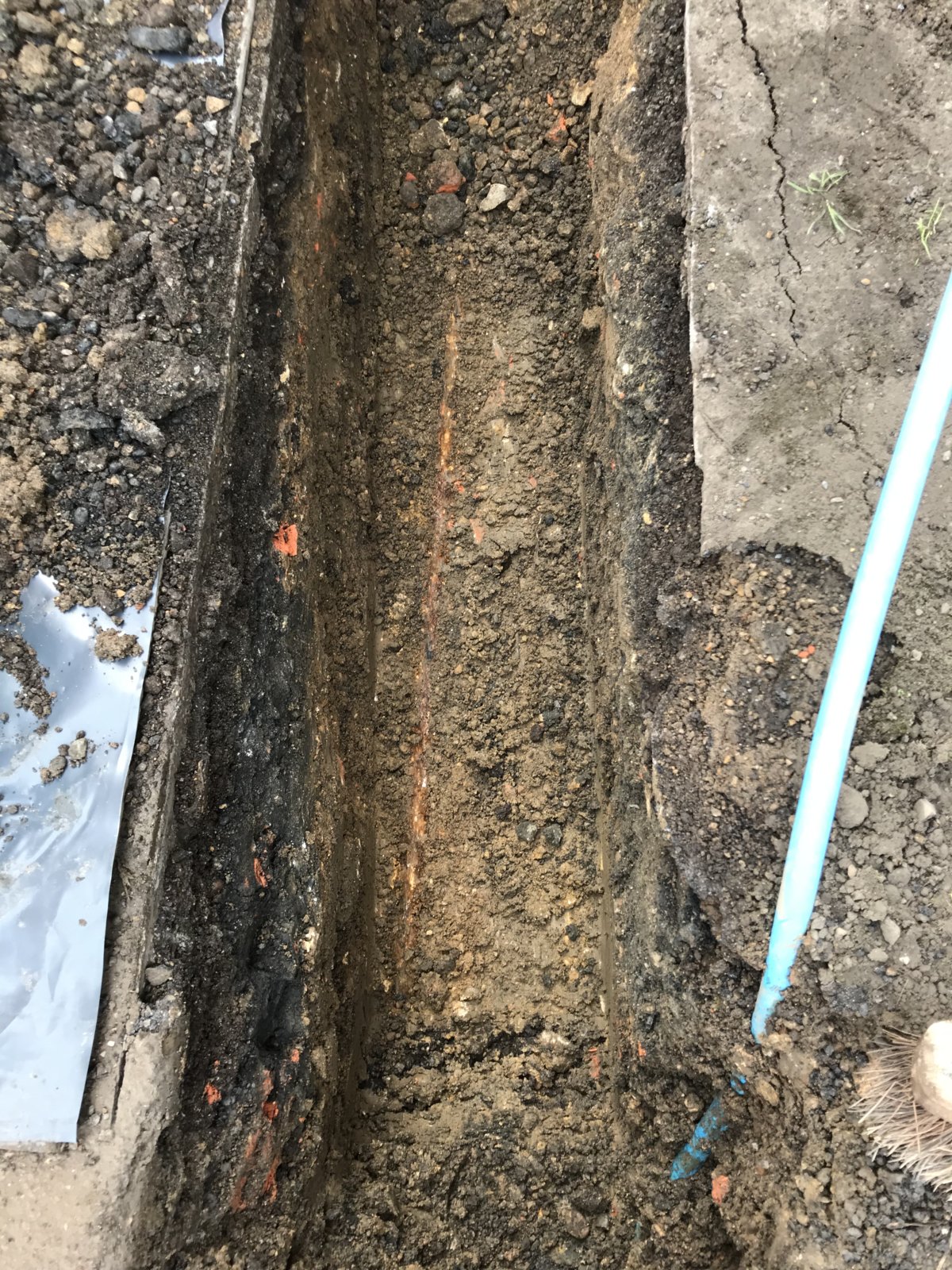

If your digging it out about 300mm wide would be the minimum.
No, just the width of my legs.
I don’t tend to follow any regs, if doing a repair the new section goes in at the same depth as the original pipe.
For example, this steel pipe at about 600mm deep:
