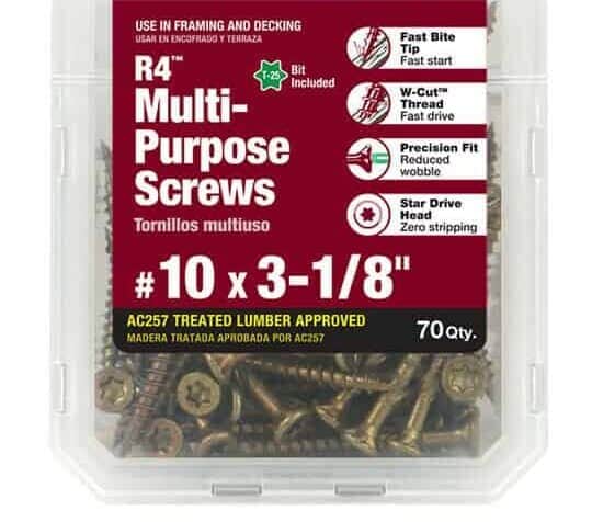

Screws are listed in a couple of different ways depending on when and where they were produced. In the UK and Europe, screws are listed in a metric format. Most suppliers will only list the screw sizes in metric, for example, 5 x 70mm. Imperial units used to be used in the UK and are still in use in some countries such as the USA. Screws listed in Imperial units have the length listed in inches and the thread diameter listed by the gauge equivalent (see Imperial to metric screw chart below).
When it comes to the length of screws, the most important thing to consider is the depth of the material that the screw needs to penetrate. If a screw is too long, it will protrude through the material and could potentially cause injury.

Imperial Screw Sizes
In the case of imperial screws, the sizes are normally presented as the gauge by the length. The length of the screw is given in inches. The gauge represents the diameter of the thread of the screw. In the case of a wood screw with a countersunk head of the type shown in the diagram below, the width of the head of the screw (B) is approximately equal to twice the diameter of the shank of the screw (D). The angle of the countersink in this case (A) is equal to 90°.
With a round headed screw the length is measured from below the head because the length is classed as the amount of the screw that will be in the material it is screwed into. In the example of the wood screw with a round head shown below, the diameter of the head (B) is approximately equal to twice the diameter of the shank of the screw (D). The depth of the head (H) is approximately equal to 3/4 of the diameter of the shank (D).
