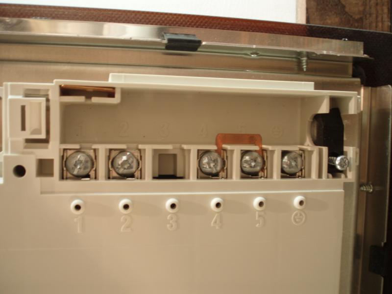

OK guys - no luck with AEG depsite a number of attempts. Photo uploaded!
Please can you tell me which terminal the live should go to and which the neutral should go to. The earth is terminal 6 (if I've got that right).

I *may* be wrong but I would suggest that the other link goes between terminals 1 and 2.
The line wire then connects to terminal 1 and the neutral to terminal 4.
You're correct that the cpc (earth) connects to the sixth terminal.
Obviously the right thing to do would be to confirm this with AEG.
1 and 2 ( linked with the spare copper link ) is the live, 4 and 5 is the neutral, and the earth is marked as such ( the one on the far right.. )
You didn't mention a 6th terminal earlier! :rolleyes:
Still, above advice sounds good.

Thanks to your help we are all wired up and working now!
