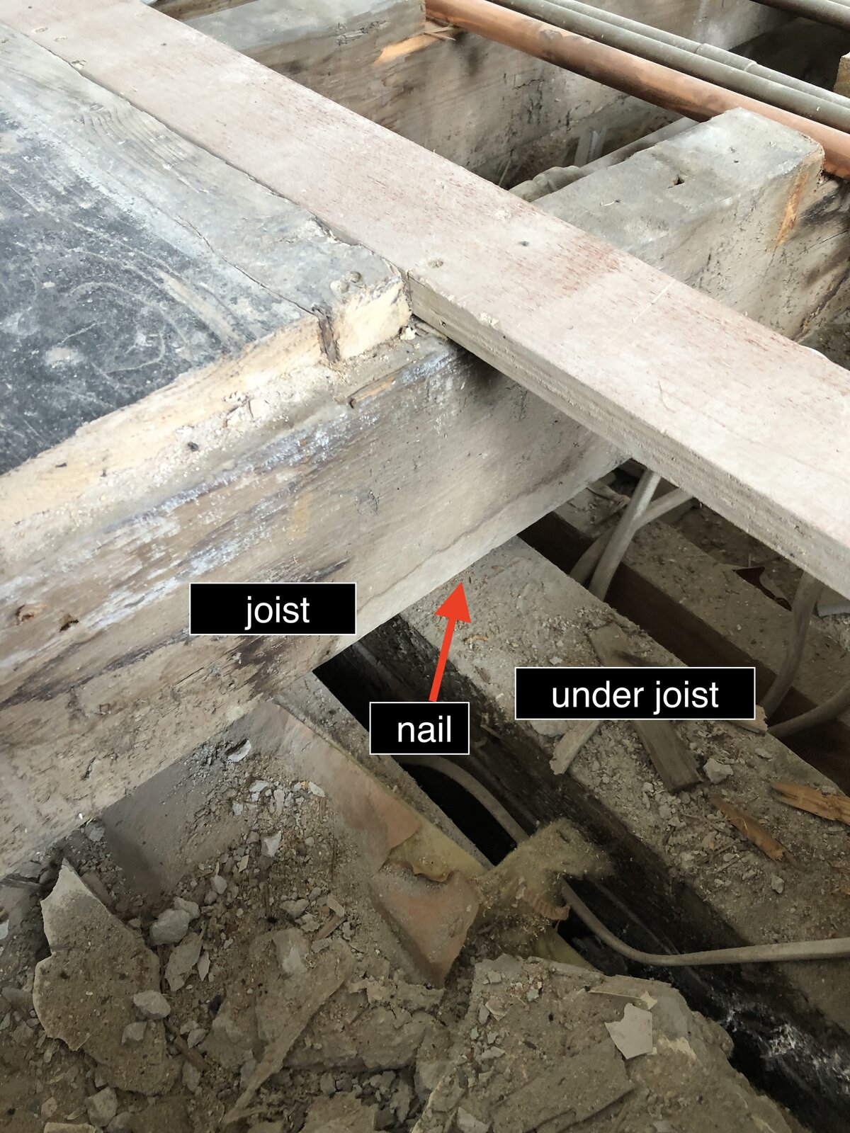

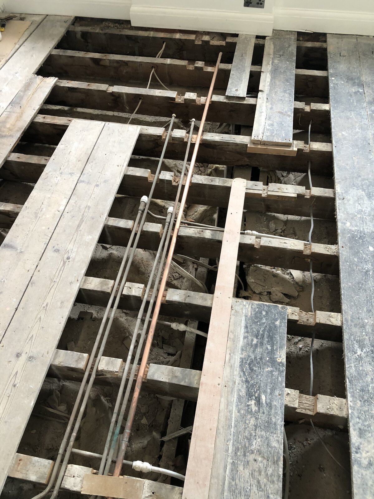

Update:
taken 50% of the original floorboards up and found the water/gas/electric job done by the previous renovation guys

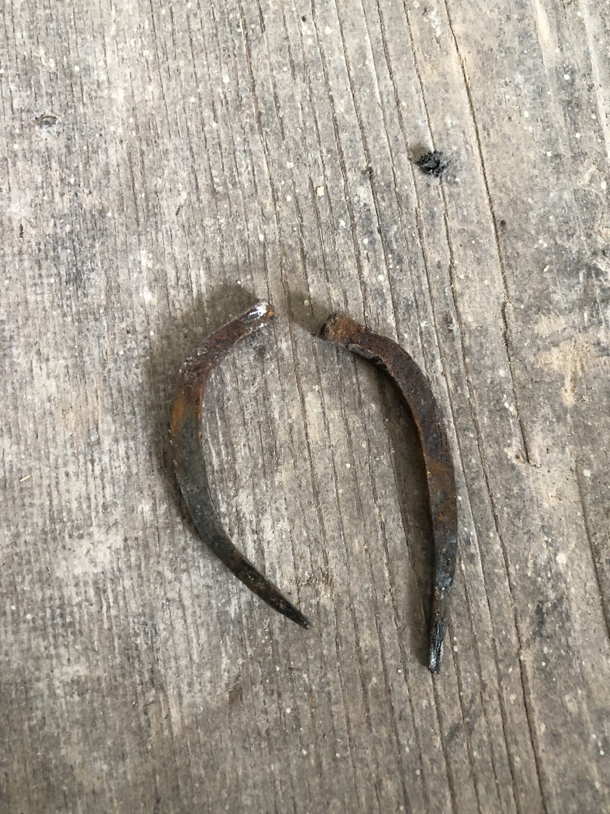

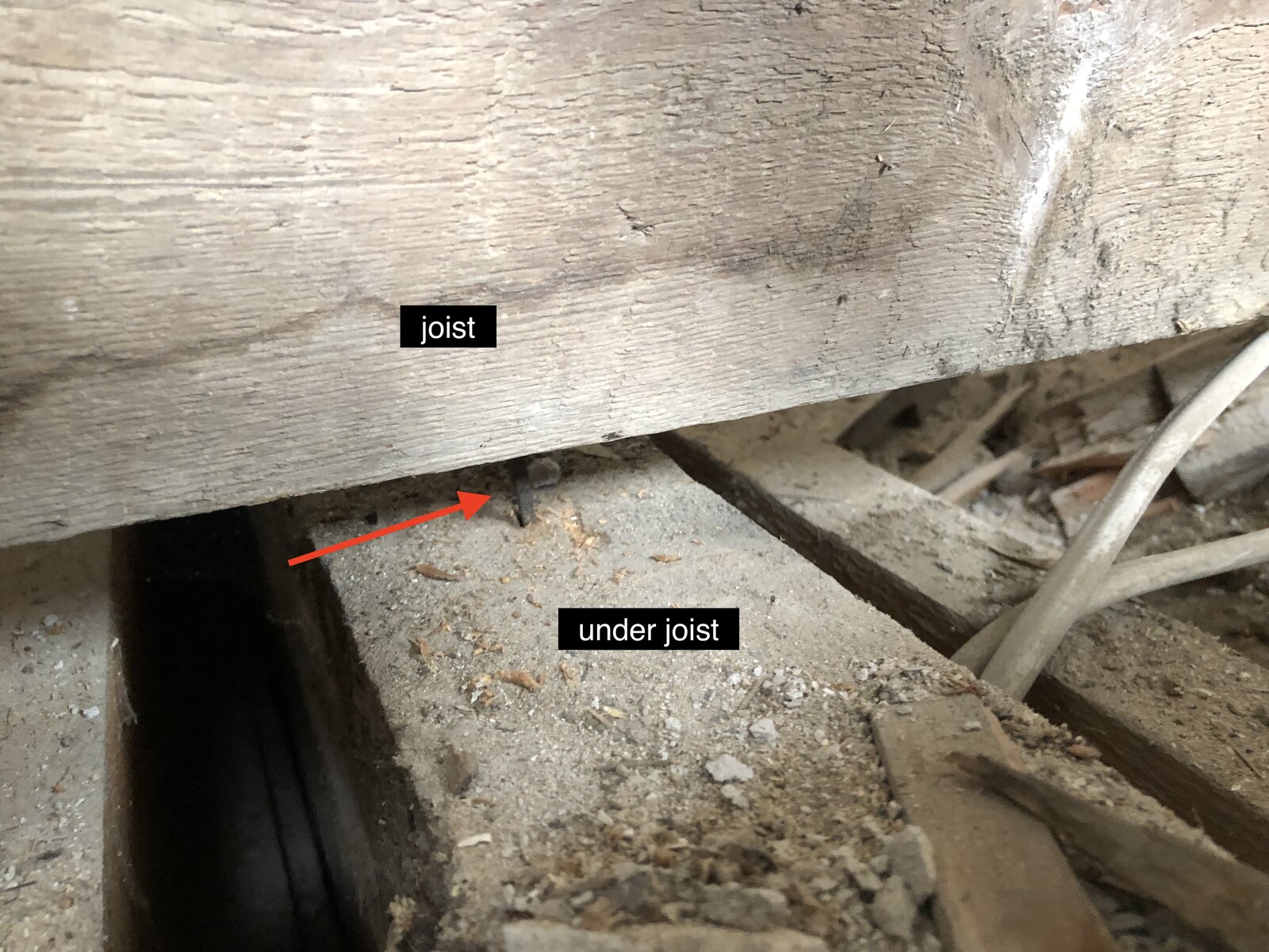

The source of the terrible creaking I eventually found to be two sources:
1 - old rusted nails (more like 'spikes' really) between the joists and the boards
2 - way way worse sound was coming from random 45 degree nails put in between the joists and another set of joists below that - no idea why but some of them are put in random directions and don't seem to add anything, but you can put your fingers on the nail in-between the joists and feel it creak when you put weight over the top joist.
Some nails between the joists and sub-joists are impossible to get to with a hammer or wreaking bar, so considering a multi tool or maybe just a big set of pliers if I can get one of suitable size, to cut the nail and remove a section, but would leave the rest of the nail in place
The sound is better but some way to go yet....
