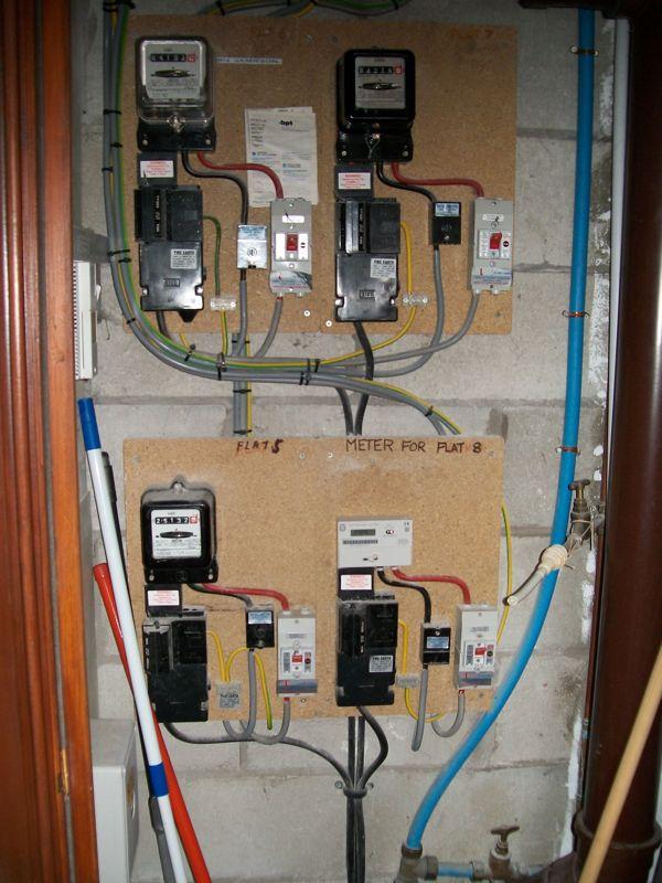

I assume that's a typo and should say "does not now fit or use them". That's interesting since the house and all the flats next door have them. I assume the ones in the flat aren't actually required since the installer provided switch/fuse is within the prescribed distance from the meter.

.... the house and all the flats next door have them. I assume the ones in the flat aren't actually required since the installer provided switch/fuse is within the prescribed distance from the meter.
What somewhat intrigues me is that all of the isolators in your piccies have been wired as only single-pole. Whilst (since its not a TT installation) there is theoretically no requirement to also isolate the neutral, I have to ask "why not?" (and could make some sugegstions as to 'why'!).
Westie - would SP isolation be what DNOs install (if/when they do install them)?
Kind Regards, John.
The other pole was for off peak live tail use if the off peak was controlled by the timeswitch.
That way they were standard with the neutrals fed through the block and manually disconnectable.
As they were, generally, fitted to new supplies we would always be providing, usually, a PME earth.
Fair enough - at least that constitutes an explanation! However, if it were my installation, I think I'd prefer to see both conductors being isolated, even if it were PME - particularly if there were a 'spare' pole in the isolator available, and probably even if it meant two isolators, or a 3/4-pole one (if there were an 'off peak live tail').
Again, fair enough - although, as often discussed, the fact you you provide a PME earth does not oblige the consumer to use it - so they could theoretically have a TT installation (as I will probably do if/when I'm provided with a PME earth).
Kind Regards, John.
It actually demonstrates an interesting point connected to the earlier discussions!
In that as the DNO isolator it is their decision as to the "duty" it is available for. Certainly there would be resistance to it being wired in different ways for the customer's preference.
In fact as it was/is included in a CoP anyone wiring it differently would lead themselves open to criticism.
It is very rare for a customer not to use a provided earth
I would suggest as well that the chosen layout made the possibility of connecting cross polarity harder to do (yes we have come across full installations with crossed polarity after electrical contractors have been involved in connections )
It actually demonstrates an interesting point connected to the earlier discussions! In that as the DNO isolator it is their decision as to the "duty" it is available for. Certainly there would be resistance to it being wired in different ways for the customer's preference. In fact as it was/is included in a CoP anyone wiring it differently would lead themselves open to criticism.
This is all a bit confusing. Although, if they supplied it, it would clearly be in some senses "the DNO isolator", if it's on the consumer's sde of the meter, it is also in some senses the consumer's responsibility, isn't it? Perhaps more to the point, if it is on the consumer's side of the meter, then it presumably comes within the scope of BS7671 - and, as such, if the consumer chose to have a TT system, there would be a requirement for DP isolation. Would the DNO not consider wiring it as DP if the consumer requested that for this reason?
I'm sure that's true - but,as I said, I may come to be one of the exceptions which proves that rule :) Would you regard me as foolish for doing that?
That's obvioulsy true, but I think one has to assume competence on the part of those involved in connections within the installation - so that I don't really regard that, in itself, as being a particularly good reason to not use the second pole of the isolator for the neutral. Let's face it, an electrician prone to 'connecting cross polarity' can just as easily do it in the CU as at the output of the isolator!
