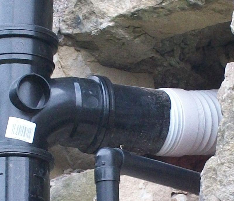

Someone at work answered another thing that was nagging at the back of my mind. He saw the photos and the first thing he said was "are there any ladies in the house ?"
He then went on to say that his bog has a bit of corrugated white pipe like that, and his missus keeps blocking it with tampon applicators which catch on the corrugations and then trap any other solid matter. He then went on to describe (with the hand movements) how he has to stick his hand round the bend to dislodge it. Fortunately he didn't do this while we were eating.

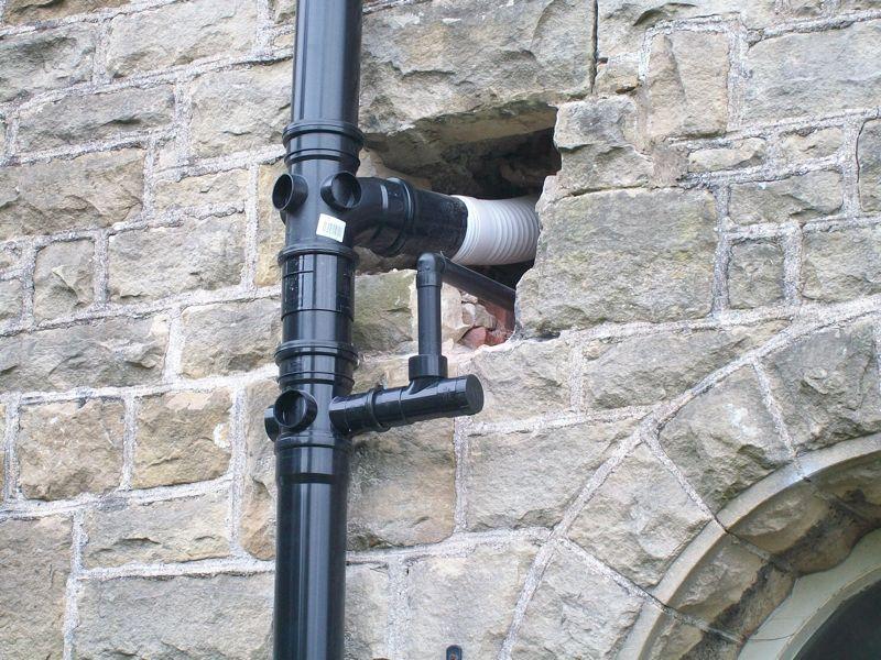

I have had to use a flexi pan connector on my toilet and had no problems with it whats so ever. Ladies should not be flushing there sanitary products down the toilet! However how this has been installed is simply appalling. It needs solid soil pipe through the wall. I have had to change many a pan connector due to the seals leaking connecting to the pan. Good luck trying to change one that disappears through a wall.
Call the plumber back, it is not acceptable!
Why didn't they use a diamond core drill to make the holes, then it would have been nice and neat with no patching in necessary afterwards.
Cheers.
I particularly like the use of knuckle bends to keep it neat and tidy :LOL:
Never had a problem with those flexi's blocking or leaking - but fooking hell - that aint right. Surely they must have looked at it and thought " 'ang on lads - we're gonna get pulled up on this".

And yes, it was the plumber made those big holes. No he didn't take the blocks out as blocks, they came out in tiny bits. Luckily my brother has found a couple of bits of stone that are a reasonable match.
I can only assume the plumber either doesn't have a suitable core drill (though he seems to have used one for the boiler flue), or couldn't be bothered using it where he couldn't stand on the floor.
