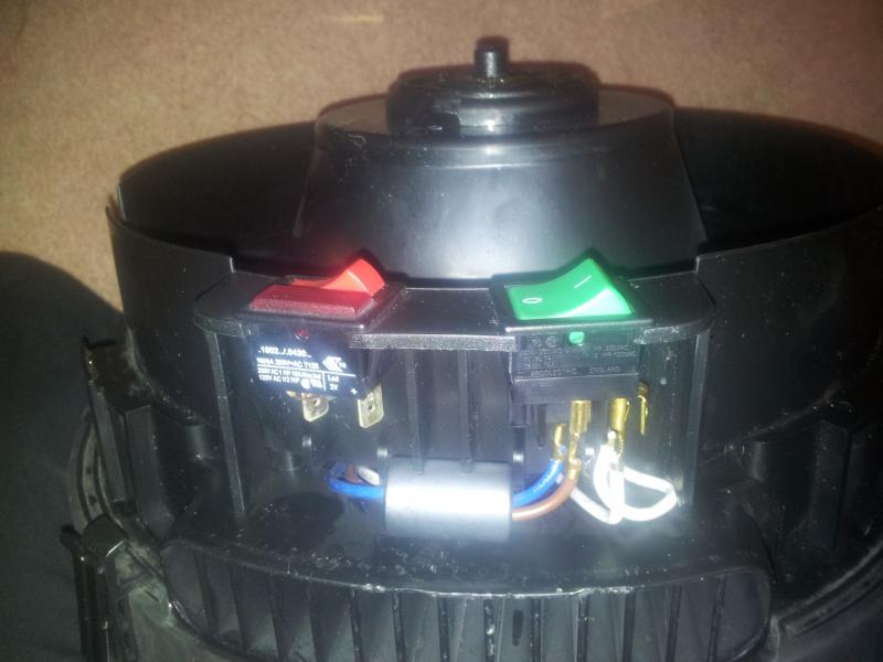

The two white wires that go to the motor. They go to the on off switch one will be live the other neutral then discard the wires to the hi low switch and it don't matter which white wires just any one on live other neutral terminals.
I can also confirm the hi lo switch failed for me too.
Here is a picture of the writes after removing the pcb board:
[/img]
As said above the 2 white wires from the motor now connect to the on off switch.

Can you put a photo of both sides of your pcb on here too please.

In my case the symptom was the same as besty90 – “the light next to the hi/lo switch comes on but motor wont power up” and was caused by a faulty PCB. Personally I preferred the old Henry design where the HI/LO switch didn’t have a light.
