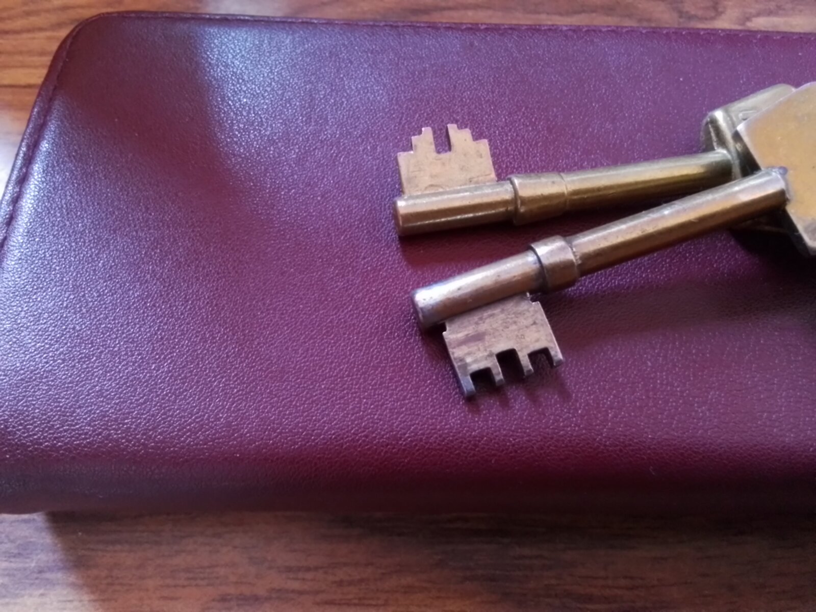

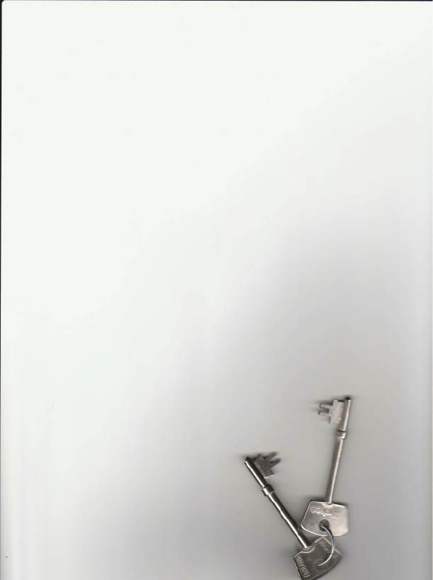

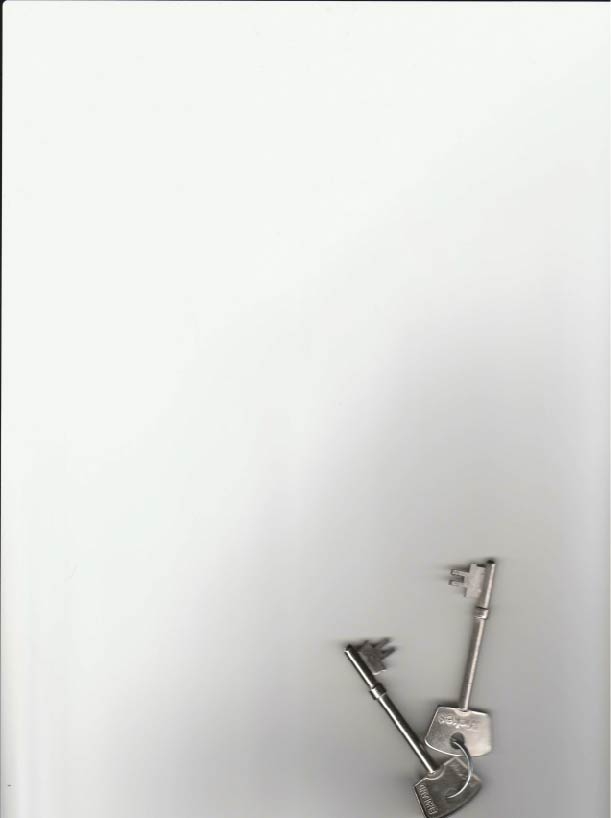

I have a box of unidentified locks and keys
Is it possible to tell the number of levers in a mortise lock by the shape of the key?
If do is this key for a 5 lever lock?
  • key.pdf
We shouldn't need to be downloading stuff in this day and age, they should be uploading pics.
Agreed but the OP using a PDF rather than a JPEG may have been in error.
Here is the PDF as a JPEG
Three
I would have preferred a picture of the key, rather than a picture of a large rectangle with a small key at the bottom.
These are five.

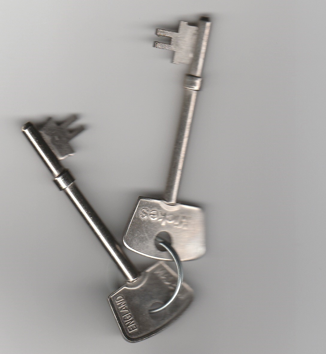

I don't know much about attaching files - anyway here is a jpeg of the keys
There appears to be some doubt about 3 or 5 levers, I hope this picture will clarify

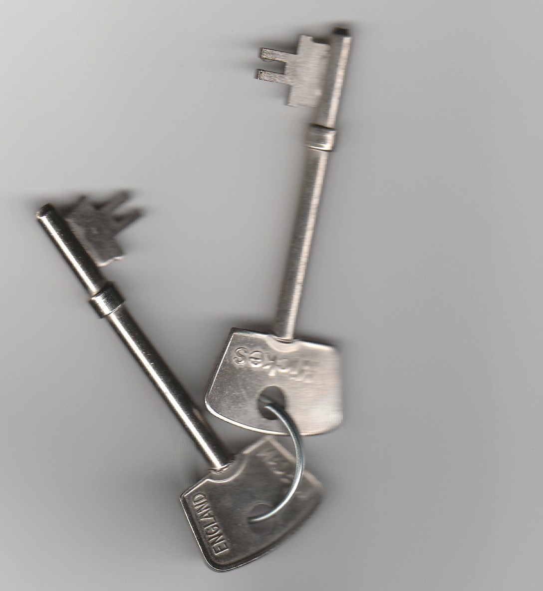

Thanks for msgs
They often stamp the number of levers, on the lock itself.
Remember that when you put a key in a lever lock, some of the "bits" (teeth and notches) lift a lever, and some of them act to move the bolt backwards and forward. So the number of levers is always less than the number of bits. Typically by two.
Additionally, the key must be symmetrical, to operate from both sides of the door.
That's a cheap 2 lever lock key.
Very simple to pick.

The lock case has no markings
There is a "plate" which says "Wickes 5 lever"
The keys say "Wickes"
but as the parts are all muddled up in a box I can't be sure that the "plate" goes with the lock - hence my inquiry
