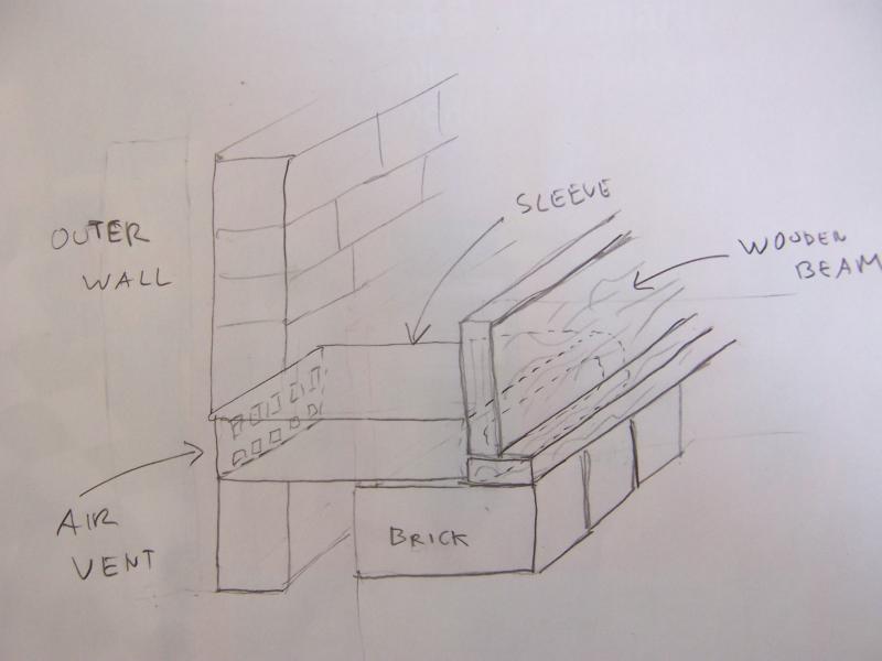

In the solum, can't see the air bricks?
that's a point... the sketch shows an outer brick wall but not an inner one. Is it a brick/block cavity wall, or is it a timber framed house with a brick skin?

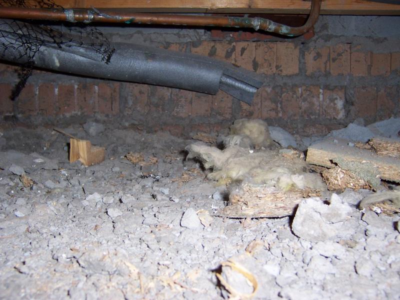

I see what you are asking, here is a couple of pictures where you can just see what is above the two layers of bricks as they are not blocked by wooden beams or joists.
It looks like grey bricks which I presume make up the inner wall of the cavity. In poking the garden canes through the blocked vents from the outside they go through about 40cm before hitting something solid (wood?).
I realise that in the second picture the two sets of red bricks and the grey bricks form a flat surface in the inner wall. The 1st picture shows a tiny gap(just in from the left) where the wooden beam would "normally" be, so the grey bricks/sleeve are set back slightly.

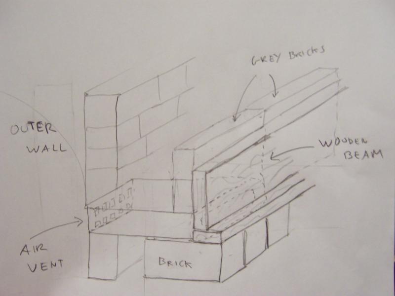

So in the light of what I think is happening in picture number 1, I have updated my diagram to include these grey bricks.
Masona, you have said you would drill holes on inner wall and not use the sleeve - sorry if I have misunderstood you kind intentions, but isn't the sleeve there to ensure fresh air gets into the void from the outside?
Hope this extra information helps someone to help me. :(
the grey bricks are almost certainly lightweight concrete blocks. they are relatively soft and about 4 times the size of a brick (if they are brick sized, and very hard, they might be sand-lime bricks). There should be a gap in the inner leaf allowing the duct from the airbrick to pass air between the outside, and the space under the floor. the duct or sleeve prevents cavity insulation falling down and blocking the airflow.
if your sketch is accurate, I would have no hesitation drilling a few 35mm holes in the joists which obstruct the flow from the airbricks. if your diagram is correct, they are standing on the wall plate, so they are at no risk of collapse. Drill the holes in a horizontal row, centred at the middle of the height of the timber, with gaps between each hole twice the size of the hole (I haven't got the recommendations for joist drilling to hand, but this is about right). the timber is not spanning over a void, so is not required to have much strength except to hold the floorboards up.
From your drawing the fresh air is just hitting the floor joist and not underneath the floor space, looks like a poor design when it should've been a sleeper wall construction. JohnD idea is good although you shouldn't have problem but the ventilation should be under the dpc level, there's nothing stopping you drilling from outside all the way in with a sleeve pipe and a round air-vent mesh on the outside wall below the dpc, the floor void & the timber need to breathe otherwise musty smell problem. The picture below is the nearest I could find to give you some idea.

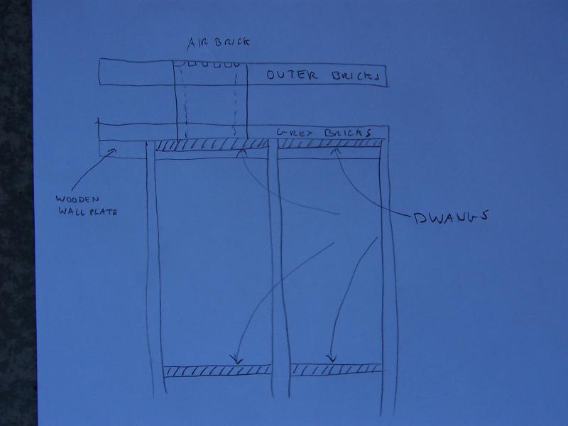

He said in looking at my photos of the joists, wall plates and what he called "dwangs", he thinks it looks like this (top down view)
the three vertical wooden beams represent the joists.
In otherwords he doesn't think there is a continous long piece of wood along the length of the house as I thought. These dwangs are small bits of wood cut to fit between joists. He suggested removing the dwangs that are blocking the air bricks and reattaching them to the joists 1m back. He said a joiner could do this.
Does this sound like a plan?
What are the purpose of dwangs anyway?
the dwangs or noggins are simply to add rigidity to the floor and maintain joist spacing. They can be removed completely or simply moved back a bit as he suggested. Just skew nail then or screw them back in.
Could he replace them with herringbone trusses instead?
sure but its a bit OTT. Just move them back a few feet as your pal suggested.
