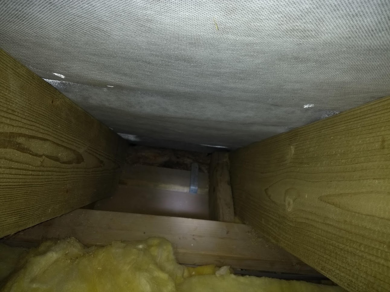

Some random pics of the build, the vents I put in, .... searching Google photos for more ....
removed insulation from this space, still more right down in the soffit though. Guess I need to take all out?

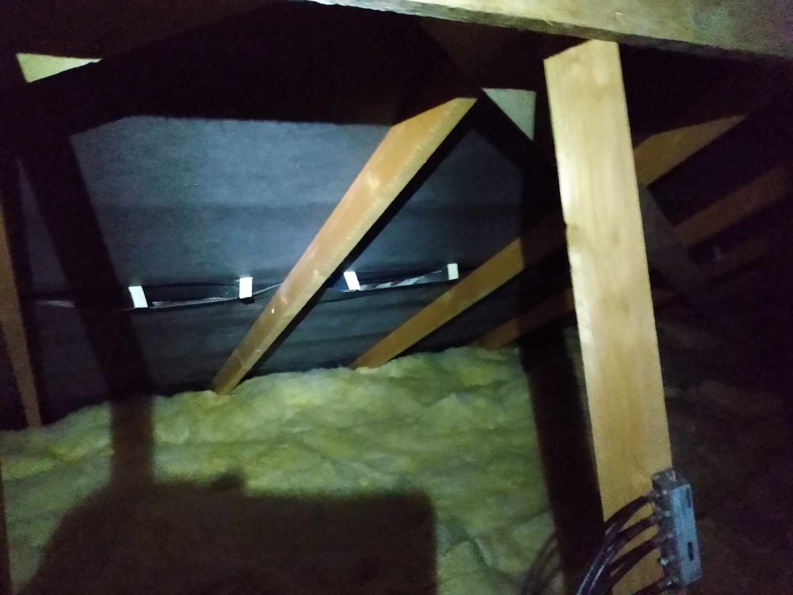

the DIY vents:
more with bits of PIR insulation:

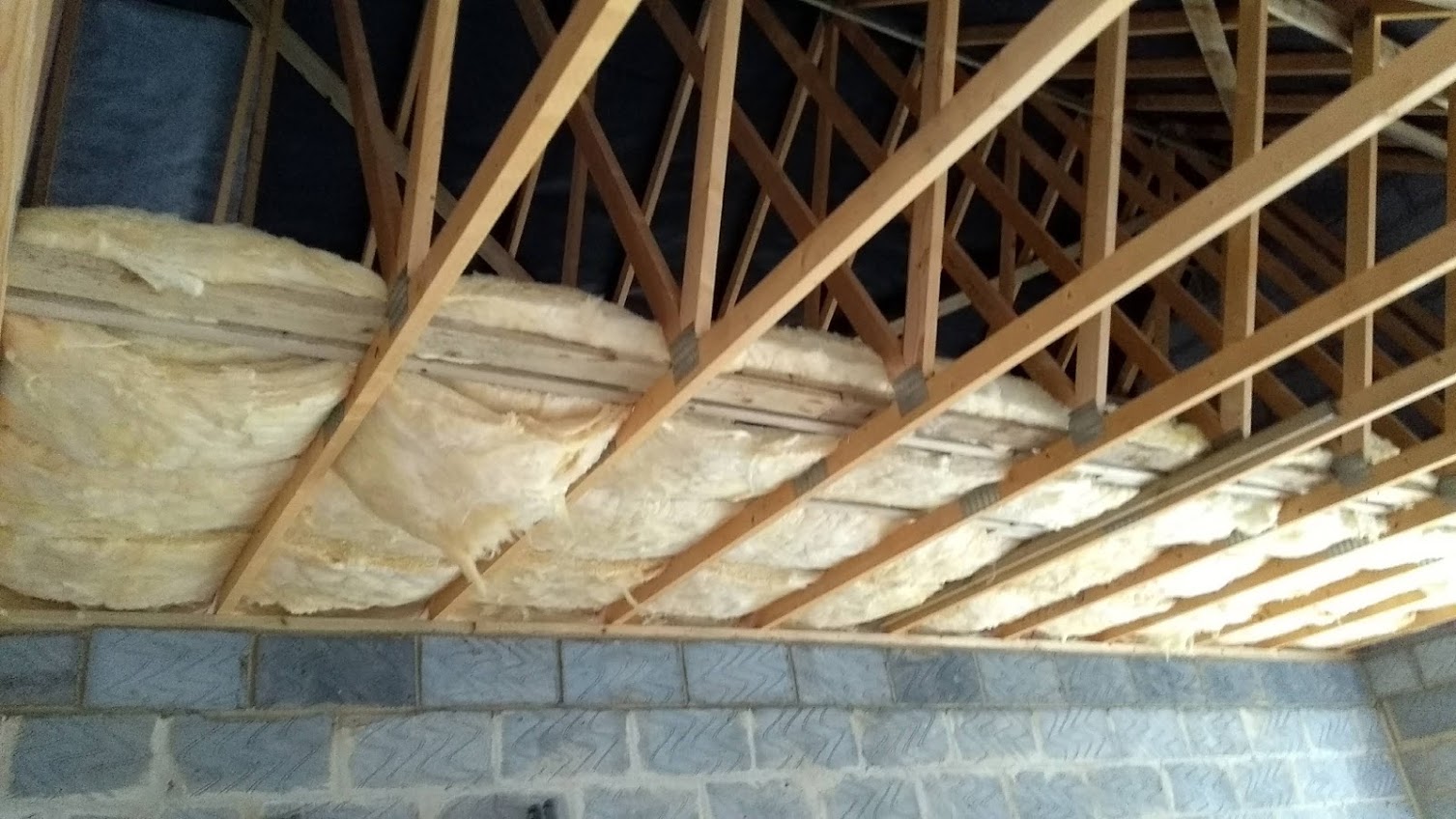

when the loft was built - lots of insulation went in:

It is supposed to be cross ventilated at the eaves with vents equivalent to a 10mm continuous gap .If it can't be ventilated both sides the roof requires ventilation at high level as well. Don't think those felt vent things are an 'official' solution. Having said all that, an approved breathable membrane shouldn't require additional ventilation , although in my experience eaves ventilation would be included as well anyway, with air bricks at high level in gable walls also if possible.

For now, you should put those lap spacers down by the eaves and up by the ridge on both slopes.

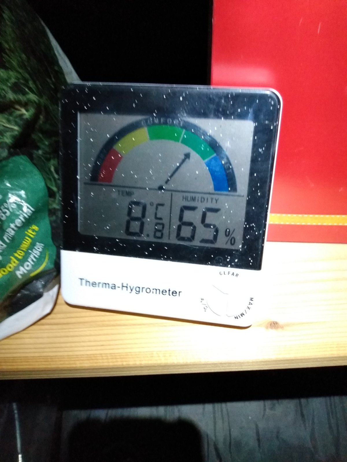

No boxed plumbing, will check light cable holes and shower pipes. Loft was cold and higher humidity than house. The hall was 60, loft, loft 65.
Maybe some leakage was coming through kitchen extractor. I did seal more tonight.
We had felt in loft in previous house and never noticed mould problems. But maybe didn't keep much up there....
65% humidity is nothing , actually quite low for the temperature. suggests the humidity is either intermittent, or localised.
