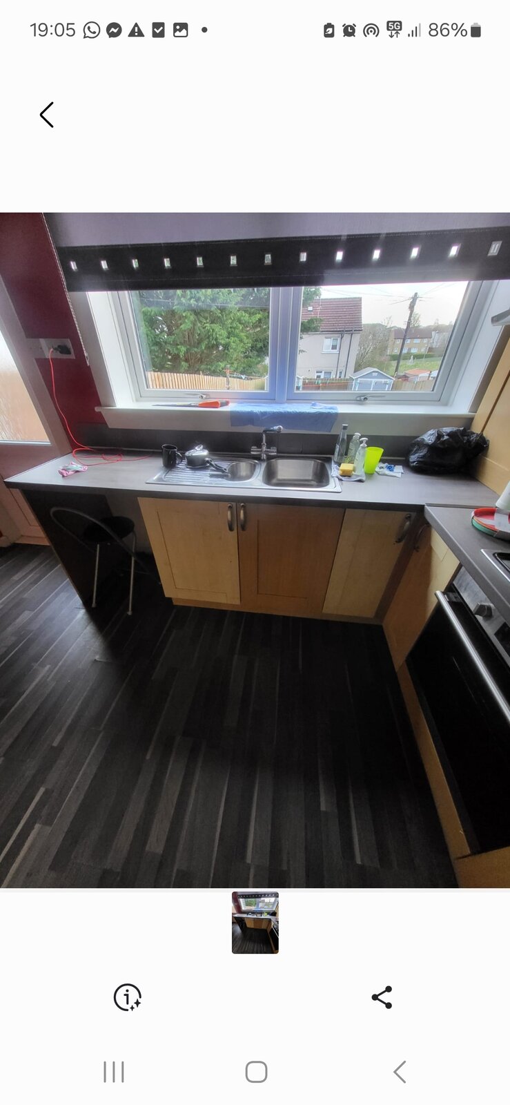

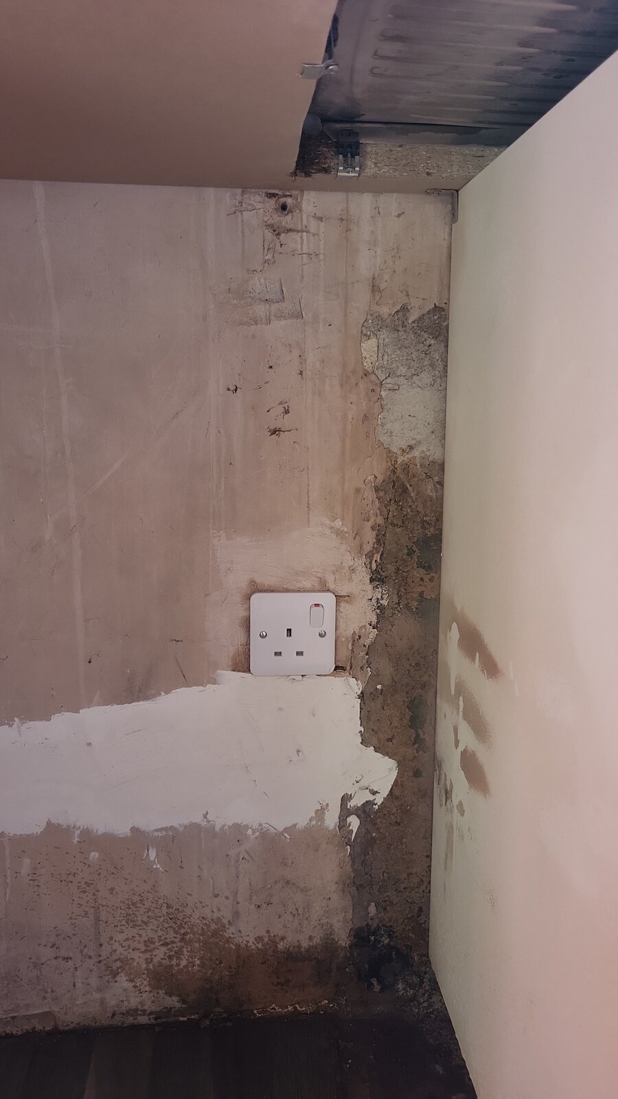

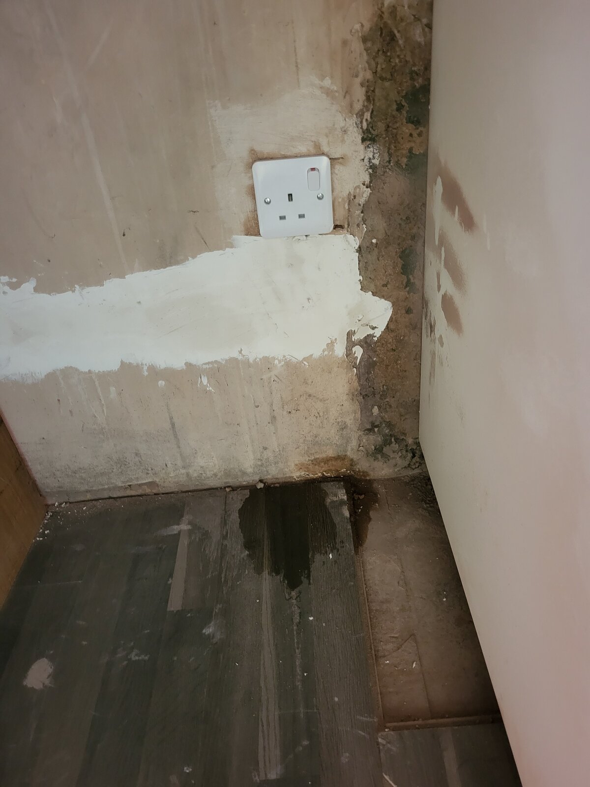

Hi all
Just wondering if anyone has any idea where this water patch could be coming from to the left of the sink?
Is there a soil stack in that corner, behind the panel; or a blocked gutter somewhere above?

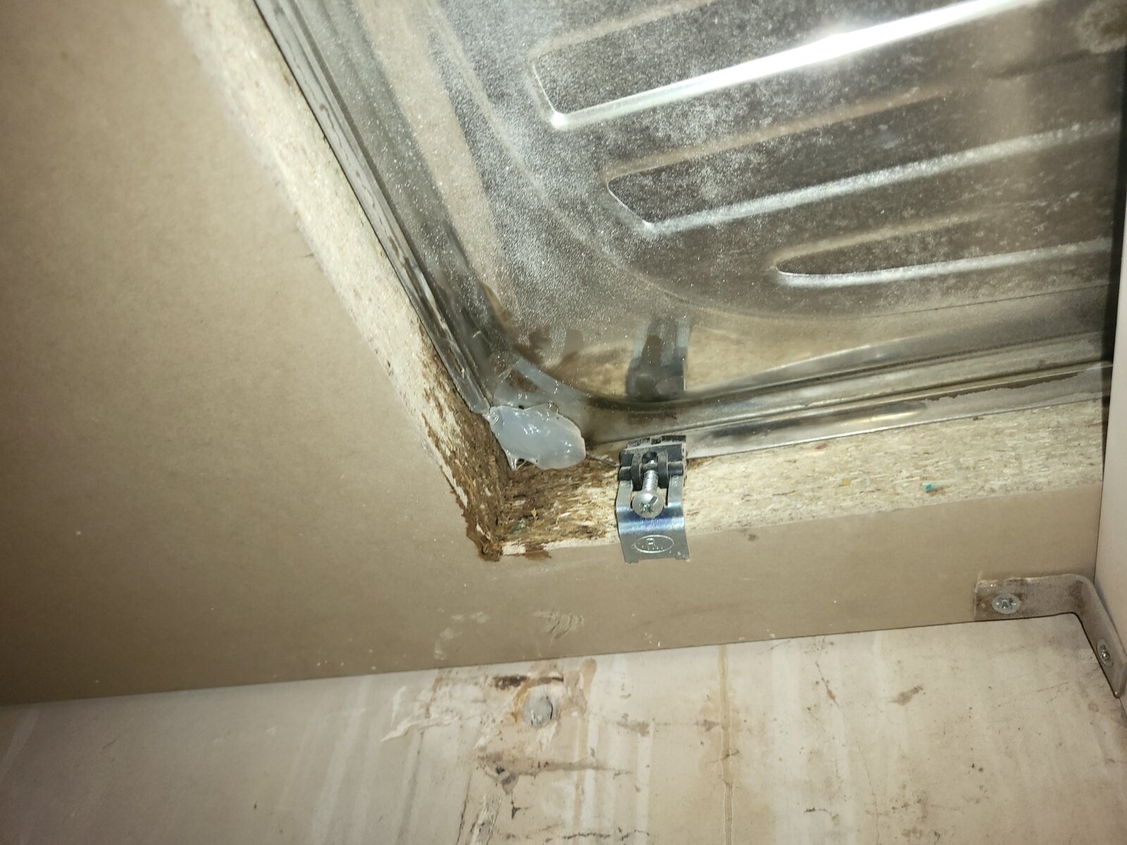

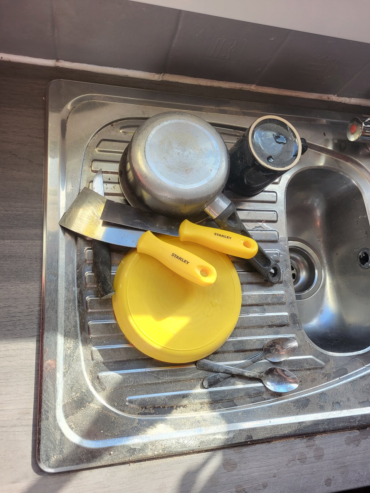

I discovered it was from the corner of the sink where water was leaking from, and yiu can see the POOR diy job by last owner by sticking that blob of silicon in corner to stop leak, well that's what it looks like. What are peoples thoughts and how best to fix long term not a patch up? Thanks all

Thanks. You mean to take out the metal sink area? When you say clean it up, what do you mean?
What about if I just put silicon around it as it is?
Take sink out, remove old silicone, clean it all up, make it dry and then put new silicon in?
Wood is totally rotten where the waters got on it for years. So what to do about the wood.
Have to buy a new work top.?
Could I just get a work top going up to cupboard and leave the one the gas cooker is attached too?
As wood is totally rotten.

You could do that. You might find it difficult to get an exact match to the worktop, and it might be a good idea to fit a new, proper flush mount sink. From what I can see in the photo - that one may have been designed to mount directly onto a bare unit, rather than set into a worktop.
Depends how far you want to go. If you clean round the sink, dry it properly and seal it with good quality silicone, that should do for now. Doing it properly is a bigger job.
A proper flush mount sink? Is this better than a regular one? I really want one I don't have to worry about leaking around silicon area again?
You would have to to check, whether it is, or isn't intended to be mounted flush - difficult to tell from the photo, but a flush version has a wide lip around the edge, to enable a good seal to be made against the worktop. When I have fitted sinks in worktops, I have always made a point of sealing the raw cut edge of the worktop too, just in case of leaks..

You can, or you can unclip the sink as suggested and clean off the old and run a bead round the edge then sit the sink down on it. Neater job but running a bead around as is will work just as well if not better
