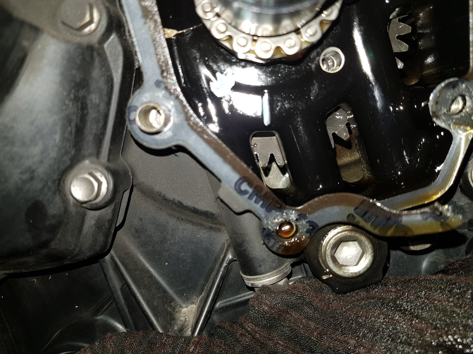

Had to do a camchain on that as well at 60k, it had stretched (1/2 tooth out on crank markings which is a lot!).
Modern fuel is crap and goes off very quickly, worth running it every few weeks to mix it round, stop injectors sticking.
I bet theres plenty that just get the book stamped..
That was with cams timed up, dot should line up with the blue line on casing!.
Yeh I put a tensioner on as well, only 60,000 miles.. Never seen on stretch like that before to be honest!.
