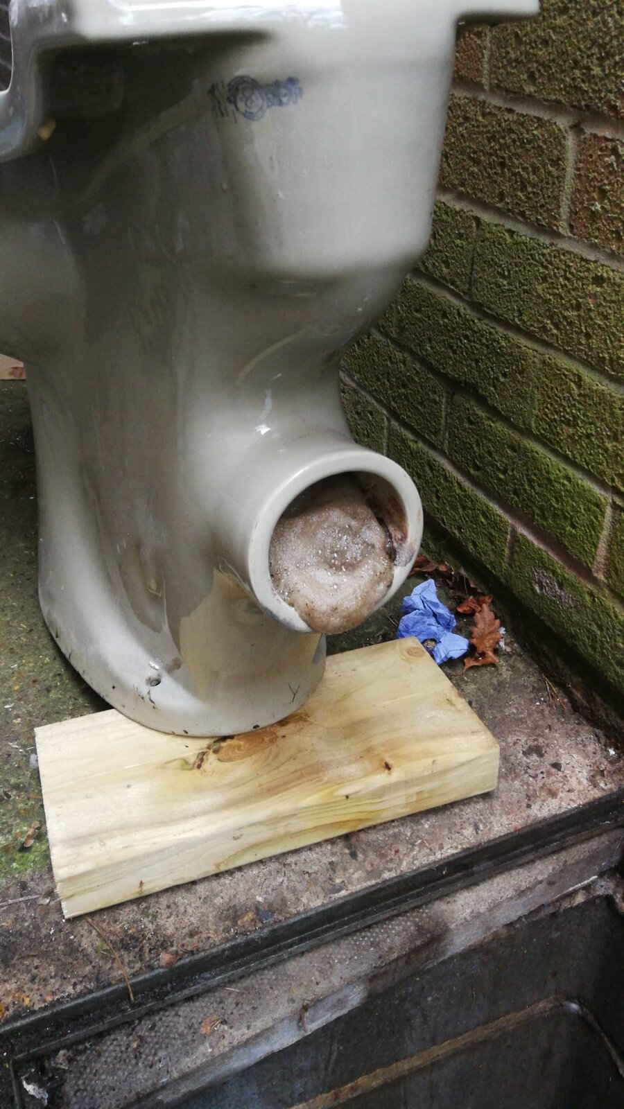

1 cm thick limescale in toilet

I don't see how this can be limescale - unless the water in the toilet is heated to boiling routinely. No matter how hard the water is, limescale only precipitates out when the water is boiled - hence it accumulates in kettles. I've never heard of it accumulating in toilets.
My money's on cement being dumped into the toilet by a cowboy builder at some time - and some of it set before it could be flushed away.
That will explain the difficulty in removing it. Probably only a strong acid like Spirit of Salts (which is hydrochloric acid) will shift it - not vinegar (acetic acid) and not citric acid.

Hydrochloric acid is the best way to dissolve lime scale and will do it quite quickly.
Best supplied at a 32% solution.
Only needs about 10% solution for a toilet bowl and as it produces calcium chloride that is very soluable and does not prevent the acid reaching the limescale.
It can bubble quite a lot so needs to be applied slowly to see what happens.
Because I use a lot of it then I buy it in 30 litres of 32%
It is what is sold as brick acid so that could be used. Also available sometimes in 1 litre bottles.

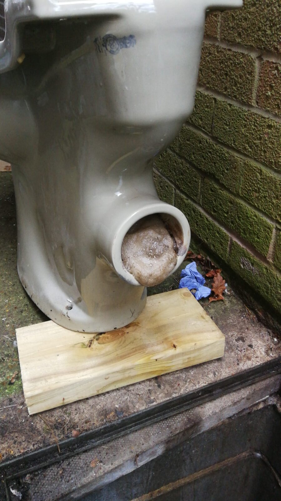

Bought on Ebay 3 bottles of Kilrock Spirits of Salt which gave a bit of result.
Bought on Toolstation a tin of Brick Acid but when I went to collect, they refused to give it to me, "not possible, you have to be licenced bla bla bla" and refunded. Managed to find some on Ebay, it will be delivered today.
I would like to know where all of you buy your acid because so far only Ebay has been good to us!

Can't see that being limescale, but your acid would eat it faster if you seal the exit up (wrap the end in something that will not be destroyed by the acid you choose) and tip the toilet up so you can fill it with acid and let the deposit sit in the acid. This will work better than applying a thin layer of acid to the surface of the deposit, as the fizzing you see is the small amount of acid applied being used up and converted into a salt plus plain old water.
If the deposit were immersed in a large amount of acid then it would be a lot less labour intensive a way to ensure that the deposit was constantly taking part in a chemical reaction
