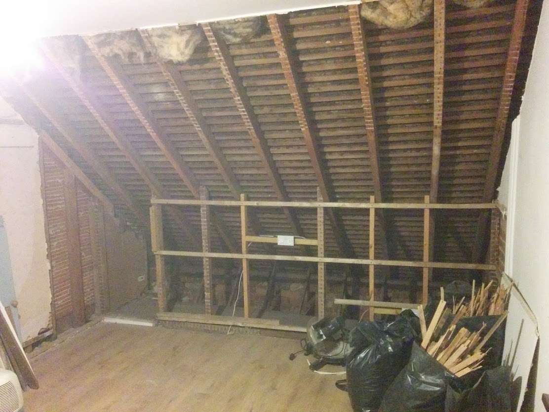

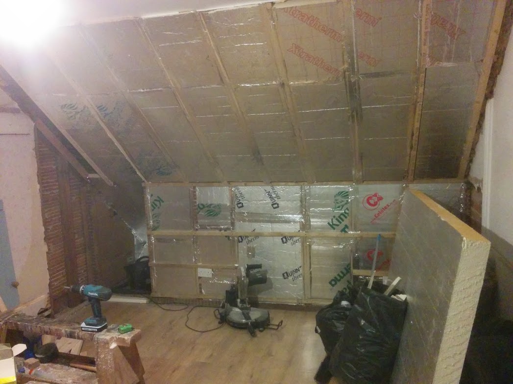

100mm insulation between 5x2 rafters too much?
14 Sep 2010
7,034
877
Rochdale
Would that leave me too small of an air gap between the insulation and felt?
Should be okay if done carefully, or you could add an inch batten to play safe.
What sort of insulation are you using, if 100mm mineral wool, how about 75mm PIR board as will have about the same thermal qualities.
It's Ecotherm PIR board. I was looking for 75mm but found a bulk of 100mm for a good price.
I would and have done in the past battened out to allow the ventilation gap of 40-50mm. Its unlikely you will get exactly 52mm timber to match the existing rafters, so you will have a bit of a gap either side of the PIR board at the face, that if you want to fill will expanding foam. I didn't have to as i was lucky and able to machine wood down to 52mm.

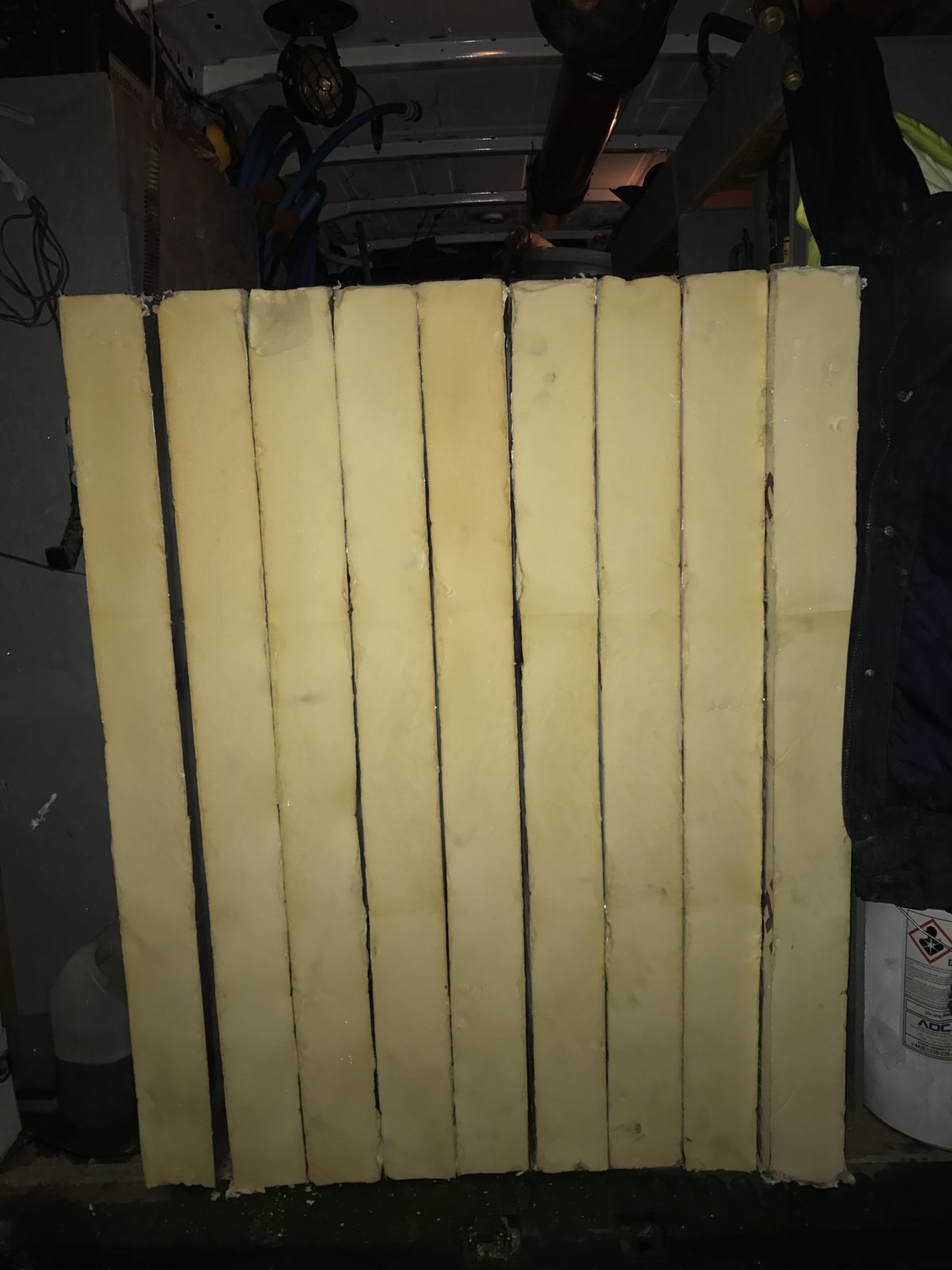

9 pieces of 100mm only just fitted it my van.
Crap spatial skills Ian. Cut some of the boards to 10mm wider than the joist gap, and you can get a few more boards in there.

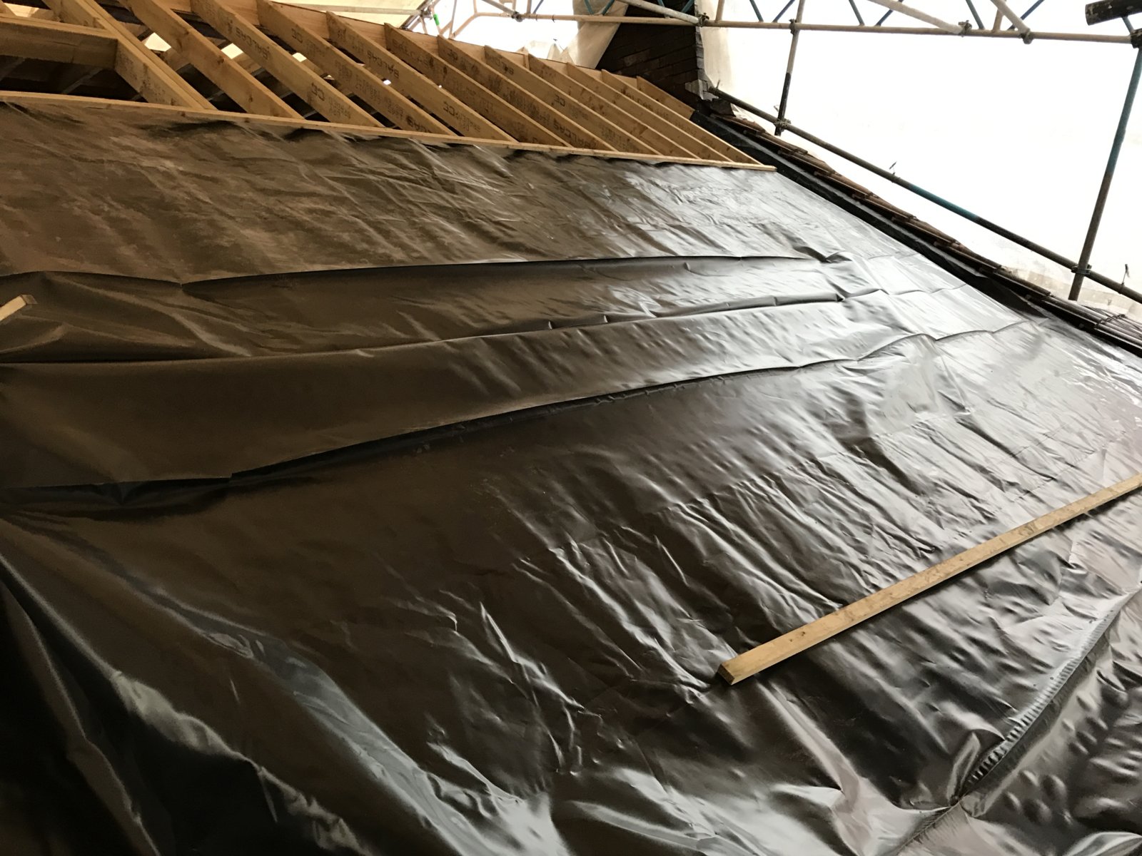

The condensation on our fancy scaffold is a pain. I just sheeted over the rafters to catch tomorow mornings drips.
