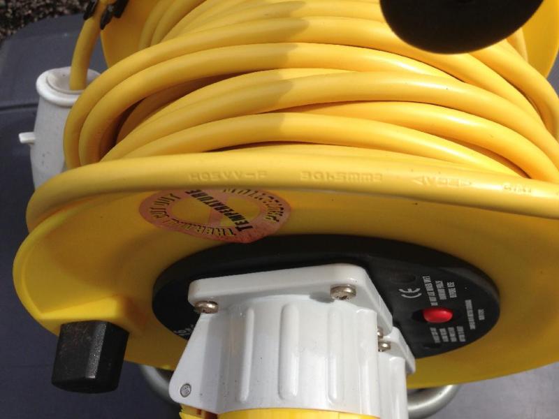

I want to get about 50m of flex to use for a garden appliance extension lead, and thought I'd use yellow arctic. I also want a reel to keep it on when not in use.
it looks like it'll be cheaper to buy something like this:
ae235
and dispense with the 60309 connectors than buy a length of cable and a reel.
But am I right in assuming that the cable itself will be regular Arctic stuff, not something genuinely only any good for 110V?
Yes, just standard arctic - but get a decent brand. Some of it is not very flexible to begin with, let alone when cold!

1) I want yellow Arctic because it's nice and flexible - I have an old length of orange flex, and that isn't particularly.
2) I'd still have to remove the end from the socket(s) on the reel and fit one half of this:
Even in terms of 'rating' (which probably really only reflects what tests are undertaken), I would imagine that it's just bog-standard Arctic.
However, in terms of what voltage the cable is "good for" (which, after all, is what actually matters), would it not actually be pretty difficult to manufacture a 1.5mm² or 2.5mm² cable which could not very easily cope with 230V (or, indeed, far higher), regardless of the 'rating'?

The 25m extension reel I bought from Screwfix looks very similar to the 50m one Bas uploaded a pic of, the cable on mine is H05VV-F normal PVC.
The cable feels flexible at the moment but it is fairly warm.
3G1.5mm² - made in China
