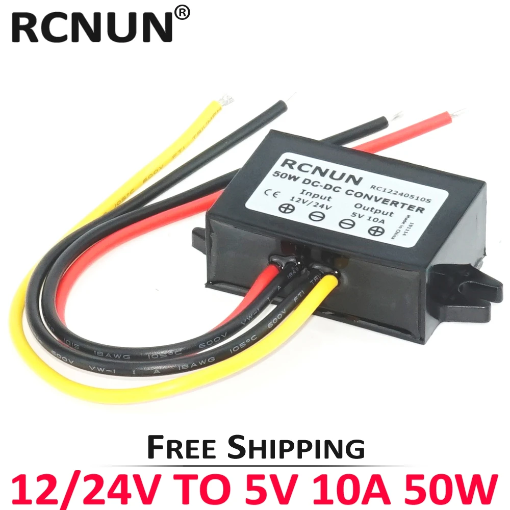

Thanks, that's helpful - Perhaps 24V over Cat5 with a small 5V converter like the example below tucked behind the 'load' e.g. the alarm or touchscreen panels I'm considering?
https://www.aliexpress.com/item/329...exp_id=41967241-9058-4e26-9882-17963224a7a0-0
RCNUN-12V-24V-to-5V-3A-5A-10A-Step-Down-DC-DC-Converter-Regulator-50W-24.jpg_Q90.jpg_.webp
I would not want a power supplies from ebay/aliexpress in my house...I'd want to see a proper datasheet showing the spec.
