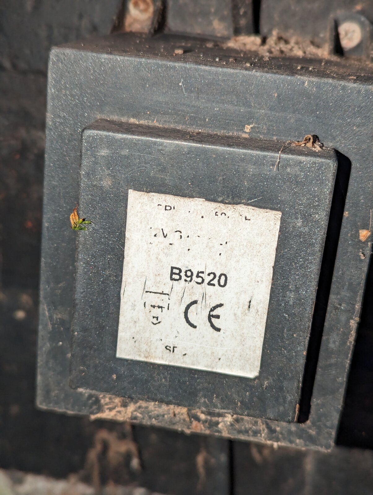

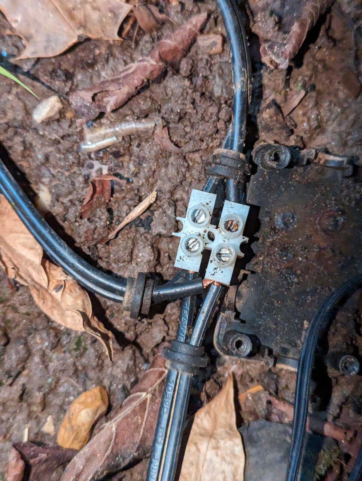

Hi @SUNRAY I've attached a picture of the transformer and the type of cable. It's a Ring Select-a-light system. I'm assuming it's this: https://12vgardenlights.com/blogs/n...r-failed-or-thinking-of-upgrading-your-lights
I have the manual which says to use 12v cable. Thanks for your help.
Looks to be AC
There is a rib on the bottom cable on the righhand conductor but this rib is on the top left. So I would suspect AC and either way should be OK.

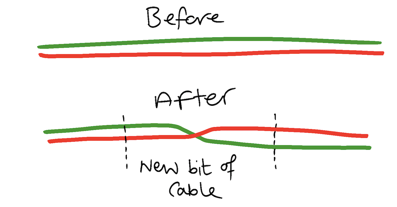

Thanks @Deryck Tintagel for the reply - when you say it should be OK, do you mean I don't need to worry if the two cores of the wire have swapped over by accident (like in the poorly sketched image below)!
The system had 8 post lights with halogen G4 bulbs. I've swapped them all out for LED g4 bulbs and I'm adding 8 LED spotlights. So I feel ditching the halogen should mean the transformer will be able to cope. Annoying the label has come off! I have a multimeter - wondering if I can use that to measure the wattage of the transformer.
Yes, the wires are swapped per the sketch and for SELV using AC it makes no difference. The new LEDs are not polarity concious as the pins coud be pushed into the holder either way round. Providing the LEDs are OK for AC then you should be OK.
I guess you have already had the replacement LEDs working?
Looking at the transformer and based on the fact you already have had 8 G4 halogen running I would say you have something like a 200W transformer so will be more than plenty for additional lights. LED G4 are probably 2W each so need 32W to power them. You might consider changing the supply to something smaller.
