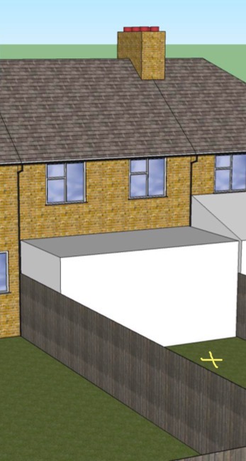

Sorry not the best at describing things. I built an extension on the back decades ago, which is 15.7Sqm inside. Now I want to put a shed up where the yellow X is that’s 7.5Sqm. Does the shed have permitted development rights ?

I went off and found this and looking at section E, you are right.
From memory the 15sqm permitted development rule went out about 30 years ago.
Now there are a whole host of rules including separate rules for outbuildings so the size and position of the shed will be taken on its own irrespective of any extensions.
This provides some guidance ......... https://interactive.planningportal.co.uk/mini-guide/outbuildings/
