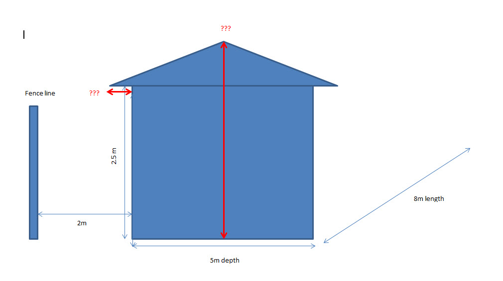

Correct and apologies if the mentioning of the area size caused confusion. I was simply stating the facts so its clear to all. I've clarified the original question slightly.
In summary, the issue (or my question) is not whether the overall size is allowed under PD, because I know it is given the large size of the garden and the <50% rule that Tony mentioned.
I guess my question should, in a roundabout way, be, 1) how much further away should the actual wall be from the boundary if this outbuilding is going to have eaves at the 2.5m height level and have a dual pitched roof, 2) what is the typical width of the horiztonal bit where the wall is to the underside of the roof (hence adding to the distance taking it closer to the boundary) and 3) what is a suggested roof pitch degree that I should outline?
I appreciate your help, I'm just a homeowner and not a architect so apologies if I am asking this the wrong way but hopefully you understand what I am trying to ask.
Thx.
1) the height of the eaves should not be >2.5m, regardless of how close to the boundary the structure is (any projection of the eaves is usually ignored - it's the distance to the face of the wall that matters).
2) if any part of the structure is within 2m of the boundary, no part of the structure should be more than 2.5m high.
3) for a dual-pitch roof, the maximum height allowed to the ridge is 4m. But to achieve this, all parts of the structure must be at least 2m from the boundary.
(assuming you are > 2m from the boundary and want to have a 4m ridge-height, the pitch would depend on the width of the building).

I'm really trying to reverse engineer it.
I know for a fact that the dimensions will be 8m long against the fence line boundary and 5m deep coming away from the boundary into my garden (allowing for an additional 2m distance between the start of the wall and the fence). I want to keep to a decent height ceiling so 2.5m at the eaves would be fine. The maximum height allowed would be 4m, but of course if I can get it under that height, then all the better so neighbours dont complain.
The bit I am trying to establish is what degree pitch would I need to keep it a good overall height level much below 4m if possible. This is more a math and trigonometry question that I cant answer!
5m at 45 would add 2.5m
5m at 22.5 would add 1.25m so reverse engineered allowing for roof thickness around 2.6m from the ground it covers assuming a timber floor and joists off say 200mm would be 2.4 ish
Here's something I prepared earlier....
Going by Tony's earlier helpful comments, it seems that I would need to move the outbuilding further away from the boundary line in order to allow for the underside of the room. How much should I allow for that, another 0.5m?
Is there such a thing as a right degree pitch for the size of outbuilding I am building?
and the gutter
is it your fence ??
if so then the boundary is the other side off the fence assuming its fully on your land
wow this becomes more and more complicated. Yes, it is my fence line, although to make sure I dont fall foul, I might just move the whole bloody thing more onto myside. What is usually the depth of the bit I have marked with the red arrows, fence side and what is it called - "Depth of eaves" or something else?
Builder is saying a minimum of 30 degree pitch is needed.
You don't need to allow for the eaves soffit in your calculations (unless that eaves soffit projects more than a metre!). From the information provided, the permutations would appear to be as follows, so take your pick...
