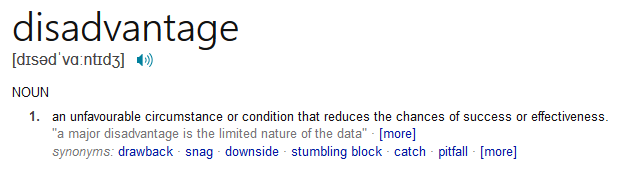

If in the context of the successful or effective operation of a consumer unit there is an unfavourable circumstance of such vanishingly small probability that it is more likely than not that someone would never encounter it then it is not a disadvantage worth considering or mentioning.

My basic question to you, all along, has been WHY is it a disadvantage to not be able to tell from looking at the device if a trip was caused by overload or fault.

If that were the case then by how much would that instance reduce the chances of success or effectiveness of the device helping someone find the cause of the trip?
