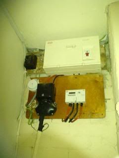

The pictures below are of the E7 setup in my dad's maisonette, which was installed by a firm.
The E7 Setup:

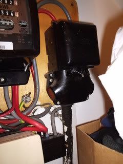

Meter wiring:

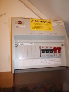

The Off Peak Heating CU:

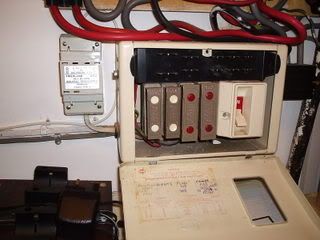

The Peak CU (An old metalclad MEM):
The current CU in my nan & gdad's maisonette is the same as my dad's peak CU.
What I was going to do was to run in the storage heater cable, from the cu cupboard to where the DP SW for the Storage heater is going to go. And also run in the cable for the 2 smoke alarms (but not wire up), And then get in a spark to change the Old MEM CU for a Crabtree Split Dual Tariff CU, & connect up the storage heater & smoke alarms, & to sign it off.
Then get the DNO in to fit a E7 Meter & Radioteleswitch.
Would this be ok :?:
Should I have an isolator fitted in the tails to isolate both the Peak & Off Peak supplies at the same time :?:

I'm going by the type of isolator which I have seen being installed to some premises with E7, some piccys on here I have seen a DP isolator isolating the phase from the normal and the phase from the E7.
Not 100% sure what the regs are on this, I was on the understanding that if there are more than one isolator to kill the installation then warning notices should be posted.
The GN (I am told) advises either one point of isolation OR notices to warn that there is more than one POI.
