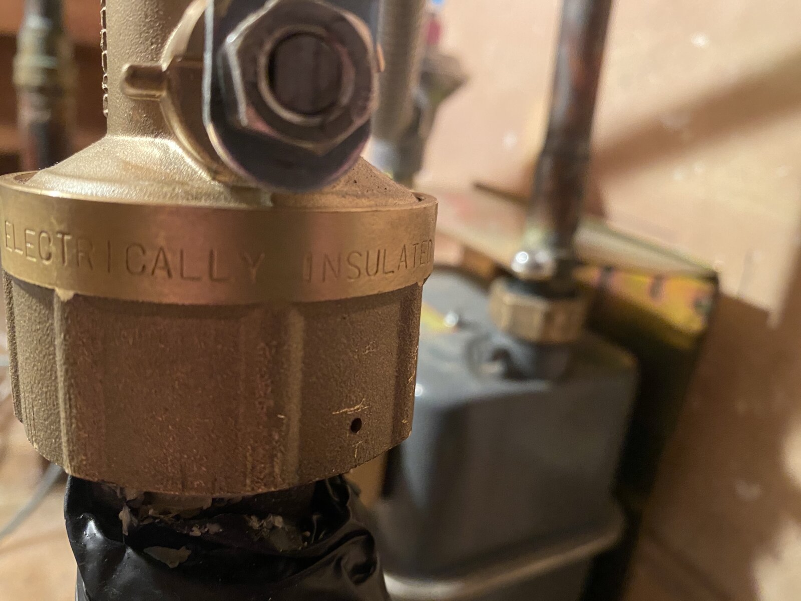

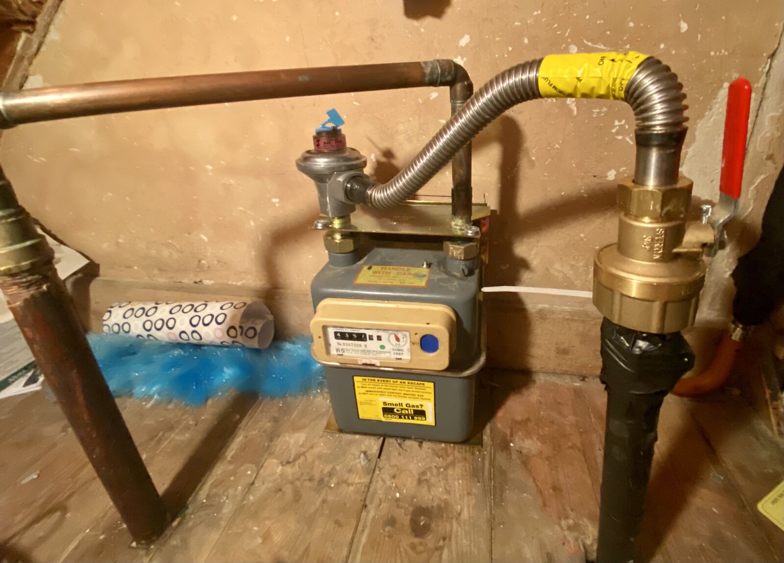

Evening,
SGN have replaced the street's gas pipes by feeding a new PE plastic one in through the existing steel pipe. The meter is in cupboard under the stairs. TNCS earthing.
SGN have fitted a new 'electrically insulated' head just before the meter. I have tested and there is no continuity between the steel supply pipe and the consumer's pipework on the other side of the meter. The consumer pipework does not re-enter the ground after this insulated section. Consumer pipework is therefore not extraneous nor require bonding as per 18th ed 411.3.1.2.
That leaves the 20cm of original supply pipe. I have tested and it has resistance of 0.0012 ohms to the MET so is an extraneous conductive part.
When SGN finished, they half taped up this supply pipe in black insulation tape.
Would you:
1) Bond the supply pipe before the meter?
- Disadvantage being it's technically against 544.1.2 as before the meter outlet. And as I can't imagine the neighbours have suddenly switched round their bonding, this steel gas pipe might act as an earth rod for the street should there be a lost neutral. I don't like the idea of the diverted neutral travelling in an old rusty-jointed steel pipe containing plastic and gas.
2) Alternatively, forget bonding and finish wrapping the supply pipe up in tape then wrap again in self-amalgamating tape.
- That way at least no diverted neutral currents would flow down pipe and there is no risk of earth potential if you touch the tape. Disadvantage being the pipe is only safe as long as the tape remains in tact to protect it.
I'm struggling to see how SGN can do this work and potentially leave each house with a 'new' conductive part now isolated from any bonding that might have been present?!

Technically, yes. As you say, there is 20cm of extraneous-c-p, and, regardless of confusion created by the regs, in electrical terms that clearly should be bonded.
... Disadvantage being it's technically against 544.1.2 as before the meter outlet.
Quite apart from the confused/confusing (and essentially incorrect) wording of the regs, there is nothing there to say that you can't bond whatever you like (in addition to whatever the regs appear to require!) - and, as above, bonding of that small bit of extraneous-c-p is, in strict electrical terms, 'required'.
Bonding on the consumer's side of the meter would obviously be silly in your case, and (despite what many seem to think) nor is it actually required by the regs. 544.1.2 (and other regs) only relate to main bonding when it is required (to bond extraneous-c-ps). Nothing in the regs (not even 544.1.2) requires one to main bond something which is not an extraneous-c-p.
That's my view, anyway!
Kind Regards, John

Thanks all, I'm inclined to agree.
My concern is while it is only 20cm of pipe, it is unfortunately very accessible at entrance to a small cupboard where one would likely have a leg or foot in contact with the pipe whilst touching the metal CU on the opposite wall.
And as you, with a lost PEN, if I bond it I don't fancy the pipe being the earth rod for the street, especially as the neighbour's pipes are now likely to be insulated and not bonded.
I think I will get back to the distribution company and ask them to sleeve/insulate the pipe, though I expect some push back and and probably be told it is an 'electrical issue'. Interestingly, if you look at IGEM G/5 Edition 2 guidance for multiple occupancy buildings, 11.2.3 states:
"exposed pipe between the ground and insulating fitting shall be encapsulated in an approved insulating sleeve or otherwise protected to prevent physical contact with surface of the pipe. The wrapping shall be marked 'electric shock hazard, do not remove'".
I wonder if there is an equivalent standard for single domestic dwellings. Might explain why they at least partially covered the pipe in tape!

However, the OP has indicated that this bit of exposed pipe and a nearby metal CU could easily be simultaneously touched by a person, creating the (potentially fatal) electric shock hazard which is the very thing which equipotential bonding is designed to eliminate.
As the OP has said, the ideal solution is to get the exposed bit of pipe insulated but unless/until that happens, one has to balance the risk of electric shock due to absent bonding with the risks resulting from potentially high currents flowing through the bonding conductor.
Edit: I should have added ... The balance that needs to be struck is not peculiar to the OP's situation. IF one adopted your "It most certainly is not" view, that would presumably mean that one felt that one "certainly should not" main bond any extraneous-c-p in a TN-C-S installation - which I would imagine/hope is not your view, is it?
