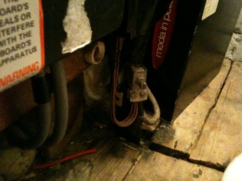

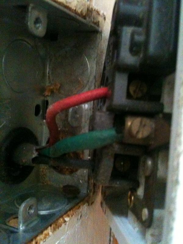

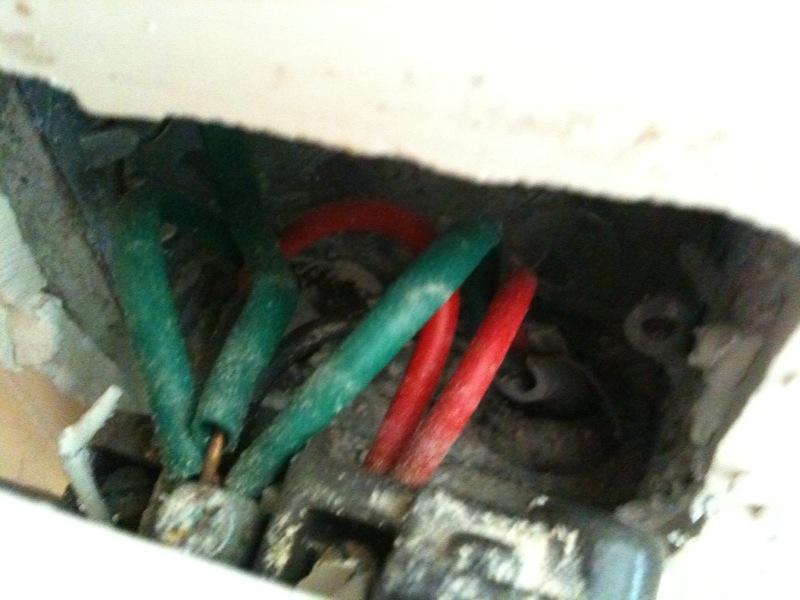

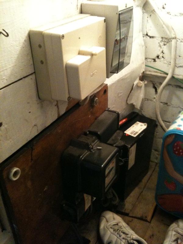

That looks like cable of imperial size and they stopped selling it in the early 1970's and green sleeving stopped in 1977, so there is a good chance the electrical installation is over 40 years old - past its sell by date.
How long are you planning to stay in the house and are you planning any alterations to the electrical installation? If you are planning to stay for many years or make alterations then I would be inclined to re-wire, rather than finding you have to do it in 5 or 10 years time after your house is redecorated.
The only way to be sure is get an electrical inspection done, also known as a PIR or ECIR
Was thinking of staying at least 5 year. I don't know if I can get away with adding halogen lighting and upgrade part of the electrics. I am concerned that it will make a right mess and all the plastering too. At the minute there is horrid wood chip on the wall which will probably make a right mess of the plaster underneath anyway. I need budget for all of it. What would the rough cost be for a full rewire for a 3 bed semi? Will the survey not just state the obvious that the electrics are old and will need replacing?

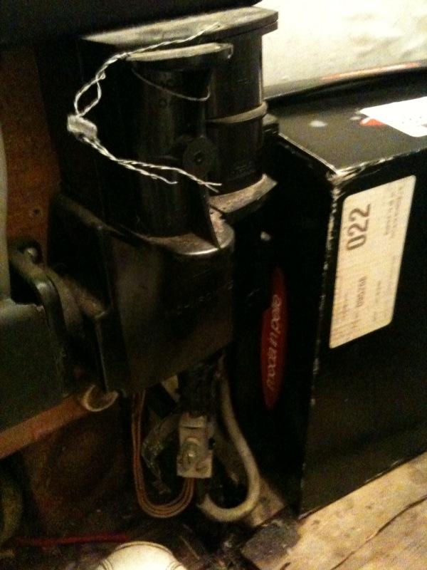

It is difficult to tell just from those pics.
The only way to be sure is a EICR (PIR) but my first reaction is that it might be prudent to consider rewiring and a cost of £3K might be a good starting point + or - a bit depending upon what you want.
My usual answer to "how much is a rewire these days is "about the same as a second hand car!"
... Will the survey not just state the obvious that the electrics are old and will need replacing?
It might make that recommendation and it might not. The inspection should provide an overall assessment of the suitability of the installation for continued use, you might find that the installation is still safe to use.
Send more pictures.

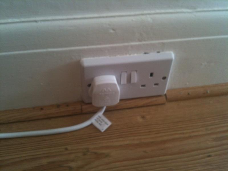

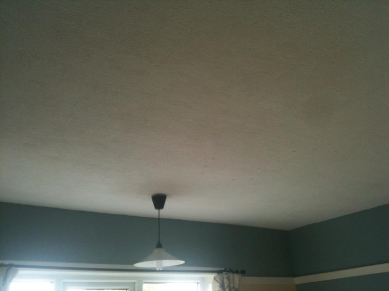

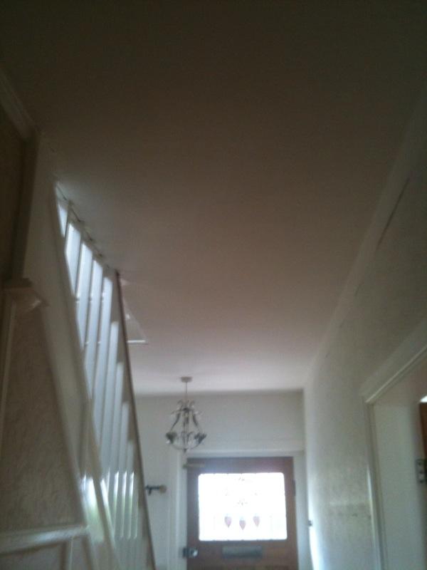

Here are some more pictures - I am looking at moving the sockets from the skirting board to the wall and adding a few more of them too. The lights up stairs are earthed but they are off centre which I assume was normal in the 30's to prevent a silhouette forming on the windows. I will ask around for a quote for a report. I think it may need rewired anyway due to extra lights (halogens in the hall way) and sockets needed or can I just add them to the existing electrics?
If you`re doing so many alterations and additions then rewire from scratch is beginning to sound the best option irrespective
Based on your photos the wiring shown probably dates from the early 70s.
The wiring itself may not need replacing as it doesn't usually deteoriate in the same manner as older wiring.
However, we have no idea if there are other problems without a proper test/inspection. There may be all kinds of things that need upgrading.
If there's a lot of accessories that need moving, and you also need extra ones added, it would make perfect sense to do a complete rewire.
Often when doing all kinds of improvements to an old system it's nearly as easy to replace the lot - though not always essential.
You need to consider how much you want to change on the installation, and get a decent electrician round to weigh up what should be done.
as others have said it would be worth investing few hundred quid to get it all fully tested. It may well be fine. If so then you could get your new lights added on and just go with a fuse board upgrade - saving you lots of £
The cable itself is most likely fine. Afaict PVC cable lasts virtually forever under normal domestic loading confutions.
The fusebox should be replaced to meet current standards but that doesn't really imply a rewire in itself.
Sockets on the skirting board are less than ideal because they can stress the cable as it is tightly bent between plug and floor. You also state that you don't like the location of the light fittings. IMO if you are going to end up moving most of the sockets and most of the light fittings then you may as well rewire rather than end up with junction boxes everywhere.
It was.
If by that you mean 2" diameter recessed spotlights I would strongly advise against. They are actually designed to be deliberately bad at lighting up rooms, and cost a fortune to run. And are becoming more and more unpopular - could be putting off a number of buyers in 5 years time
Recessed lighting is fine, but not in small sizes - look for lights which take PL or 2D fluorescent tubes, or if you want LEDs, again a larger format such as the Philips BaseLED.
