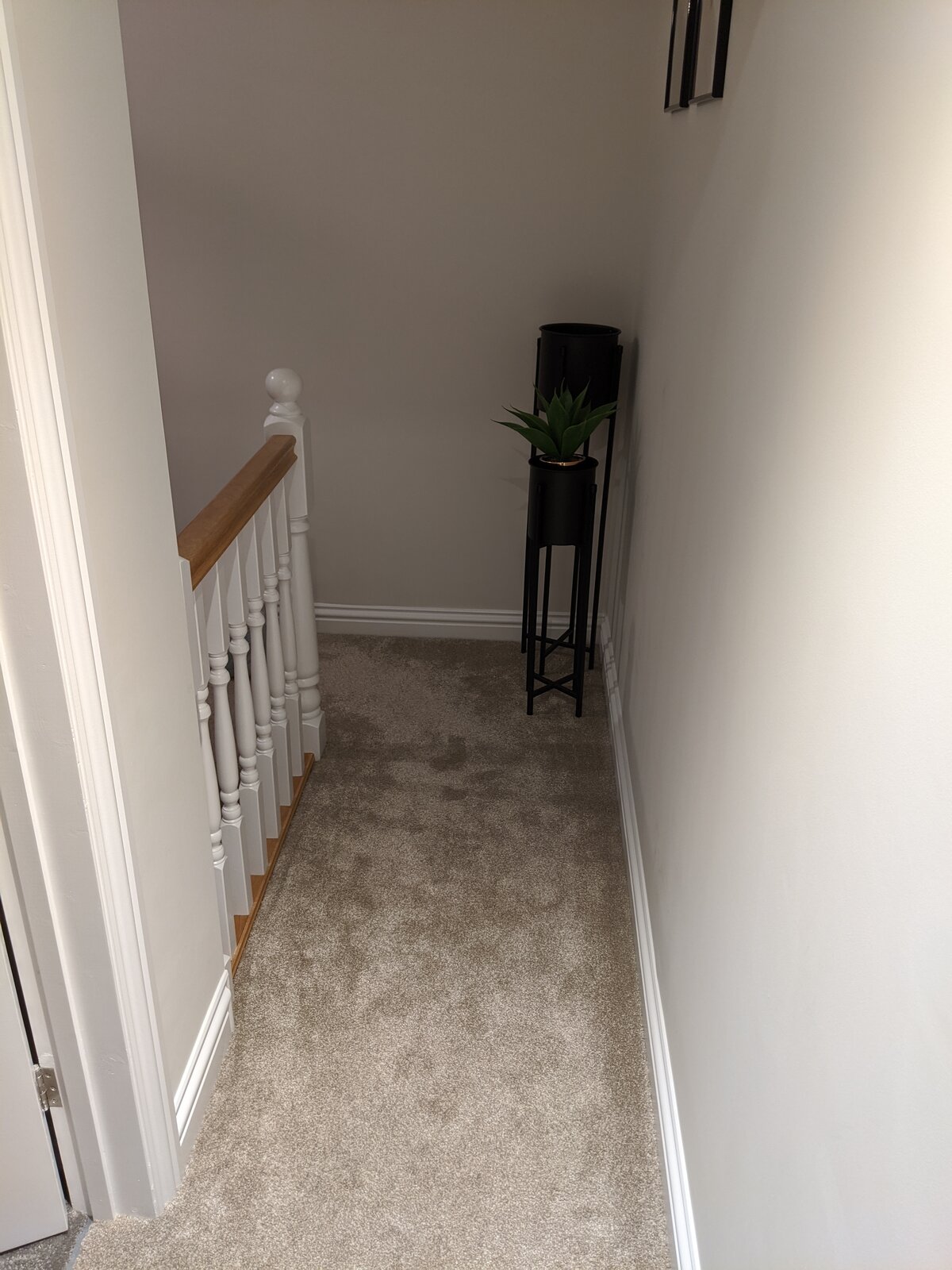

Ours ended up like this and from the wall to the balustrade it's about 830mm. There is plenty of room.

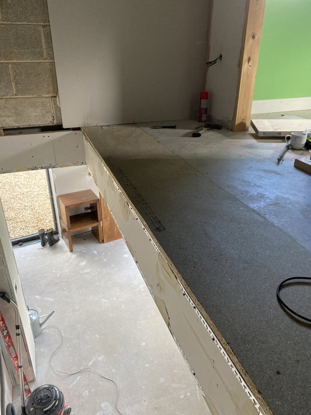

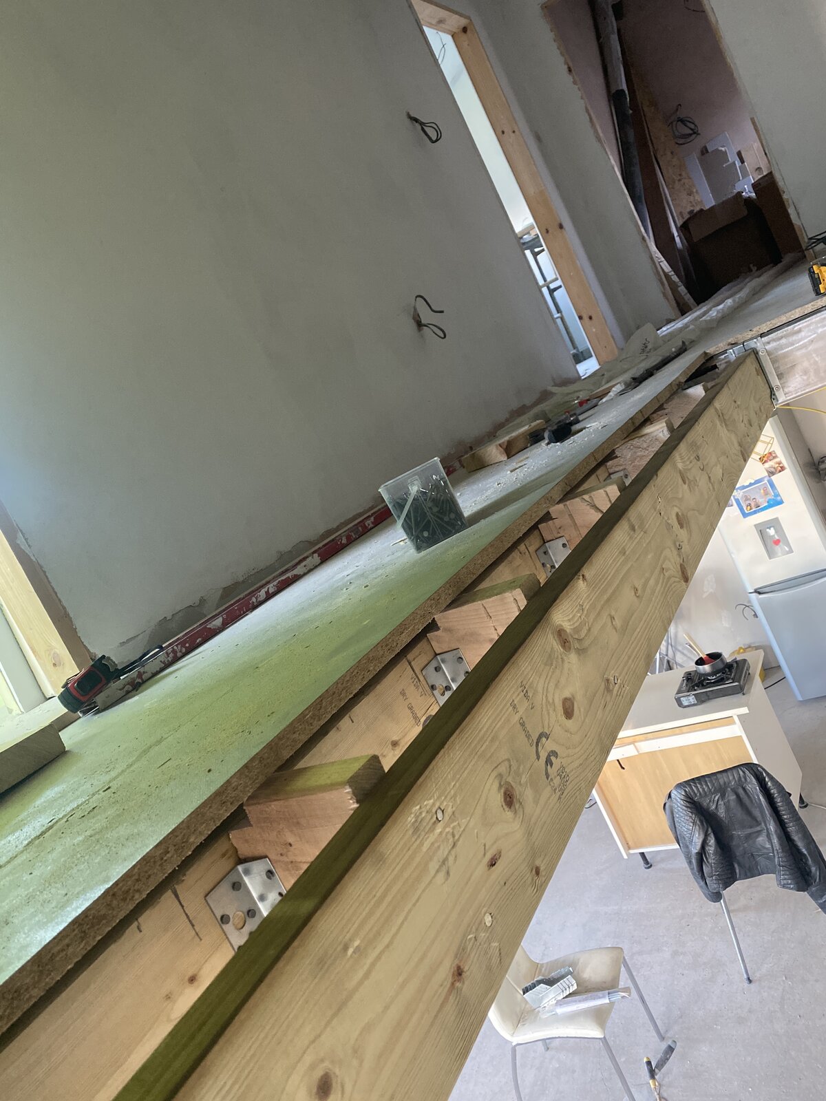

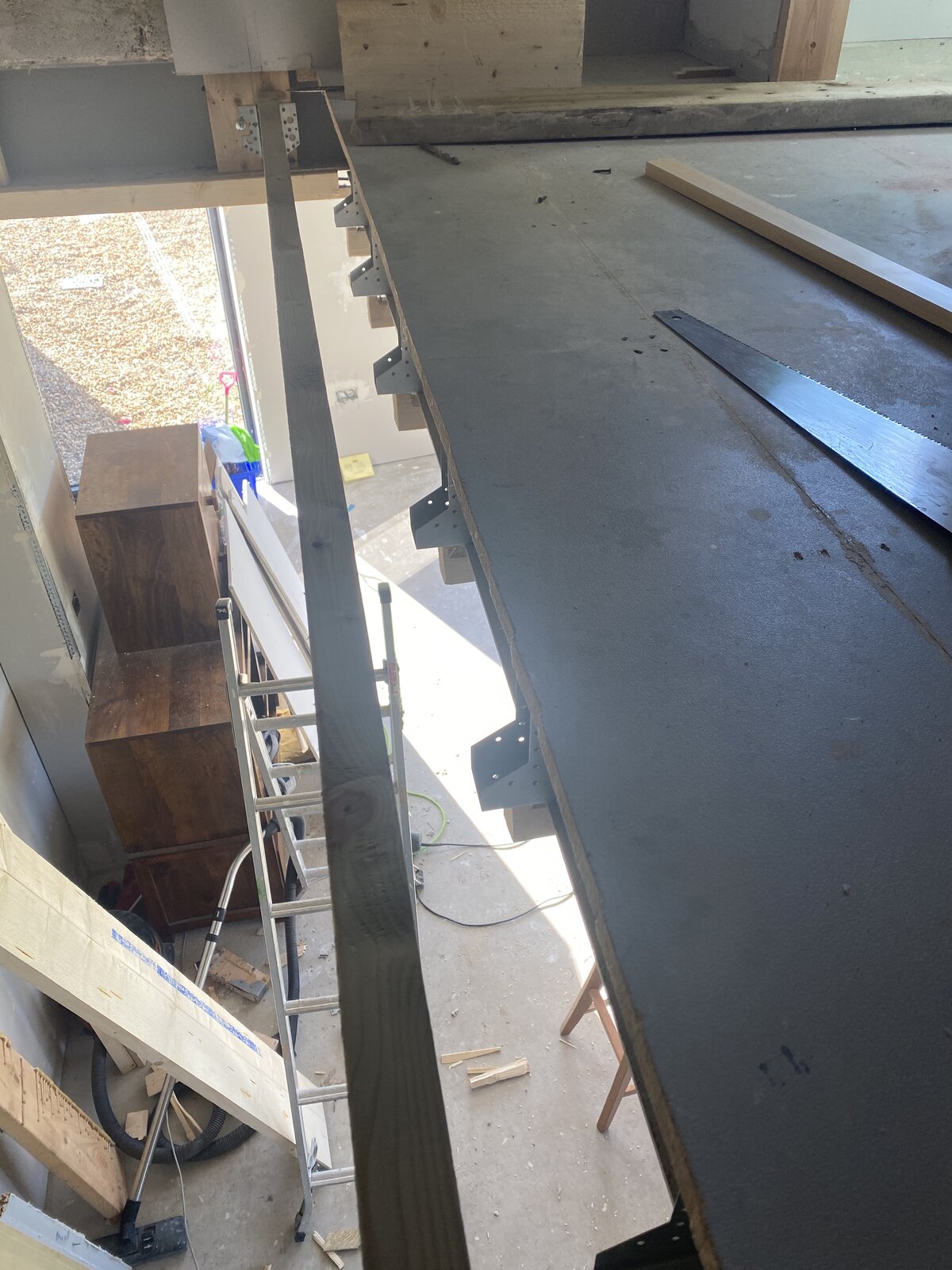

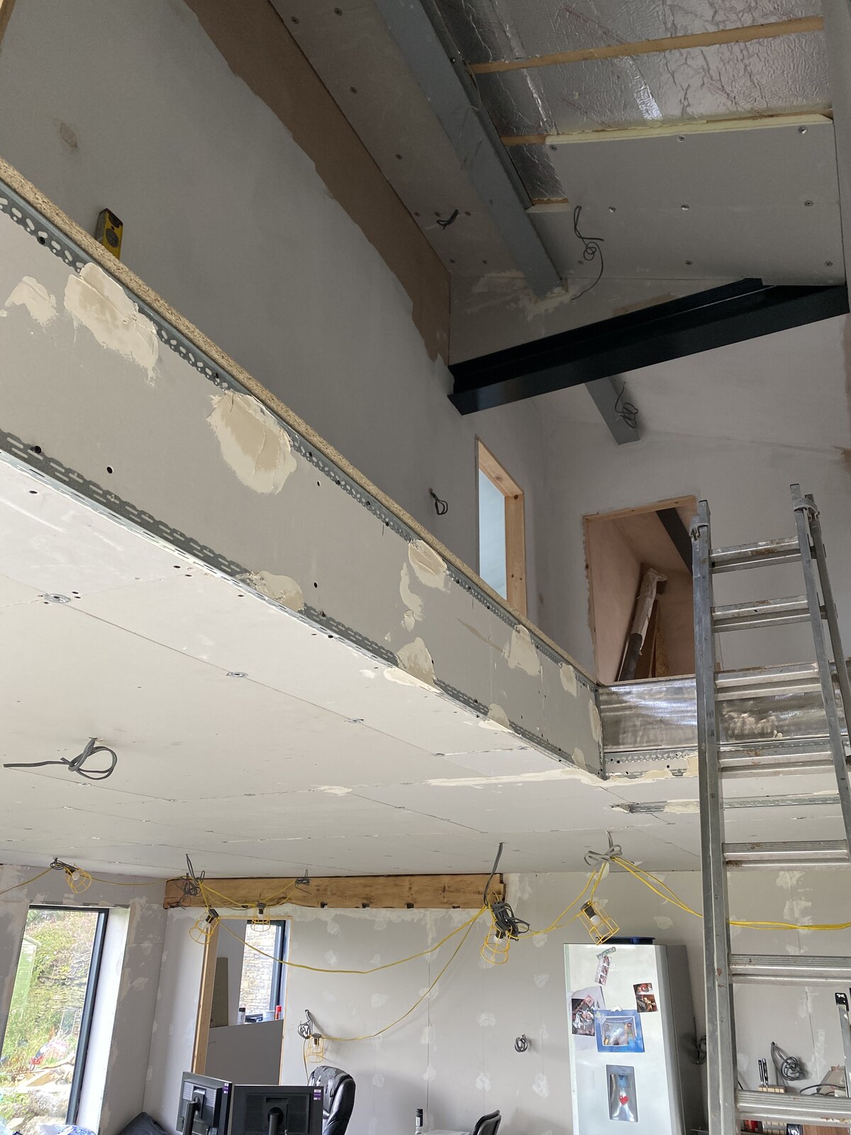

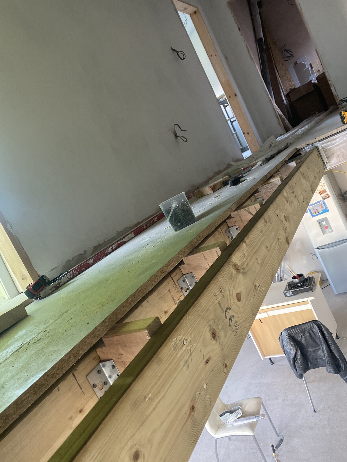

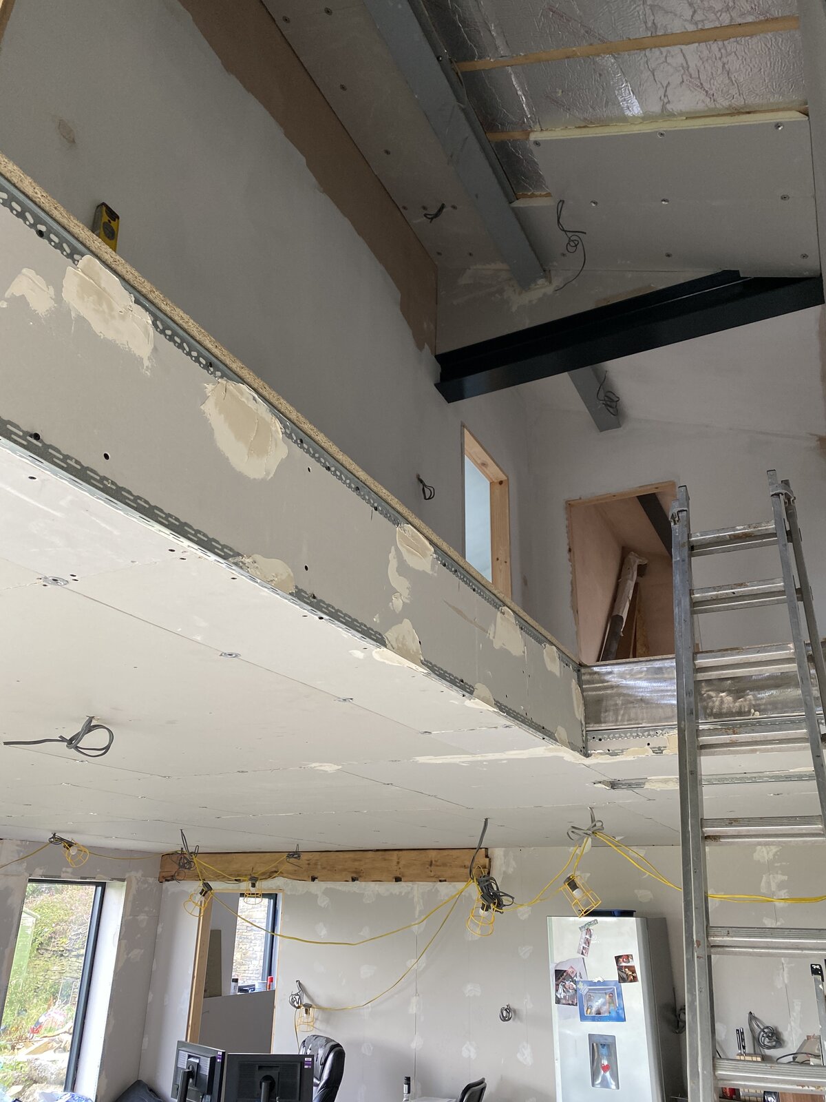

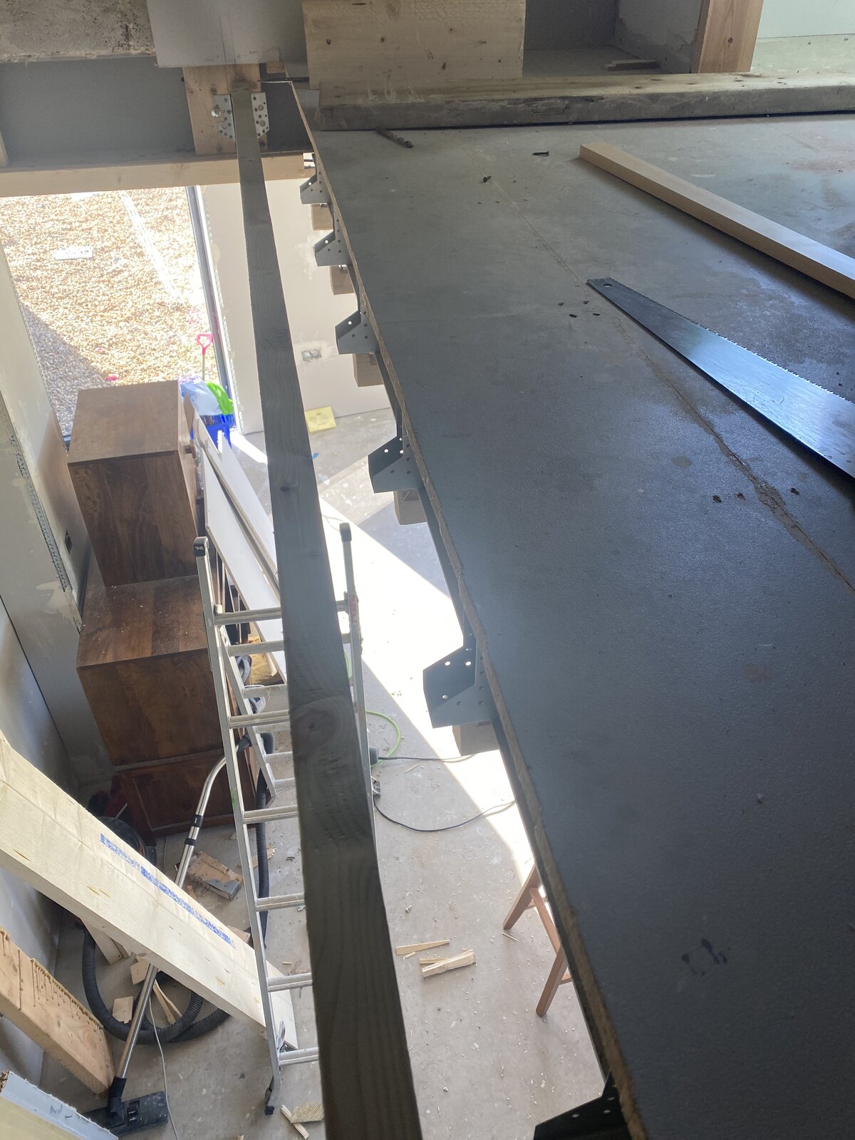

In the end I decided to extend the hall to approx 1m wide. I did this by sitting a joist in the web of the steel beam and bolting through, I then ran another joist parallel and inserted noggins with joist hangers. I then extended the floorboard and boxed round the underneath with plasterboard. 62109967662__5FDEF3B8-412A-47CF-874C-0C2A83C0FB47.jpeg61998516088__AE3AE24A-37AB-487A-8E8E-EB3D05CBA7FF.jpeg62109966044__EA4FD13B-AA81-4E6E-9B0E-6C3B1F74EC38.jpegIMG_3234.jpeg
