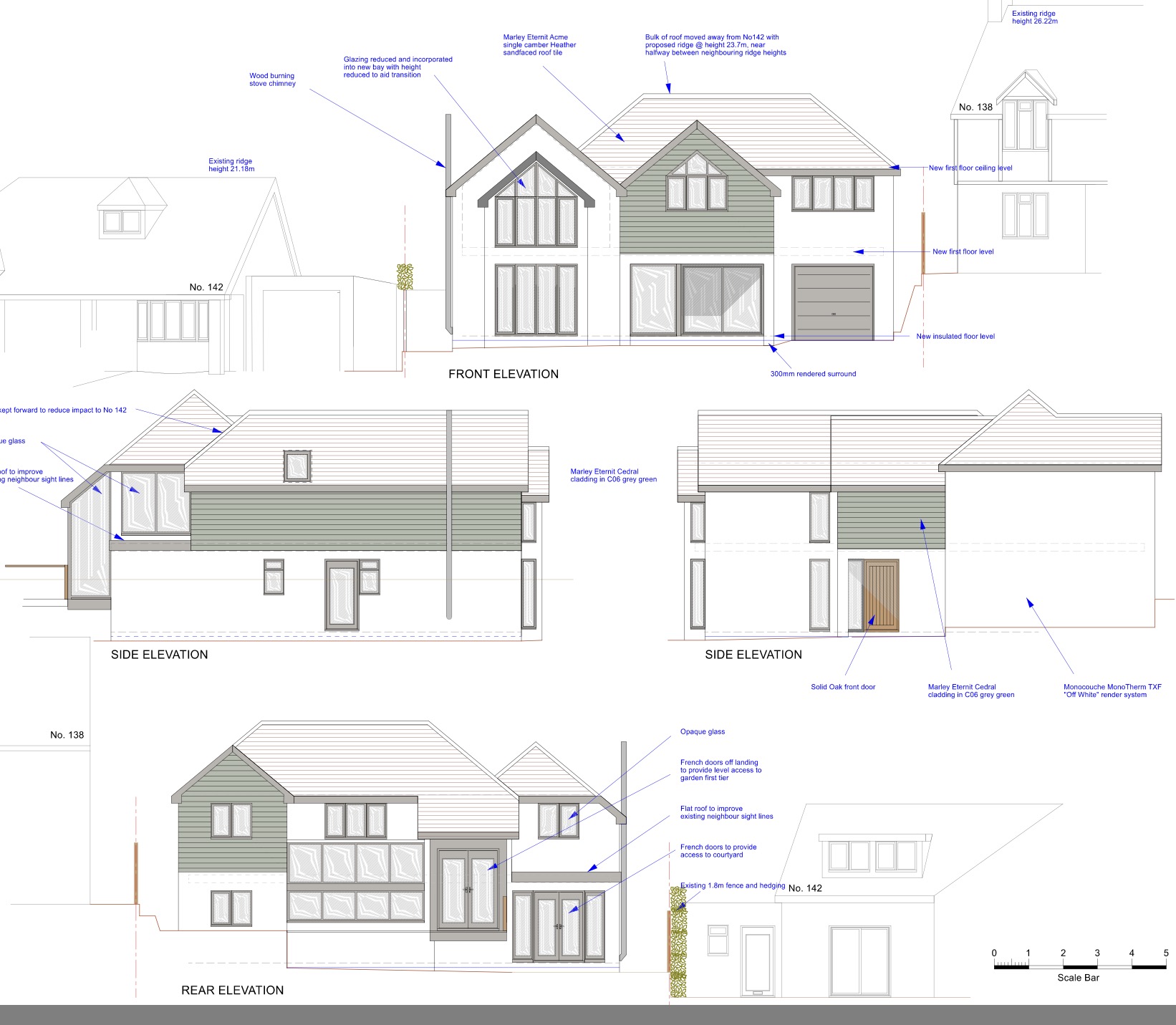

The new drawing looks great!!!!
Is that 23.9mtr ridge height measured from sea level?
I think it is based on a datum point on the topographical survey - not sure what that is based on but I don't think it would be enough to be sea level.
Planning officer coming on Friday as part of the pre application advice - hopefully they will like what we have done and advise on the whether the neighbours objection letter is valid!
