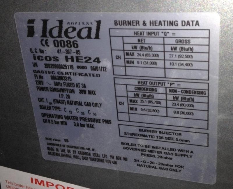

Top Boiler (2006) is an ideal icos HE24. It covers the top 2 floors of the house. 5 bedrooms 3 bathrooms. 3 x 120L? hot water tanks.
//media.diynot.com/50000_49582_44256_55085471_thumb.jpg
Bottom Boiler is Worcester (2009) Greenstar 30CDi. It covers the bottom 2 floors. 2 bathrooms & kitchen. 1 x 270L hot water tank. Provides heat to Uponor UFH manifold.
Not sure if they're modulating....

Total heat available is too much for the building as a whole. The lower-floors boiler is definitely too big. But overall, taking account of the benefit of not having to run long primaries top to bottom of the building, not too bad a design.
The main upside is that if one boiler goes down, then you've still got heating and hot water in half the house.
If it's designed and installed properly, several small boilers is much more efficient than one large one.
