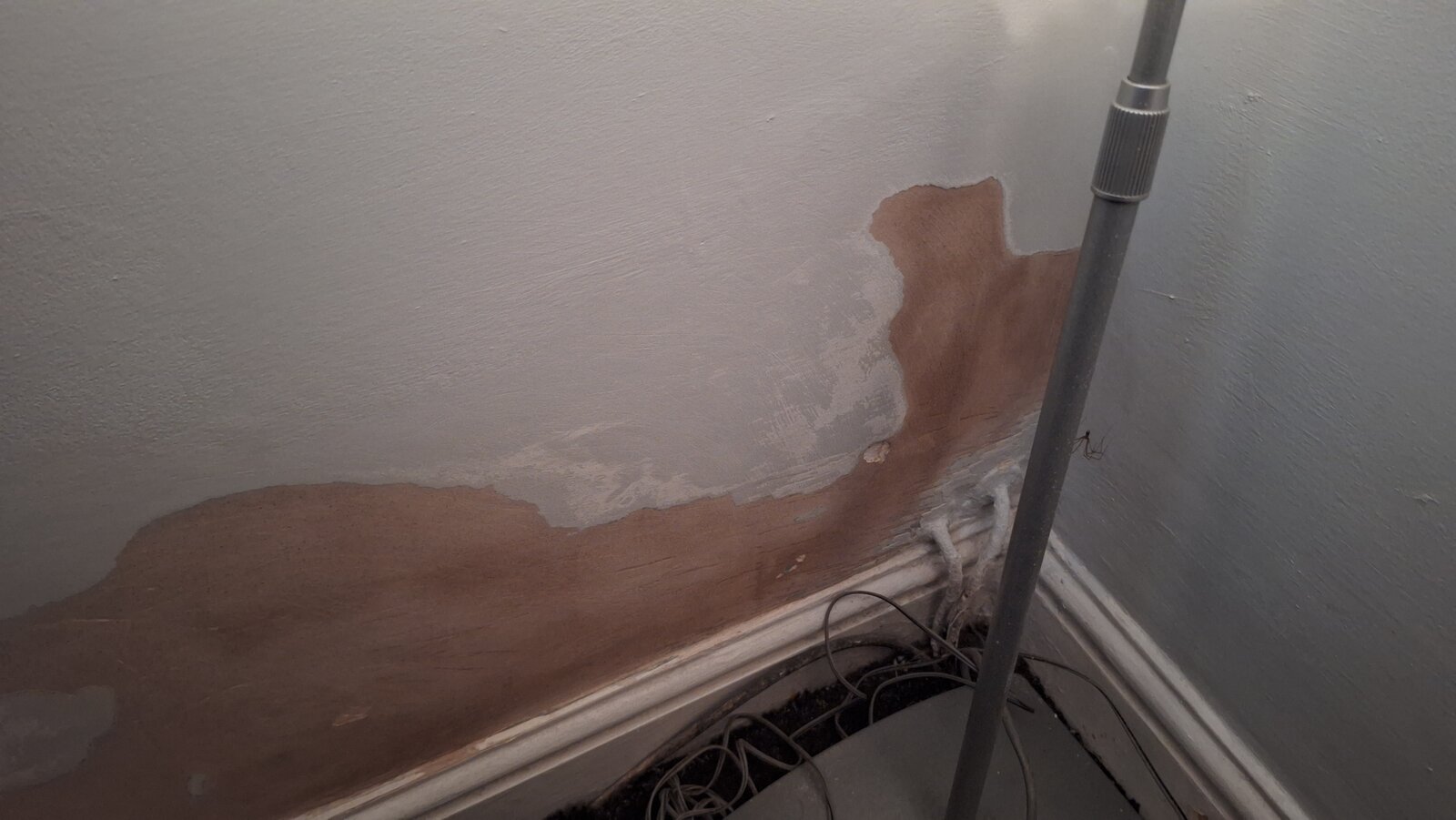

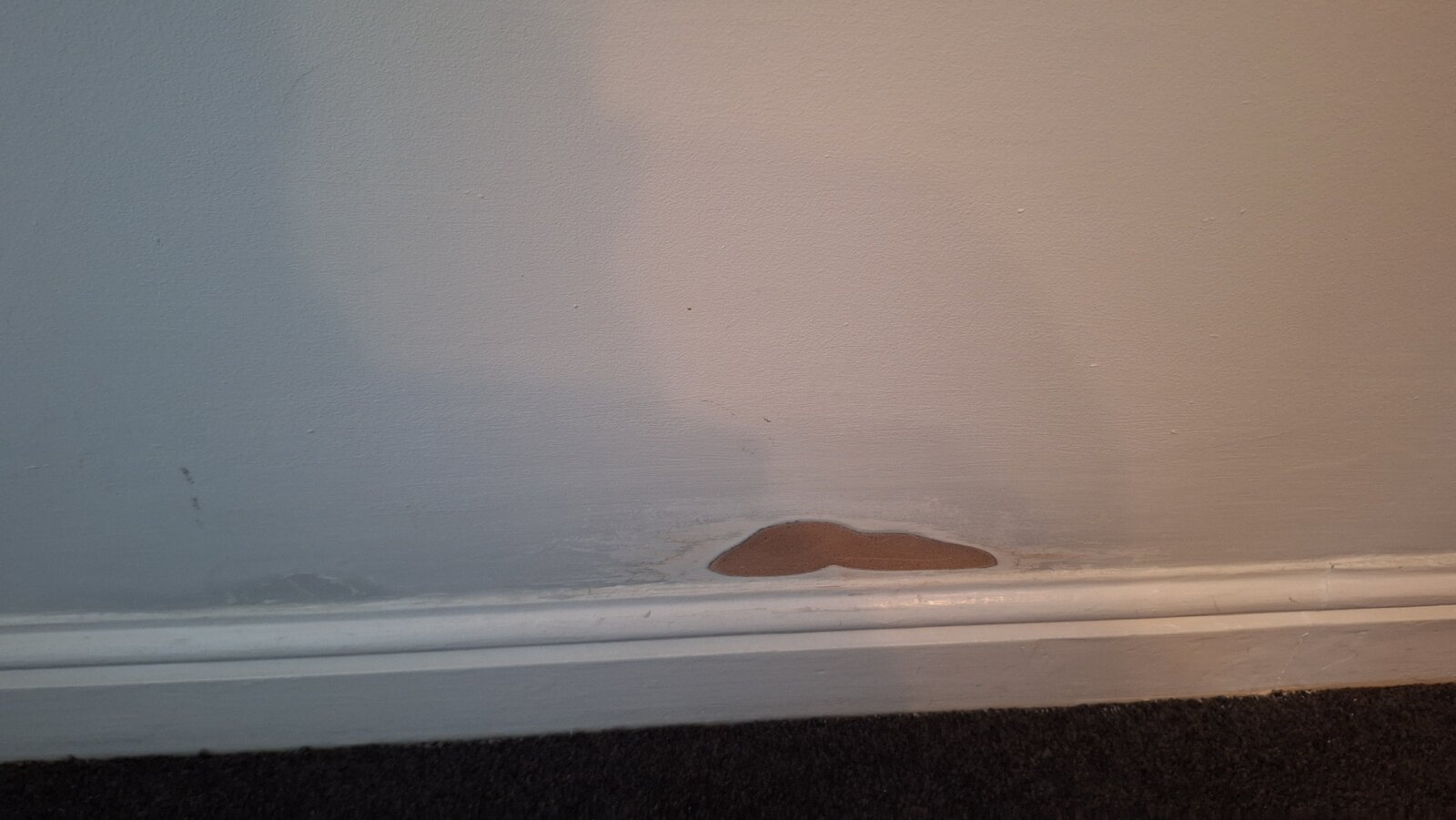

I have 2 small damp patches one under window above skirting board and one behind chair on the same wall. My house is quite humid and I have dried clothing on rads in past. I can get this even on a hot day. The house has cavity wall insulation which was fitted before I moved in.

Stand back and take a wide pic of the entire wall, side to side and floor to ceiling.
Also photos above, under and around the window, in case of gaps. Is it a bay window?

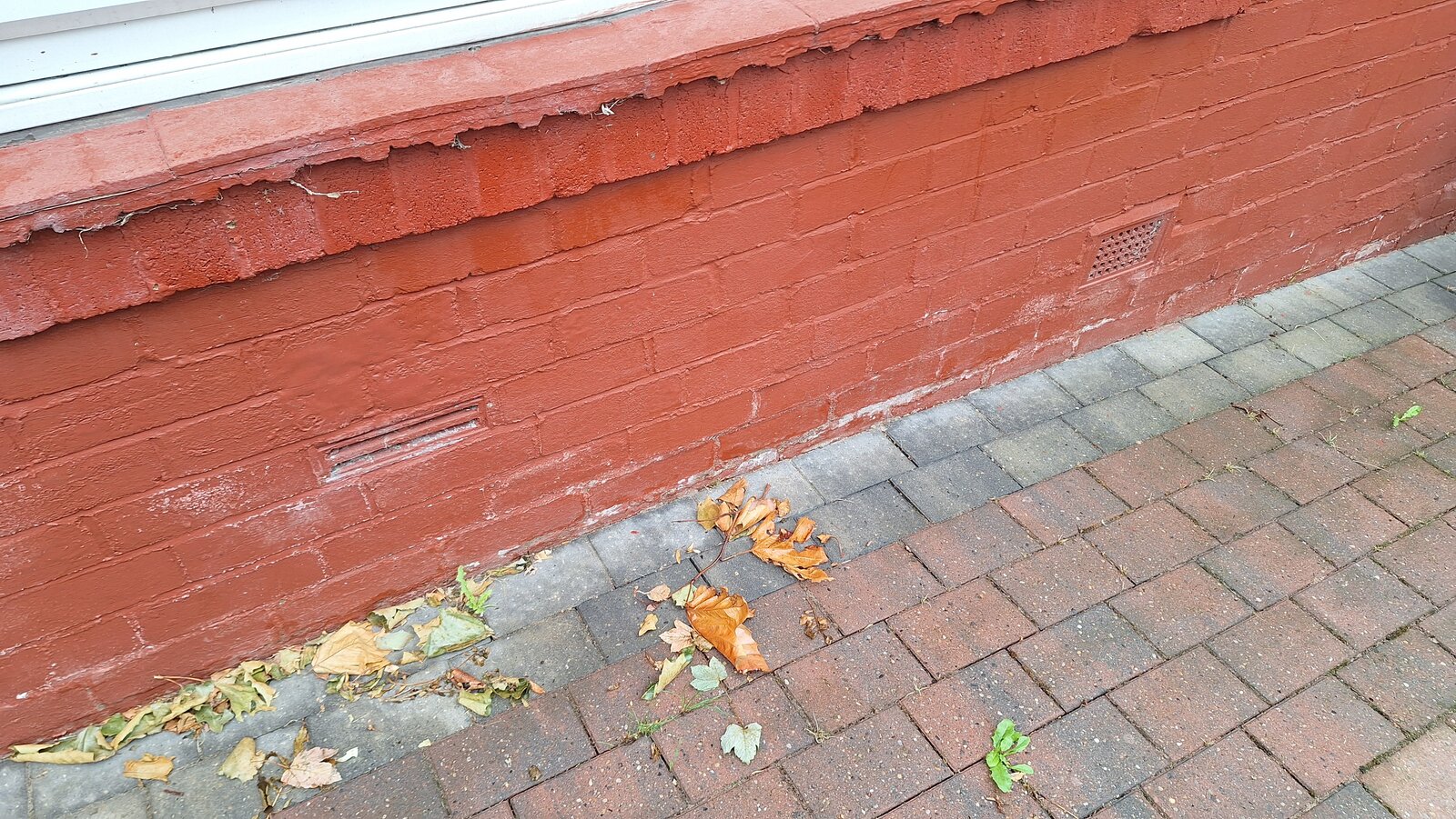

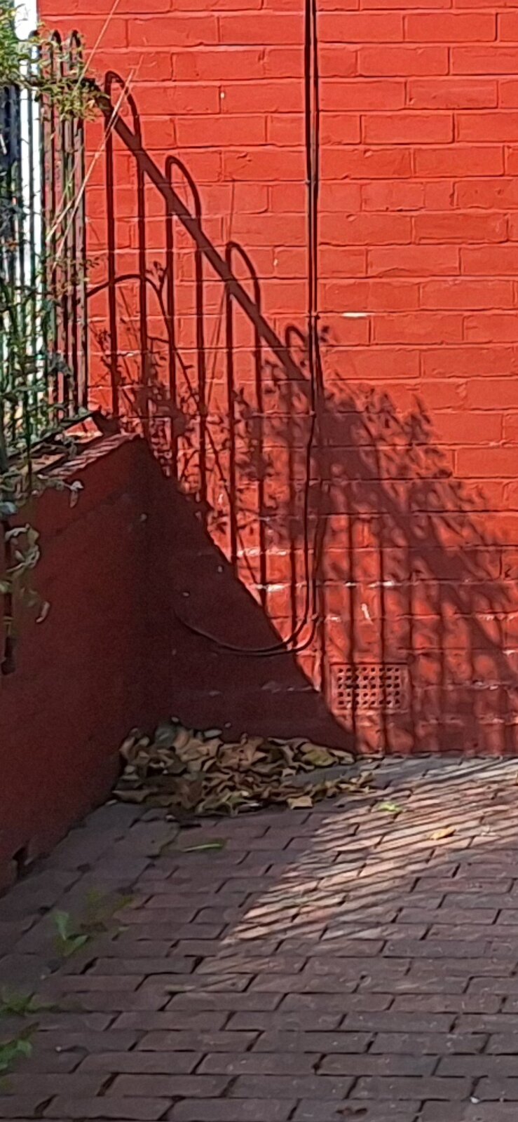

Please show us the foot of the wall, and the ground or paving against it, including any drains or downpipes and the airbrick
And the entire inside wall.
That's the airbrick, water hit the wall to the left. Nearest down pipe is on the right hand wall past the steps.I will take some more pics. The inside picture the cables is to the left of this air brick. There are also 2 other airs on this wall. You will be able to see them if you can zoom in on other pic.

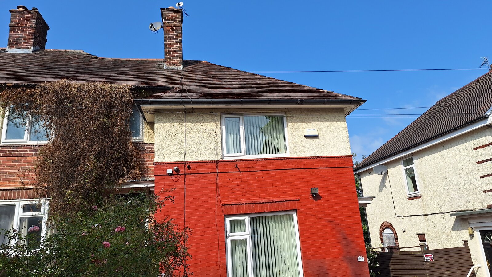

Further along drive
