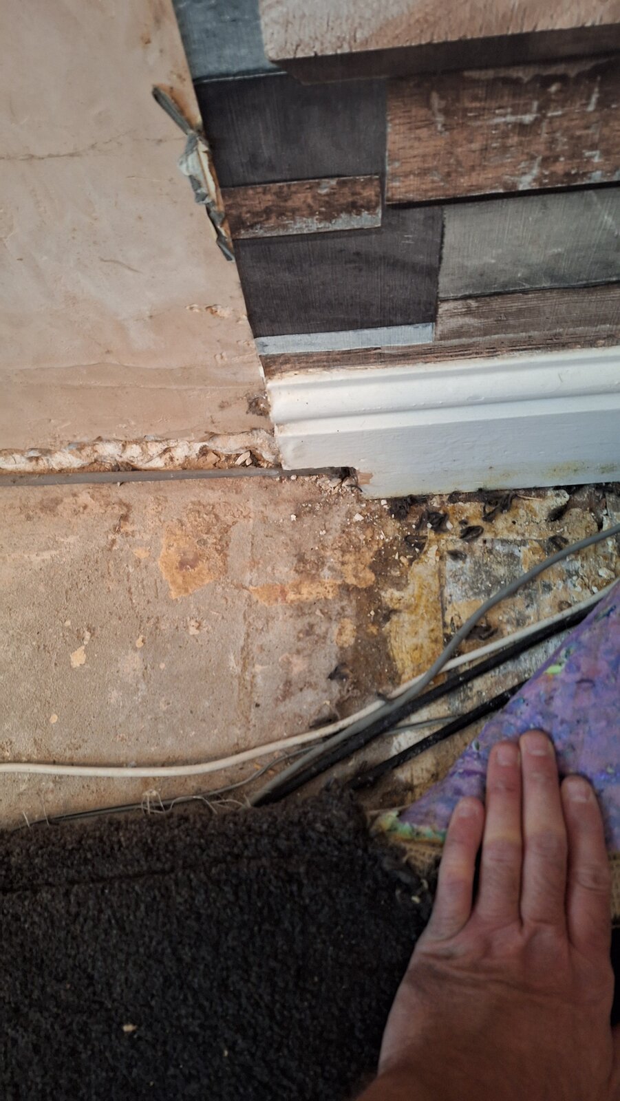

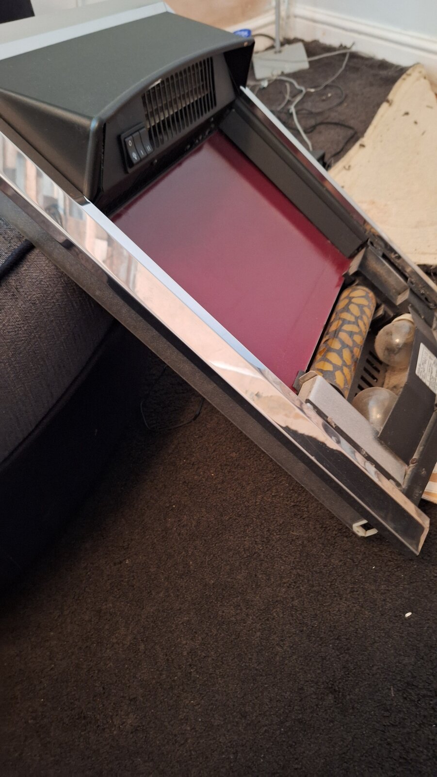

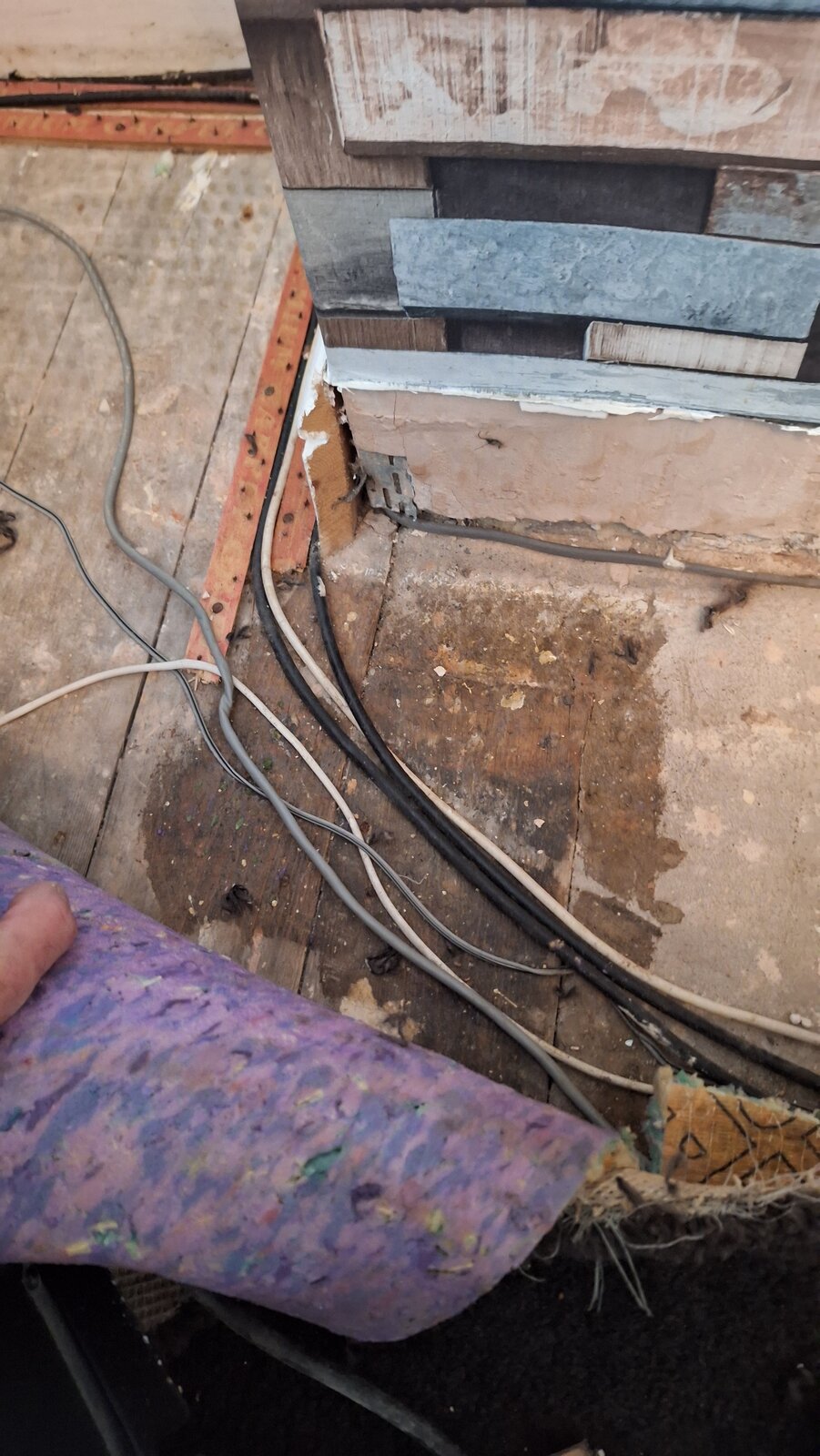

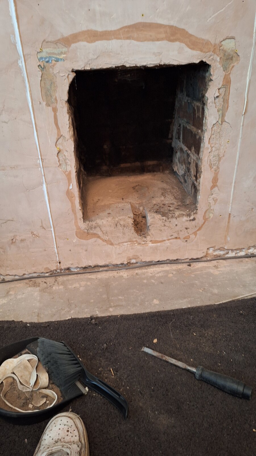

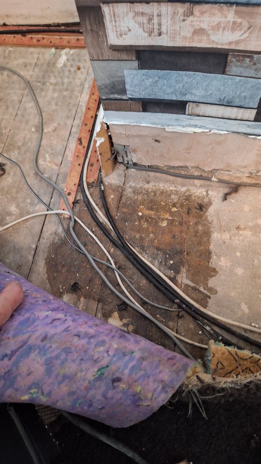

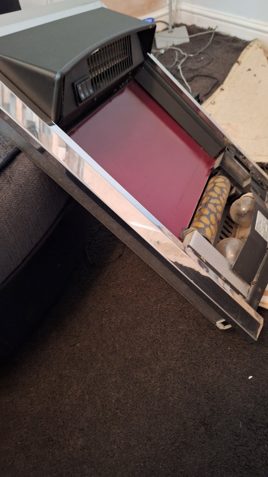

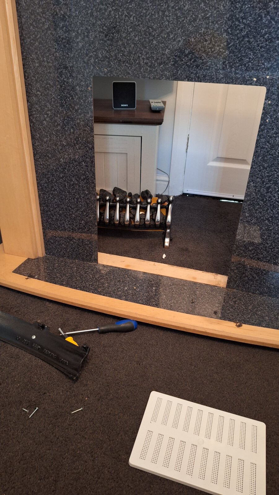

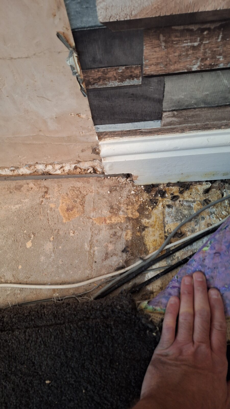

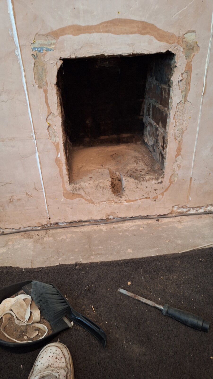

My chimney was completely boarded up no vent, could this be cause..2 damp parts either side of chimney. I have swept out middle it was damp at first.

Borded behind this fire place no air

OP,
1. Has the flue been swept?
2. Are there pots on the chimney stack - a pot will usually vent the top of the flue?
You need bottom & top venting in a redundant flue?
3. The damp patches could be caused by Hygroscopic chemicals moving out from the flue?
4, Or they could be as a result of rising damp?
5. Air bricks should be below the FFL or they are useless.
6. Hack off all damp looking areas of plaster back to brick - make good with sand & lime render.
7. Some of the moisture showing in the pics might be coming from the fender wall infill below the hearth?
8. FWIW: why not search some of my previous posts on damp issues & chimney flues?
It used to be old council gas fire. There is a cowl on roof as it blew off one winter and it's been put back. I've opened up a few vents in house which had been covered over and also vented the fireplace now.
