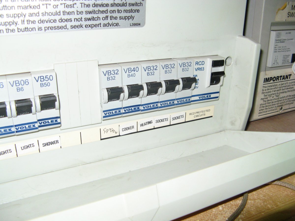

Hi,
I'm in the process of putting together plans to build an extension onto my house and i'm currently looking at the current electrical system thats installed. I'm no electrician and wont be doing the work myself i'm just trying to get a list of the work needing done together so I can get a price.
My main concern is that on the fuse box there are 2 circuit breakers for the sockets and 2 for the lights, meaning there are 2 circuits each for the lights and sockets, i've worked out the lights ok, one of the breakers controls the hallway and bedrooms and the other the rest of the house and have tested this by switching on lights and turning off the circuit breaker.
However on the sockets even though they have 2 x B32 breakers, you need to switch off both to cut the power, is this normal? or do I have to find out where these 2 circuits are joined and have it fixed.
I have attached a picture of the circuit breakers just incase it helps

No, that is not normal, and is potentially dangerous. You therefore need to have it investigated and sorted out.

This is what I suspected, it's been like this for the past 10 years since I bought the house, i've been under the house trying to work out what wire went to what socket and they all look like they are joined up correctly, I suspect the issue the wiring in the circuit box itself.
I would suspect the four wires, two for each ring, have been mixed up and one from each ring has been connected to each MCB.
Nothing to do with the socket wiring.

As above. The problem is almost always in the consumer unit. This usually happens if the circuits have been disturbed at some time (eg a replacment consumer unit) and little or no testing was done afterwards.
It would be 15 minutes work for someone who knows what they are doing to sort it out.
Add it to the jobs for the electrician to do when he does the extension. Or you could use it as a qualifying task for your chosen sparky. Give him/her the job if he/she can sort it in less than 30 minutes!
