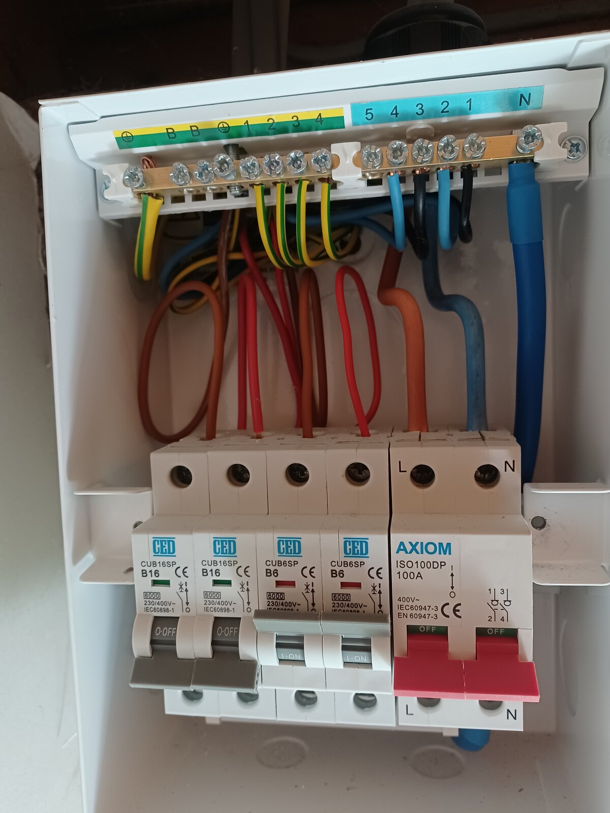

Hi all, I have a cu in a garage it has a 100ma mains switch with 2 16a breakers for 1 socket each on a radial and 2 6a breakers for lights and heating, so wat I wnt to no is I was going to 2 change 1 16a breaker 2 a ring circuit and have 2 fused spurs feeding 2 single sockets for a washing machine and tumble dryer would that be OK on a 16a breaker or will I changer it to a 32a breaker.
