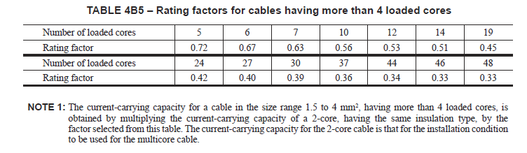

Although seemingly not referred to in text, Table 4B5 seems to address this issue, albeit only for between 5 and 48 (i.e. not including 4 !) "loaded cores". If I'm interpreting this correctly, with 5 "loaded" cores, the CCC would be 0.72 times that for a 2-core cable of the same type and installation method - so the CCC for the OP's 4 "loaded cores" would presumably be a little higher than that.
Kind Regards, John
I notice though that the table you posted only claims to apply to smaller cables, not to the OPs 10mm
Ah, I missed that. As I said, there seems nothing in the text which relates to that table, so there appears to be no guidance on the situation with >4mm² conductors.

As you say, very close (although I presume the equivalent of the Table 4B5 figure would be a bit lower than 0.72 for 4 'loaded cores').
As a matter of interest (if you have the time) how would figures obtained from an extension of your approach compare with the Table 4B5 ones for CSAs ≤4mm² and increasing numbers of "loaded cores"?
