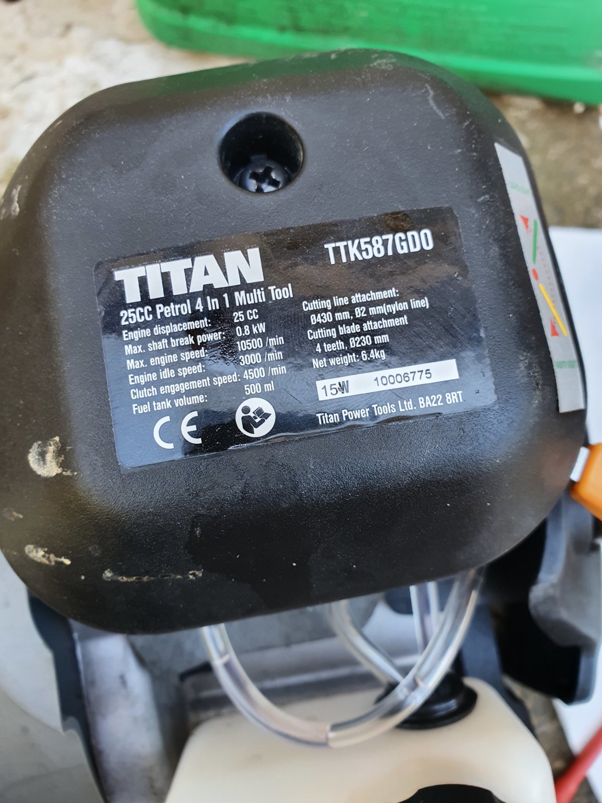

Hey all, have a titan 2 stroke multi tool hedge/chain saw/brush cutter tool from screwfix a few years ago.
Lines and purge bulbe were worn away and leaking so replaced them.
On using the bulb the fuel runs through the carb fine, starts no problem, and will idle away no issue.
On throttling it it revs up and dies. Will keep doing same every time. Use the bulbs to.move some fuel through it, and it will rev up fine for 15 sec or so then die again.
Have checked and ran with air and fuel filter removed same issue. New fuel, mix checked, lines purged all good, but problem remains.
Which I guess only leaves an issue with the carb? It's like it's not drawing fuel up through the line fast enough on full throttle.
How does a 2 stroke draw fuel in? Anything else I should try before giving up?

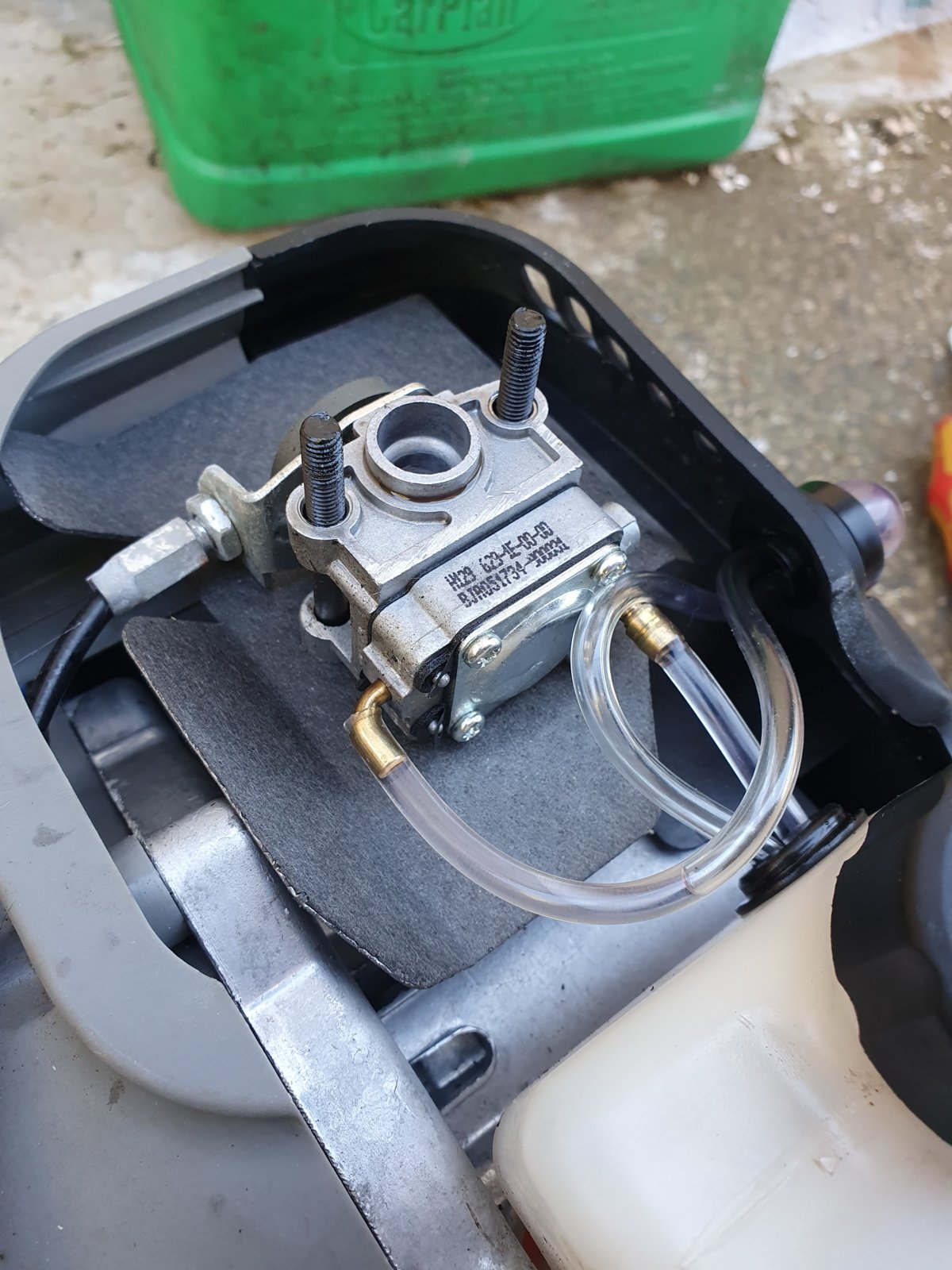

I’d say you have a partial blockage in either the main jet or float chamber needle valve. Sometimes they have a very tiny gauze filter on the fuel inlet.

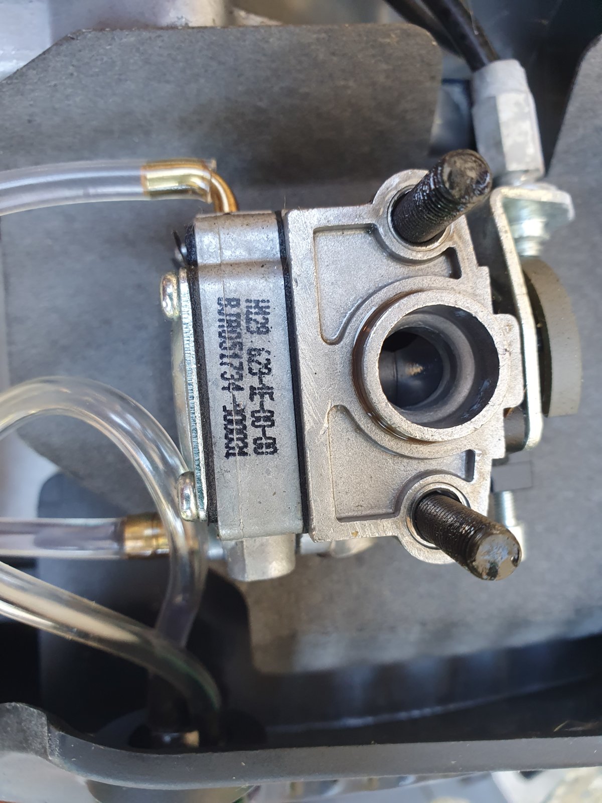

It's that something you normally can get to without disturbing the gaskets usually? Got a few pics of the carb I'll put up later
It looks very much like a Walbro WYK 186 carb.
Anyway, it will have to come apart for a clean. See the two black lines? They consist of a gasket and diaphragm and when you undo the 4 screws on the bottom to split the carb they may, or may not split :eek:
Can I direct you to GHS Ltd, and look under the carburettor section......there in the chinese carb section should be either a new carb (part number 7257) or a replacement gasket/diaphragm set.
You’ll also need an aerosol can of carb cleaner to flush it through.
