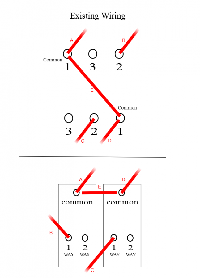

Hi everyone.

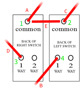

I am changing a switch to a bathroom where one switch controls extractor (left switch) and right switch controls a light. I have wired up and am getting nothing from left switch and if right switch is used both lights and extractor fan are on....
I have labeled wires using A, B, C etc and connections numbered in green. Could anyone let me know what wires go where to get the switch working right?
Many thanks.
Richard
