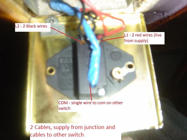

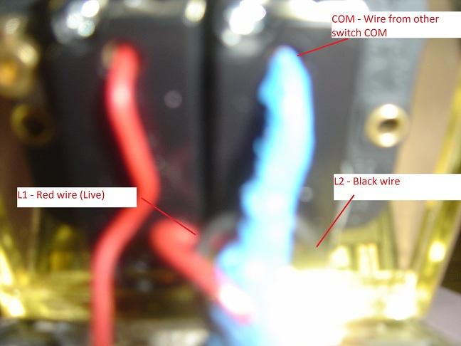

Photo's as requested

As has been said, it looks as if you need a third electrician, and one who has some idea of what he is doing. I presume that the switches have never worked as you would like (at least, not since any changes were made to the wiring). As far as I can make out from the photos, that wiring could never have worked as you would like, since it is not wired as proper '2-way switching' (i.e. two switches controlling the same light{s}).

Difficult to see clearly, but wiring appears to be correct.
Switch wires to L1 and L2.
Additional wires from COM, L1 and L2 in one switch connected to the same terminals in the other switch.
However:
That blue tape covered COM wire requires further investigation - why is it covered in tape, and what is underneath the tape? Is this a completely separate wire, or part of another cable?

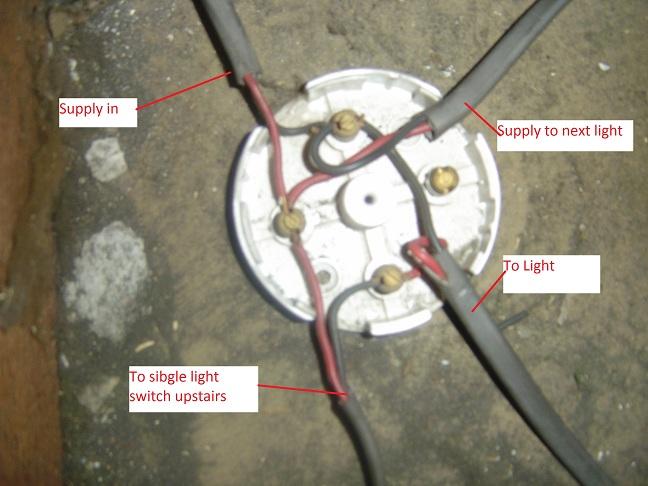

The junction box and the cables joined in it has no earth connection at all.
The metal light switches are not connected to earth either - THIS IS DANGEROUS

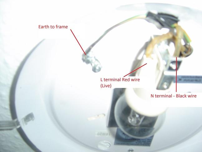

The light appears to have an earth wire connected - but what is the other end connected to - presumably nothing?
Difficult to see clearly, but wiring appears to be correct. Switch wires to L1 and L2. Additional wires from COM, L1 and L2 in one switch connected to the same terminals in the other switch.
On reflection, I think you're right - I misinterpreted the second of the pics. :oops:
However: That blue tape covered COM wire requires further investigation - why is it covered in tape, and what is underneath the tape? Is this a completely separate wire, or part of another cable?
I'm sure it's in your mind, but you have not actually mentioned what is possibly the most likely (and 'orrible/dangerous) explanation - namely that T+E has been used to join the switches and that there is a bare conductor (what should be the CPC/earth) under that blue tape! However, if that's the case, it's rather amazing that two 'electricians' have apparently 'passed' it!
The junction box and the cables joined in it has no earth connection at all. The metal light switches are not connected to earth either - THIS IS DANGEROUS ... The light appears to have an earth wire connected - but what is the other end connected to - presumably nothing?
All agreed.

The wire covered in tape is brown, the electrician put the tape on it. I have checked the continuity of the cables from the second switch to the first, with a multimeter, and they are all ok. The photo's do not show it but the switches are earthed. I don't know where the earth wire from the light fitting goes to.
