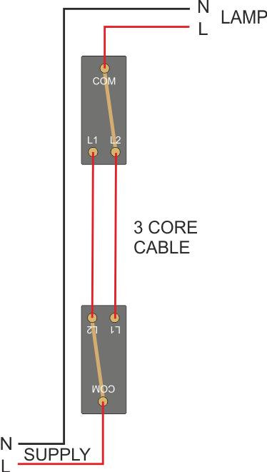

I feel a bit silly for asking, but I can't figure it out.
I have a situation with 2 way switching, 3C+E between the 2 switch points.
Is it possible to connect a lamp fitting directly to each switch and have the system work? Can the COM strapper be used as a neutral? I think it can, but would like to clarify!

I presume you've got a live and neutral feed at one of the switches?
You cannot use a strapper as a neutral.
What do you think would happen when you switched the power back on?
It would be possible to do what you want only if a neutral was available at the switches - or at the light position but then you would not be wanting to do it.
I rushed back to my laptop to change the bit about using the strapper as neutral as I quickly realised it was stupid, but too slow!
Yes one of the switches has a L+N feed.
No you can only supply the light from one switch or the other, but not one from each if you just have a 3 core between the two switches.

Can you explain how the setup in a hallway works (Mine included).
The power is supplied by the downstairs switch, but the lamps are connected via the upstairs switch. There is just a 3C+E between them, no borrowed neutrals.

Are you sure?
You say there is a neutral at one switch.
Is this downstairs?
Are you sure one of the 3-core isn't already used as a neutral?
Where do you want to connect the new second light?
In your case you have the supply at one switch
and light at the other switch.
2 strapper wires
and 1 neutral
When you have the supply and light at the same switch, you need all 3 wires as lives
Yes definitely no borrowed neutrals
The neutral is downstairs
1 of the 3 cores could be neutral, I think this is where I get lost on this one
2 strapper wires
and 1 neutral
Can you explain that setup? This is what I can't understand, and it's a little frustrating!
Thanks Flameport, thats exactly what I needed to see!
