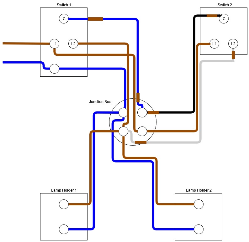

Evening everyone. This is my first post so apologies for any errors.
I currently have a single switch controlling a single lightbulb in my garage. It's a bit dark so I'd like to replace it with two battens. While I'm at it I'd like to put a second switch by the other door (so I'm not staggering around in the dark if use the other door!).
I followed some diagrams on this site and on other websites but it's a little more complex as the power feed is into the switch (rather than the ceiling rose). I've attached a diagram of what I plan to do. Can anyone confirm if I've got the circuit right and the colours?
Thanks in advance

You can do that, however the junction box is not required, just make the connections at the first switch.
Part P doesn't prohibit anyone from doing electrical work.
Consider led as an alternative to fluorescent
If you have a workbench, one above that, rather than central in the ceiling
Good spot. Thanks.

Yeah, they're led battens. It's a double garage and it currently has a single 60W (or led equivalent) bulb in the middle so pretty dim. I'm putting a 2700lm batten on each side and another above my workbench (I do small electronics as a hobby so lots of light needed).

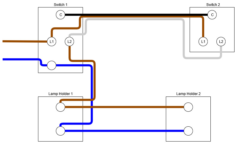

Another option is run a Twin +E cable from the old lighting point to the new lighting point and
a Three core +E cable from the existing switch to the new switch
Good drawing by the way.

You see. This is why I posted on here. My circuit is so much simpler now and everything on the left of the diagram is already installed. I can get this thing sorted tomorrow if I'm lucky.
Thanks very much for everyone's help. (y)(y)(y)
