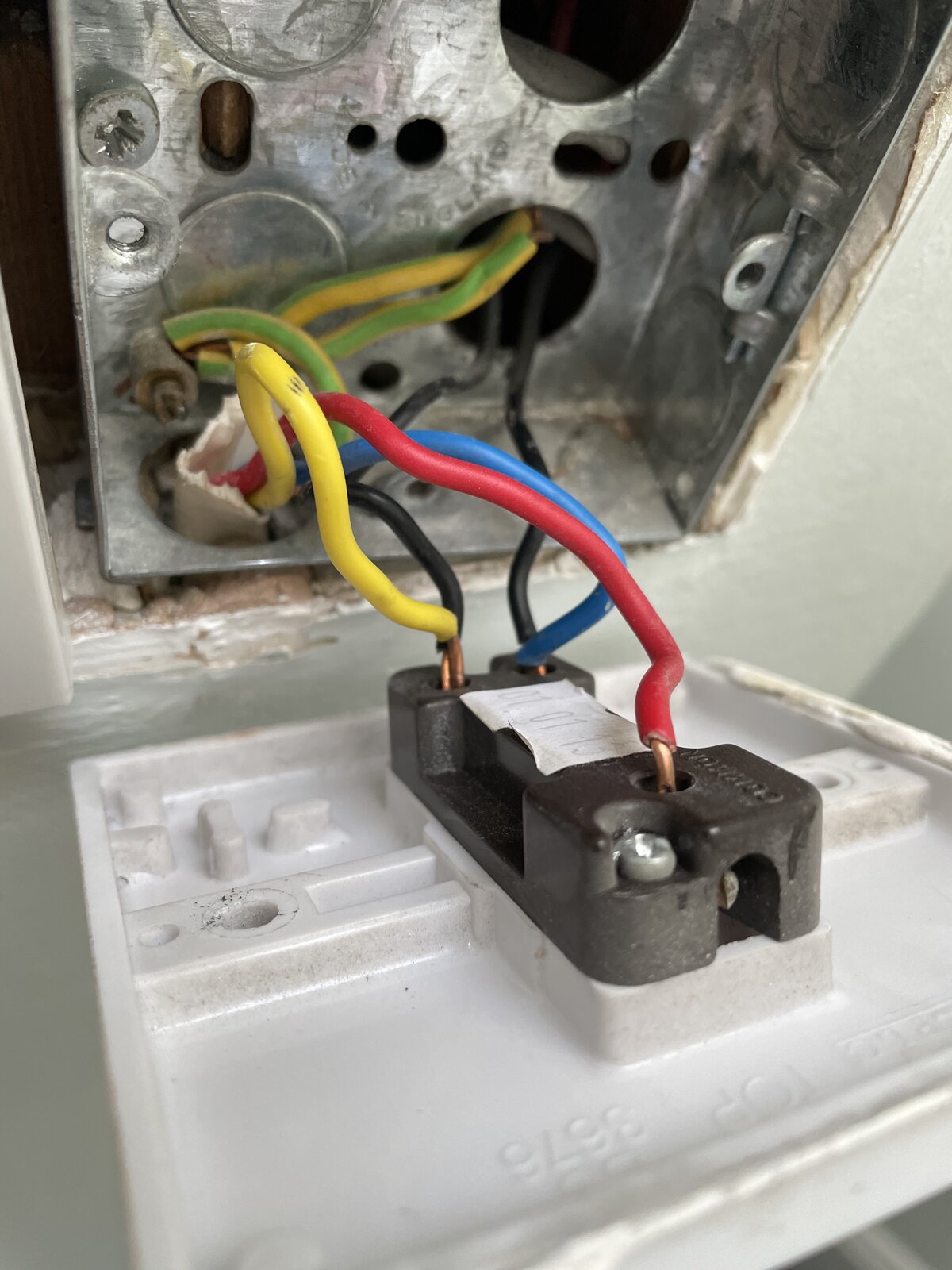

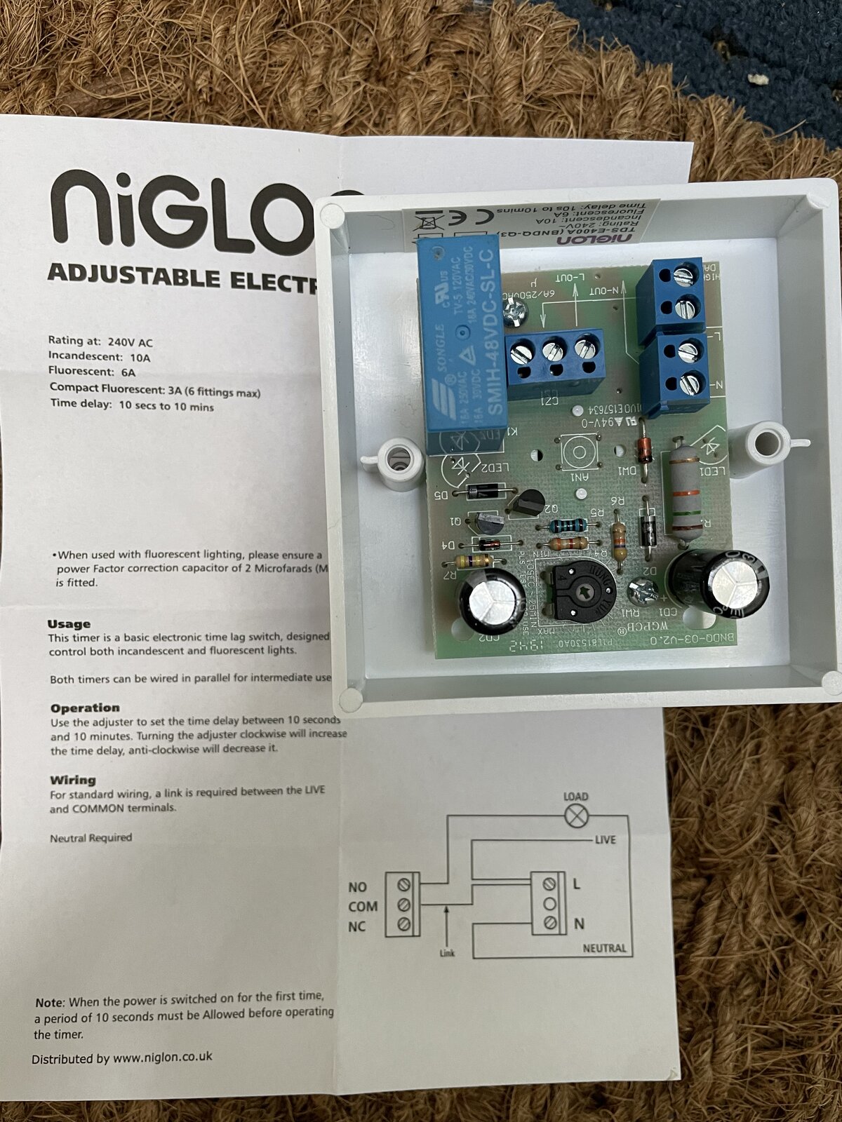

Hi, I'm looking to replace a 2-way light switch for a 2-way delay light switch. I have replaced one already for a pneumatic time delay switch, but the second switch I bought has different wiring which I'm unsure about. Can anyone advise on how to rewire it correctly?
You can't (easily). You need a neutral which you don't have available.
It may look ok but it will not work as 2 way unless you reconfigure the wiring
