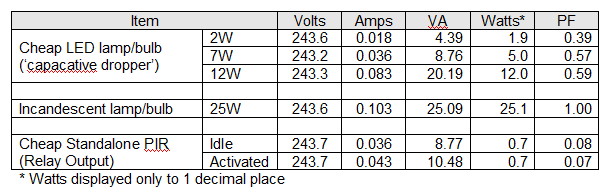

I used a very cheap energy monitor (whose only real 'failing', for this purpose, is that is displays power only to one decimal place of Watts). As ca n be seen in the tabulation below, the results I got with various cheap ('capacitive dropper') LED lamps/bulbs and an incandescent lamp/bulb indicate that it is giving reasonable results - with a PF of 1.00 for the incandescent, and roughly 0.4 - 0.6 with the LEDs, lower for the lowest power of the LEDs.

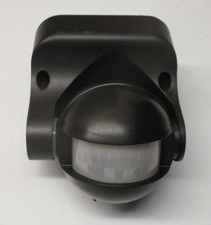

I then tried with a cheap standalone PIR which I had on my shelf (a spare, since I have several of these in service - see picture of the type below), which has a relay output and claimed power consumption of 'approximately 0.5W'), and got results even more dramatic than I expected, with a PF less than 0.1, and with both PF and power consumption much the dame with the sensor in its 'idle' and 'activated' states.
So, the bottom line is that the (true) power consumption of these PIRs is trivial/negligible - in the case of my one, something like 6.1 kWh per year for continuous 24/7 (about £1/year at 16p/kWh). That type cost around £8-£10 and, at least in my experience, usually last for at least 5 years (often a lot longer) - so the total cost of having one (initial outlay + running costs) probably amounts to £2 - £3 per year.

If one does the sums, it's reasonable enough - so perhaps the more surprising thing is that the PFs with (capacitive dropper) LED lamps/bulbs are as high as they appear to be.
Kind Regards, John
I suspect the difference is the LED bulbs are dropping most of the voltage across the LED arrays and only a relatively small amount in the capacitive dropper while the PIR is dropping down to the relay coil voltage (say 24V or so) using the capacitive dropper.
If that were true, it would obviously explain the difference, but I didn't think that there were all that many LED elements.
Do the 'chips' in these bulbs perhaps each contain multiple LED elements (I had assumed that it was just one element per chip)? The 7W one I tested had only 10 'chips' (and the 12W one had 22 'chips').
