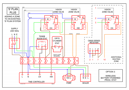

Evening all just after a bit of advice on a 2 zone heating system
Basically I've wired it as an S plan with the switch live (Orange from the valve) coming back to the boiler
in the boiler I have a LNE connection and 2 terminals for the thermostat (I've removed the jumper lead)
I understand the Boiler will need a permanent live neutral and cpc to enable hot water in demand so main question is does my switch live from the zone valve come back to the stat connection within the boiler ??

Then you have to replace the link in the boiler and
have both orange wires (from the valves) to the boiler on terminal.
Ok so the L on the pump is the switch live on a system boiler and one side of the stat on a combo boiler ??
Take the grey wires from the 2 ports into one side of what you refer to as the jumper lead. Connect the orange wires from the two ports into the other connection on the jumper lead (link wire).
You'll need to power the valve motors (brown wires) through prog/stat switches.

Many combi boilers do not have 240V thermostat connections. Shoving 240V in one or both of the terminals could cause very expensive damage.
