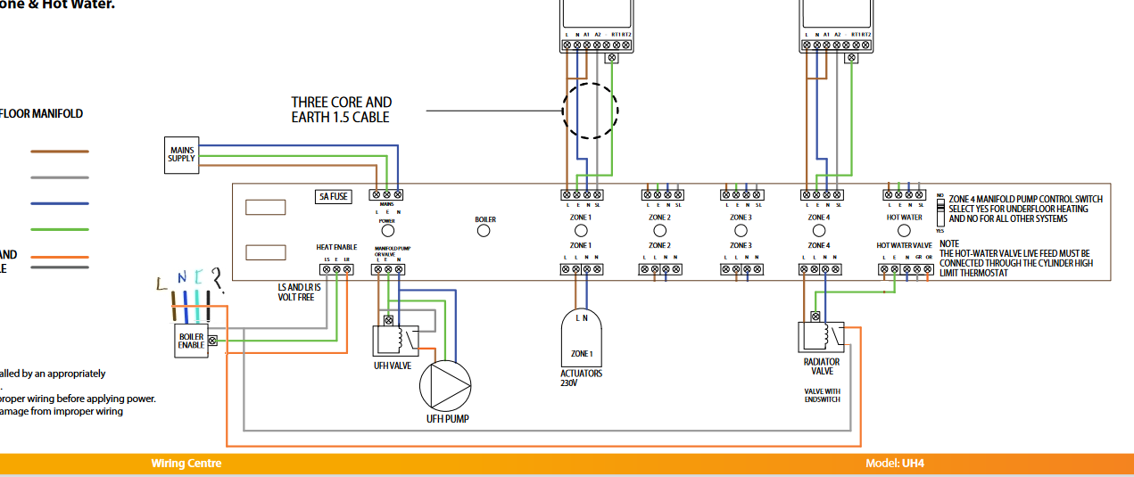

Lol..I bought this expensive unit for it to work but guess was wrong. I tried that way but the boiler doesn't react, the valve opens and the pump starts but the boiler doesn't kick in. No clear instructions hence posted here. Any cheap wiring centre recommendations .

You wired it like this
and the boiler didn't fire? To be clear I show the orange connected to the same live as the boiler (swapping orange and grey of the valves will not matter)
Rather than chucking wires in here and there you need to be a bit more analytical. What connections does your boiler have? Just live, neutral, earth or is there a 'call for heat' connection as well? Schematic please.

Yes it is a mess and it looks like the pump is not controlled by the UFH valve as shown in sketch.

Looks as if there's a couple of relays on there, I'm wondering whether they are there to buffer the actuator feeds for zones 1-3, would explain why that boiler enable is volt free

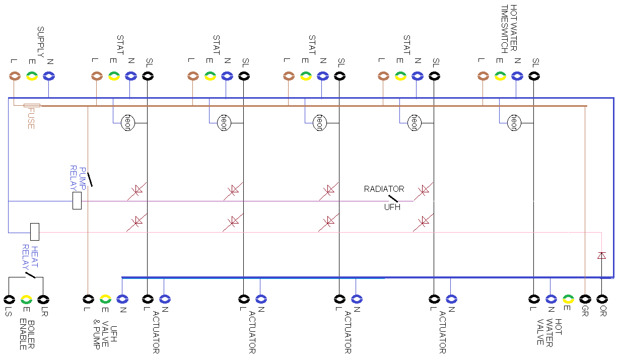

Yes they are for the UFH pump and the boiler and operated via diodes from the SL of actuators etc, best I've been able to work out is this but I have no confidence it's accurate, especially the DHW valve contact terminals.

As a curiosity while 'watching TV' last night I spent several hours working out the cuircuit diagram of the UH4. I'm not saying what I have produced is totally accurate but it's posted in #22 above. This is something I have spent my time on basically for you.

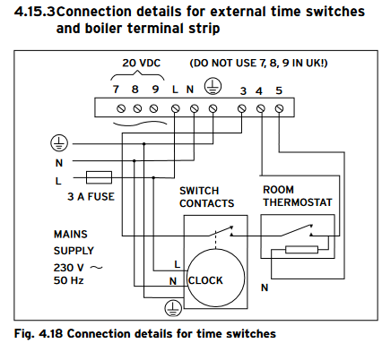

As for the boiler, it is a valiant ecotech pro 28 h and has 5 wires. L, E, N and black and grey. Not sure what the black is for but has always been connected to the Live wire. The Grey is the call for heating. Yes, I do have a new multimeter( don't know how it works yet ), and a line tester. That's what i have be using to check the line flow. I do agree that the pump may run dead head if the valve doesn't open. But currently the valve opens and the pump starts the same time as they are both connect at the same place as per the diagram. The difference is that the pump live is at the same place as valve live and orange wire is connected to boiler call for heating wire rather than the pump live. Only missing part to the puzzle is the pump doesn't have a delay start as you recommended.
So now we know the boiler we can see from page 29 of the manual (very easy to find with Google) how the boiler is supposed to be wired to terminals 3 and 4.
I imagine you can remove the cover to find this to see what your 5 core cable is connected to. A picture would be good.
